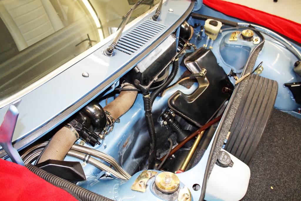

The photos below were taken soon after Ed had bought the car, which will give an idea of what it will look like once it is back on the road.
(IMG:http://www.914world.com/bbs2/uploads_offsite/i188.photobucket.com-22140-1529202755.13.jpg)
(IMG:http://www.914world.com/bbs2/uploads_offsite/i188.photobucket.com-22140-1529202755.14.jpg)

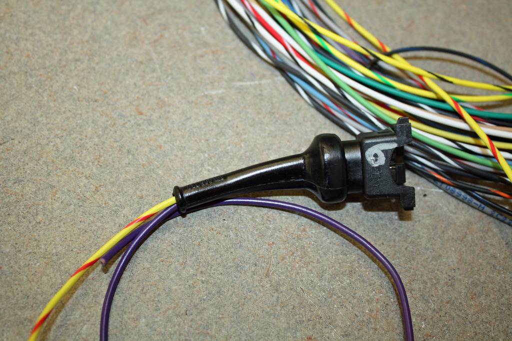

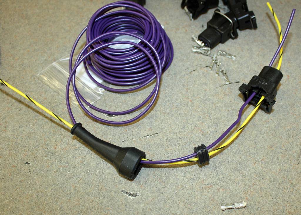

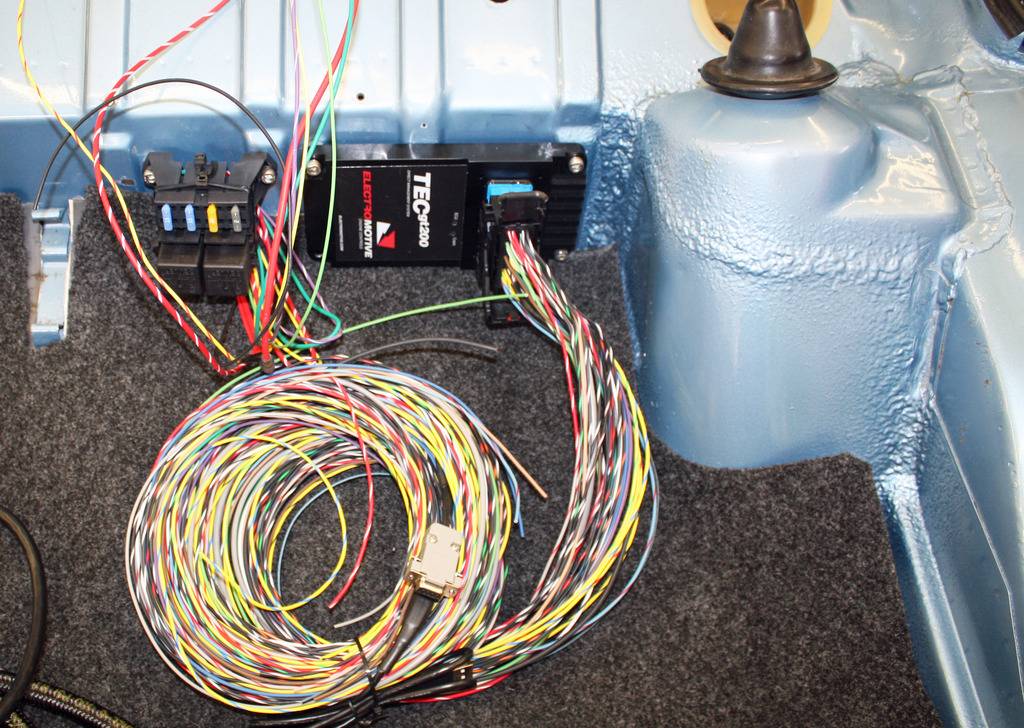

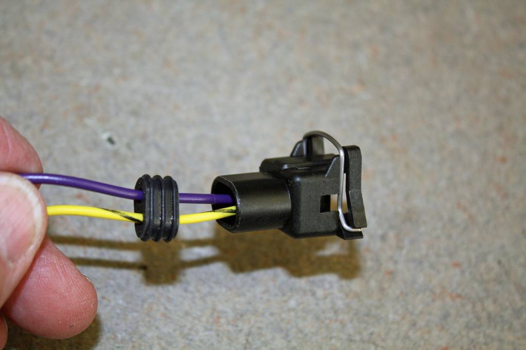

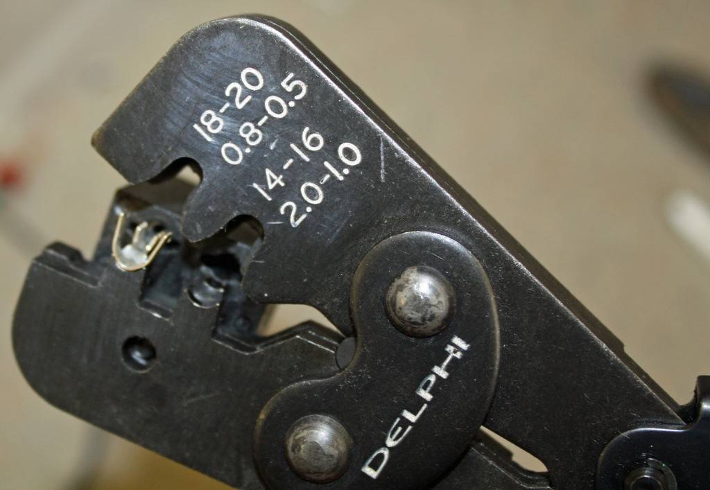

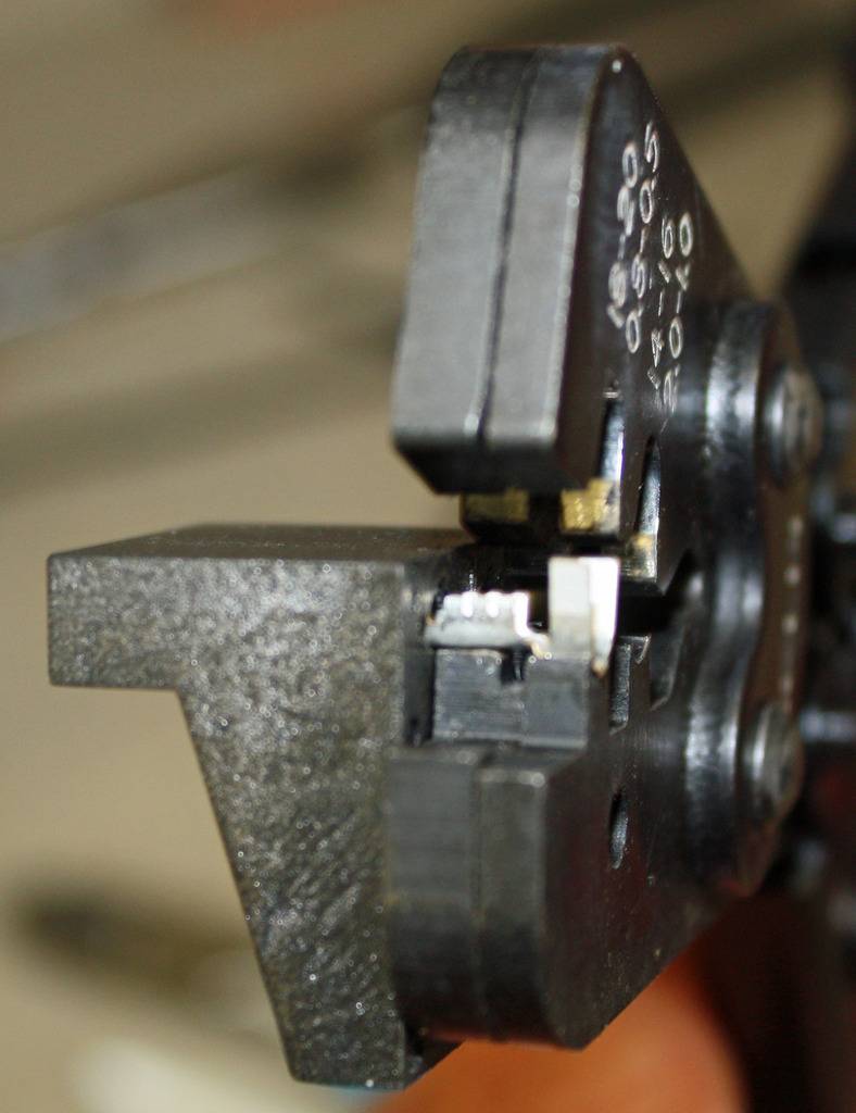

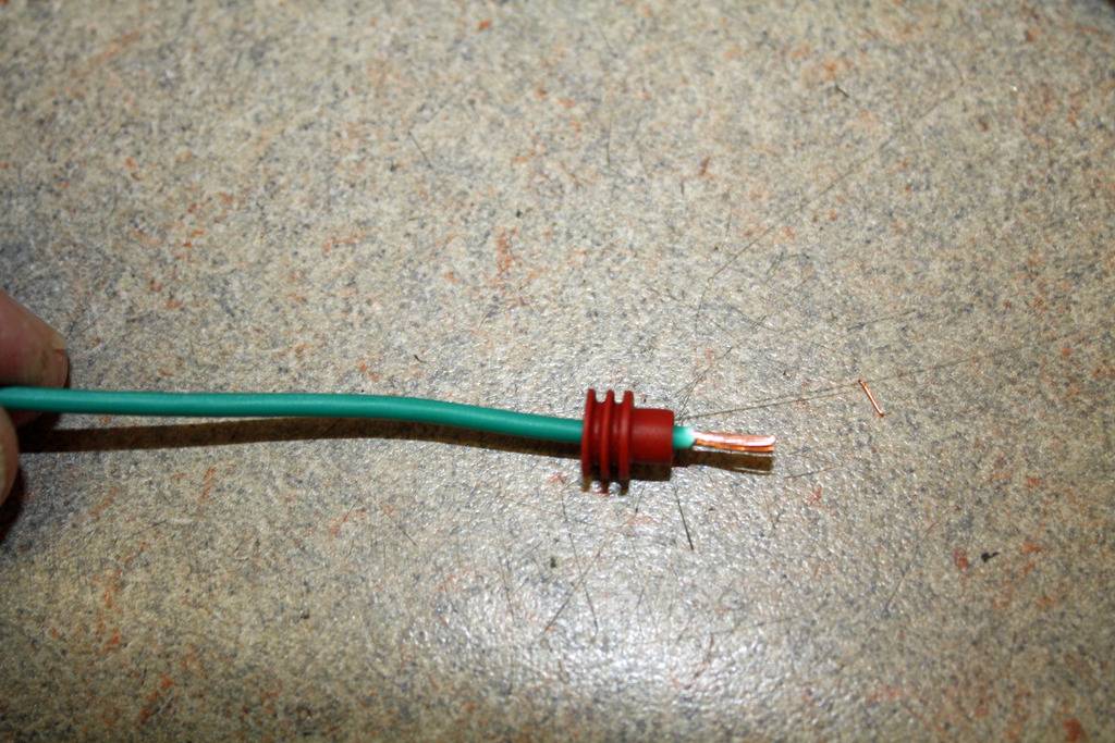

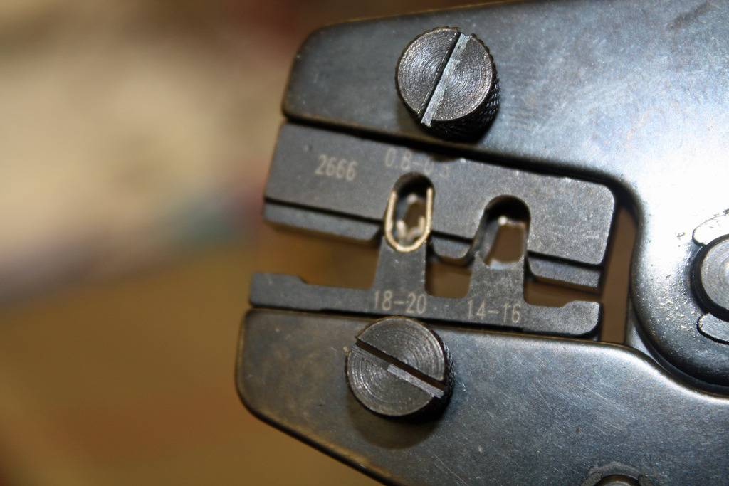

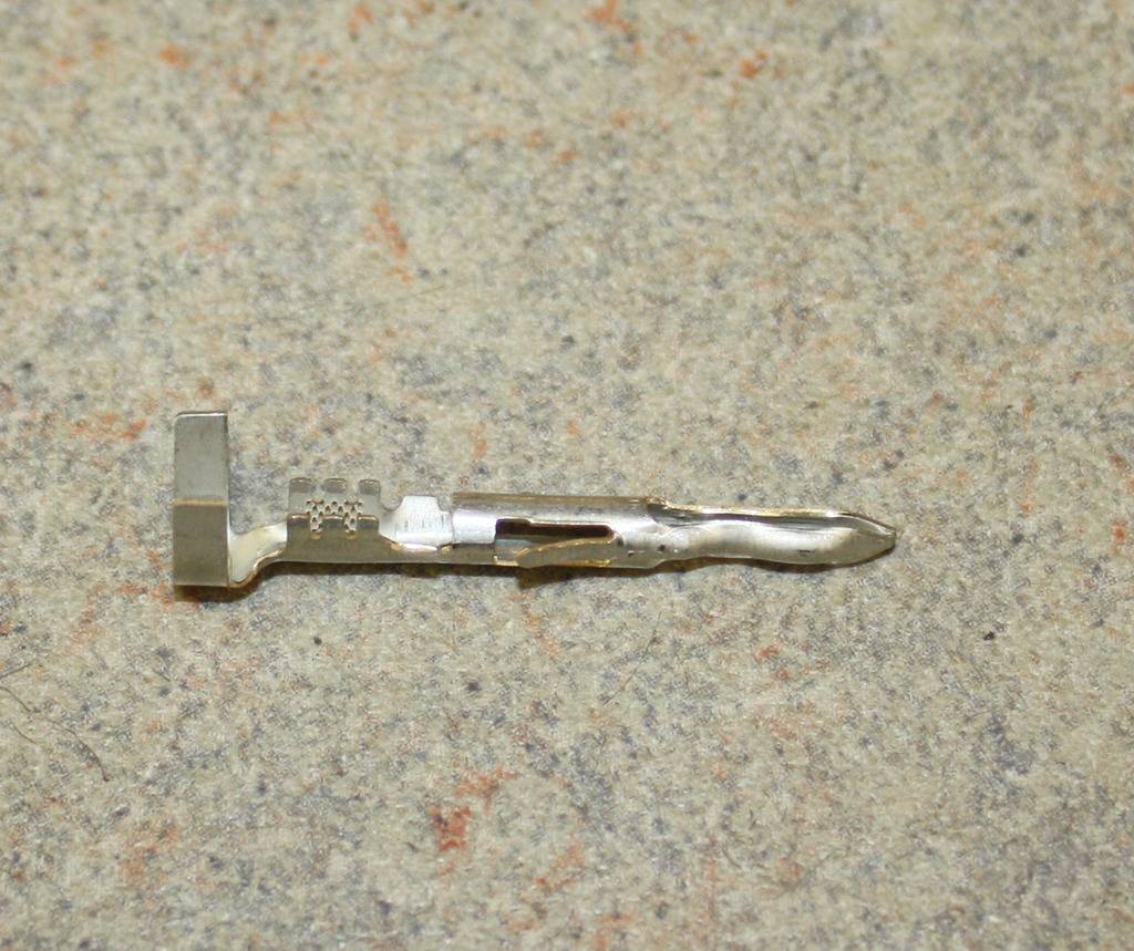

After being busy with other things the past few days, I got back to working on the car today. After installing the new wheels, the wheel studs for the rear were the right size but the front ones were too short. I did some measuring and ordered ten 56mm studs for the front wheels.

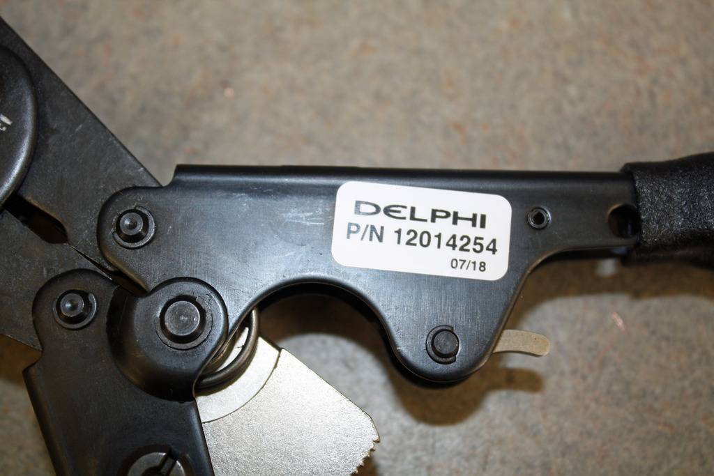

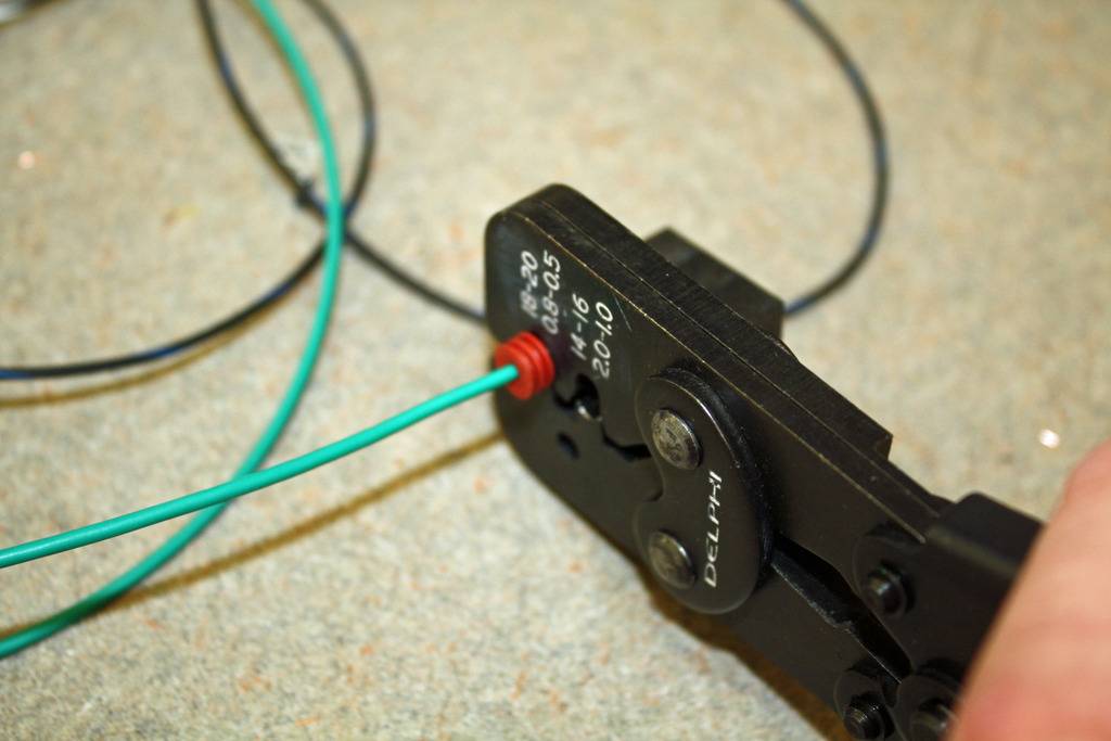

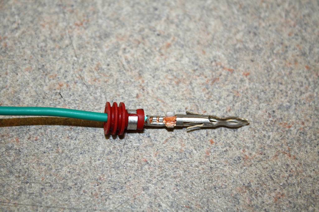

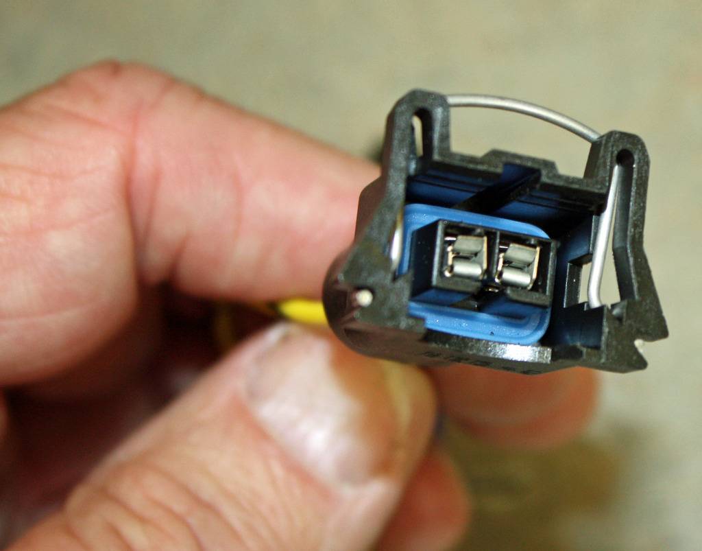

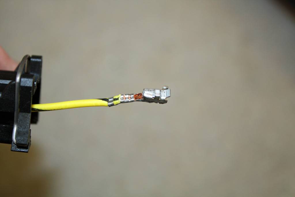

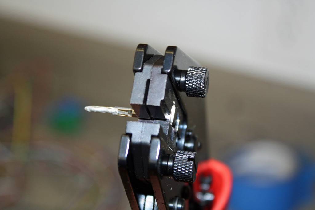

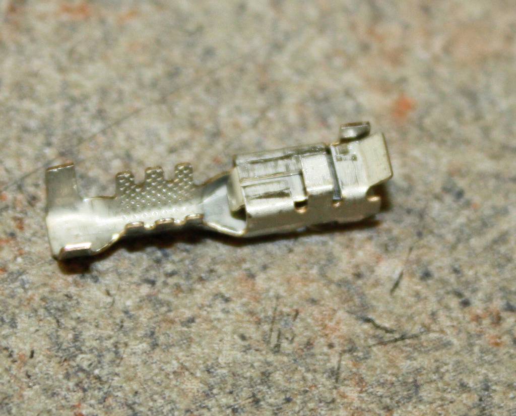

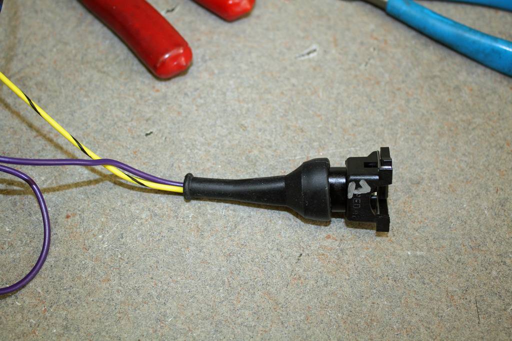

This afternoon I began wiring the harness for the fuel injectors. I have done quite a bit of wiring in my past but this is the first time I have worked with weatherpack connectors. So there is a learning curve. The fuel injector plug uses a GT-150 female terminal. The seal is built into the plug so it does not use a seal on the wire. Richard Clewett says he uses the weatherpack crimper with all of the connectors in his kit. After some trial and error, I figured out how that crimper worked with these terminals. But not until I had already used up the extra three terminals, and then some, that Richard had sent. I have more on the way.
There are pull through terminals which means the wire has to be run through the plug, the terminal crimped and then then the wire is pulled back to lock the terminal in place. With the terminals in place, i can re-insert the seal into the plug. At Automobile Atlanta, I found these fuel injector boots. They may not be necessary but add an OEM touch to the wiring.

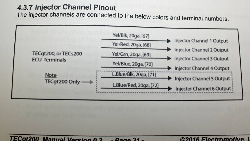

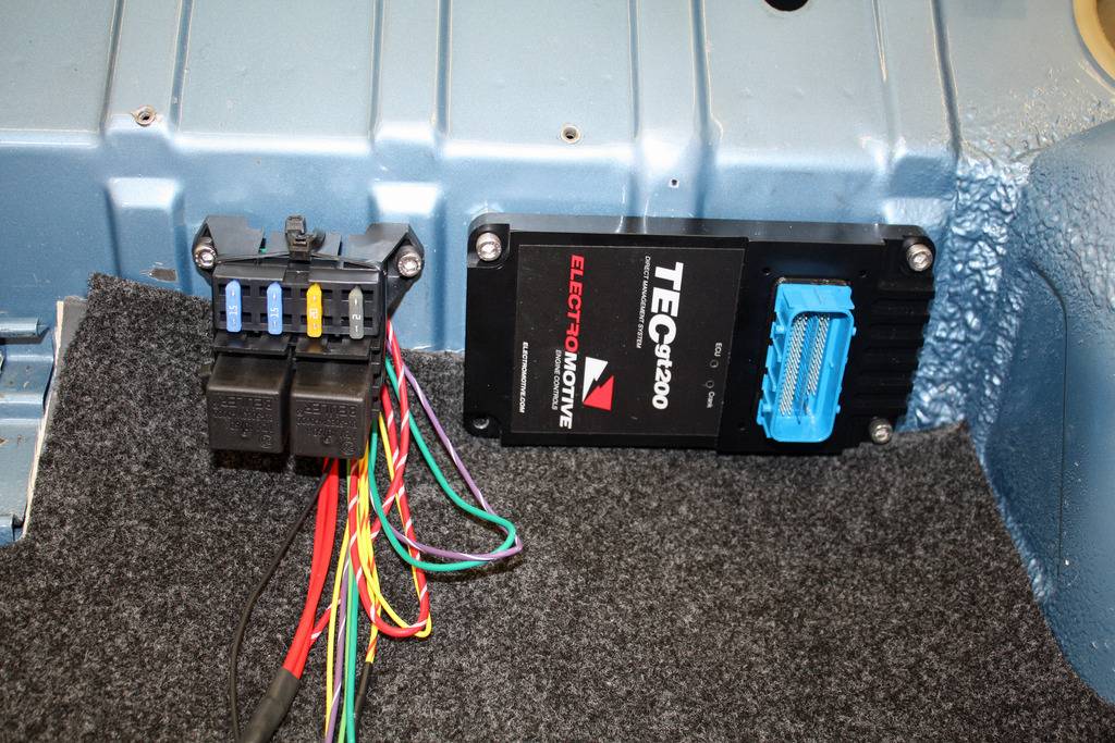

The TEC GT-200 ECU is capable of running a number of different types of fuel injection. Richard's kit is set up for sequential fuel injection which explains the need for the cam sensor. There are six output channels from the ECU. Channel one goes to the first cylinder in the firing order, which on a 911 engine is cylinder one. Channel two goes to the next cylinder that fires, cylinder six in a 911 engine. It is critical that the output channels are wired to the corresponding injector.
The output channel wire goes to the left side terminal of the injector. The right side is connected to the purple/white wire in the power harness. The injectors in wired in parallel so every injector's right side terminal will be the wired to this same wire. I couldn't find a purple/white wire locally so this solid purple wire will have to suffice.

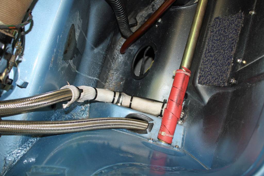

jerhofer   Perry built in an oil cooler box in the front trun...   Jun 17 2018, 12:07 PM

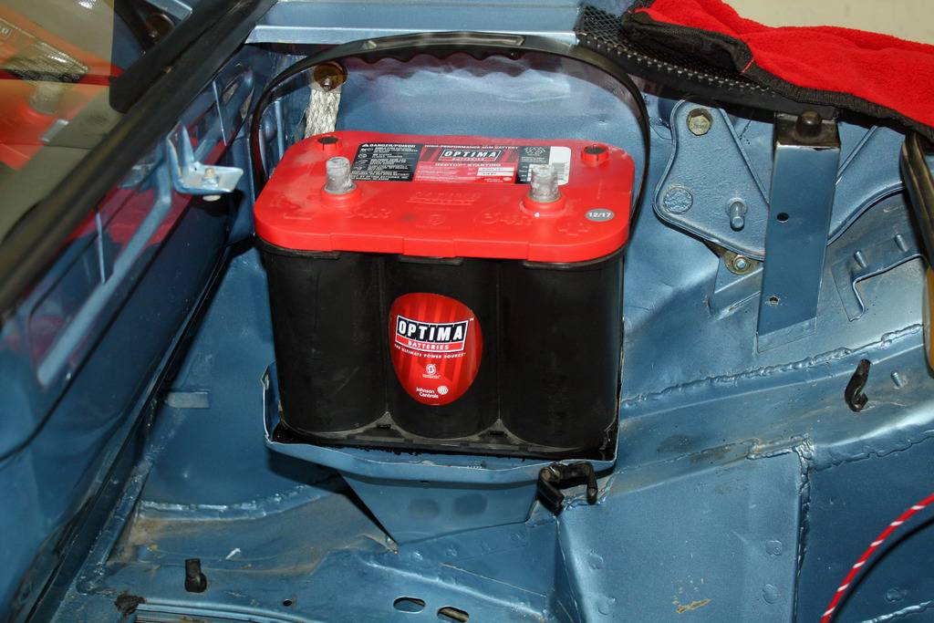

jerhofer   There was some surface rust in the battery tray. ...   Jun 18 2018, 03:23 PM

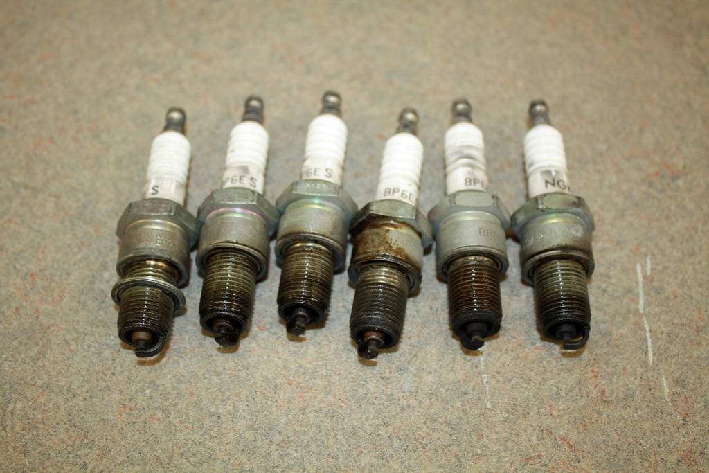

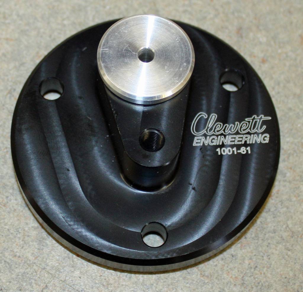

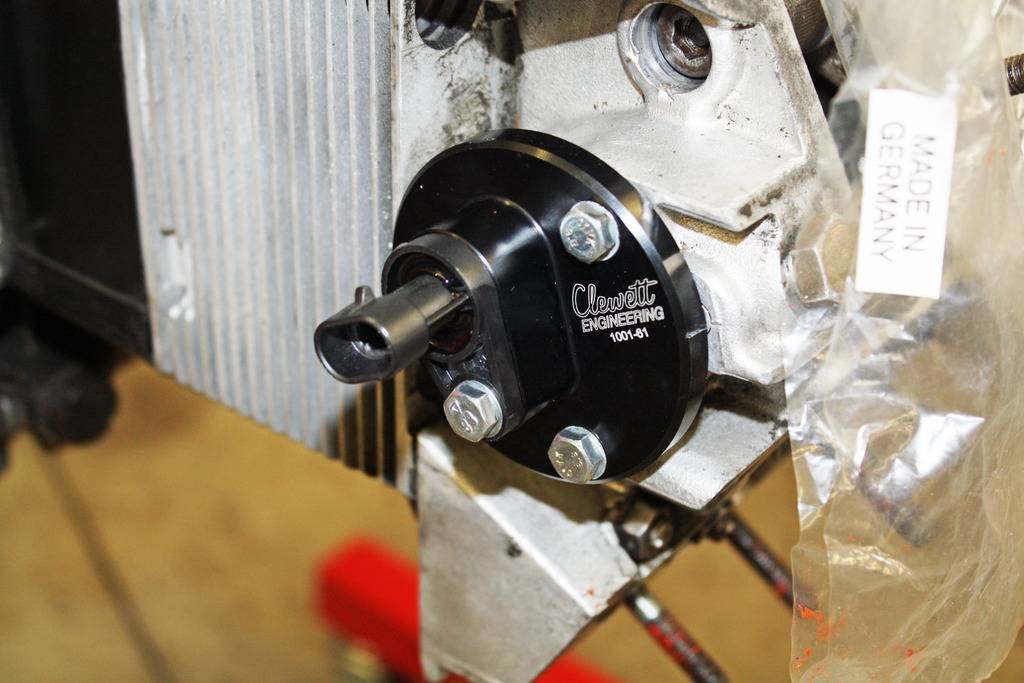

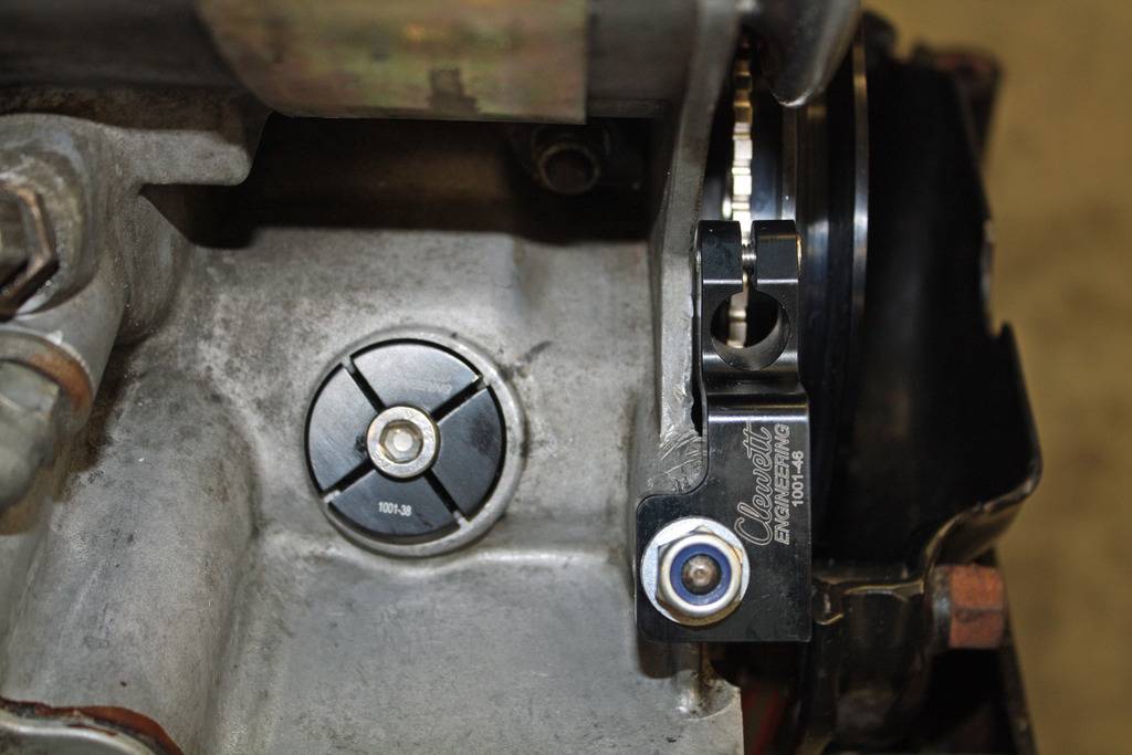

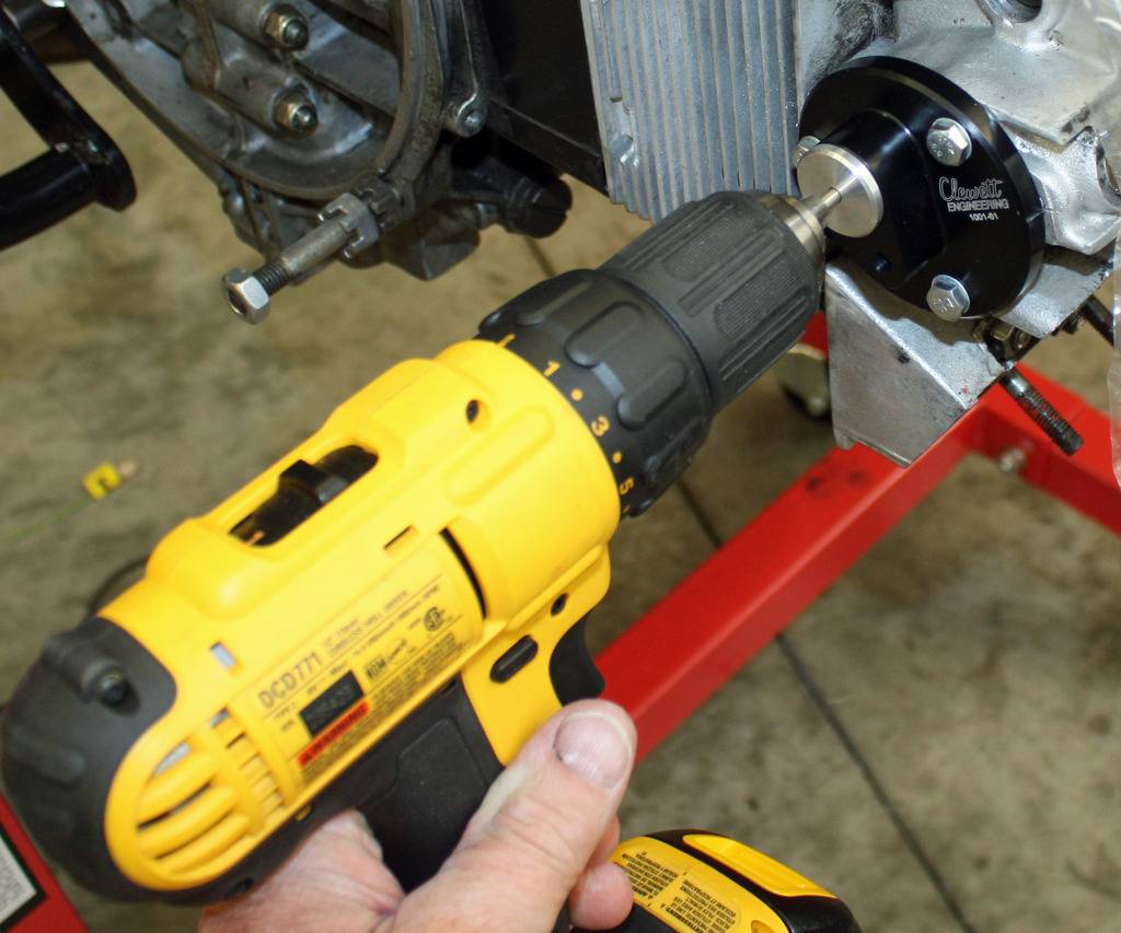

jerhofer   I finally found a few hours to spend on the engine...   Aug 21 2018, 07:20 PM

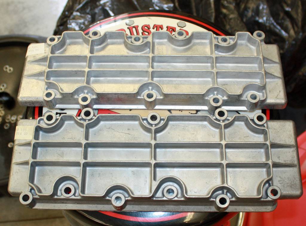

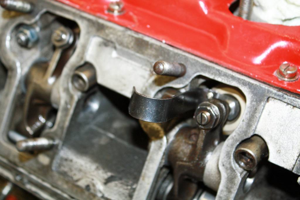

jerhofer   When removing the valve covers, one stud came out ...   Aug 29 2018, 02:45 PM
mepstein   On a lot of cars, the turbo covers need the outer ...   Aug 29 2018, 03:02 PM
jerhofer   On a lot of cars, the turbo covers need the outer...   Aug 29 2018, 04:48 PM

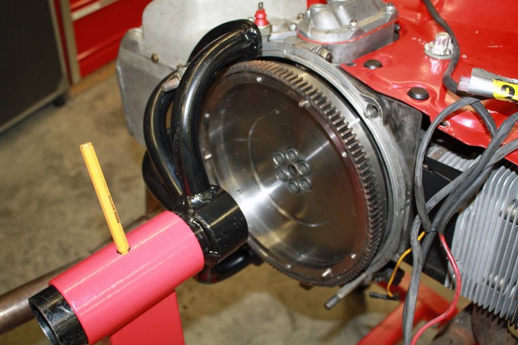

914Timo   WOW !! Six bolt flywheel. Not an ordinary ...   Aug 30 2018, 10:30 AM
jerhofer   WOW !! Six bolt flywheel. Not an ordinary...   Aug 30 2018, 04:04 PM

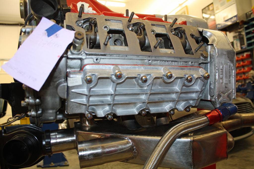

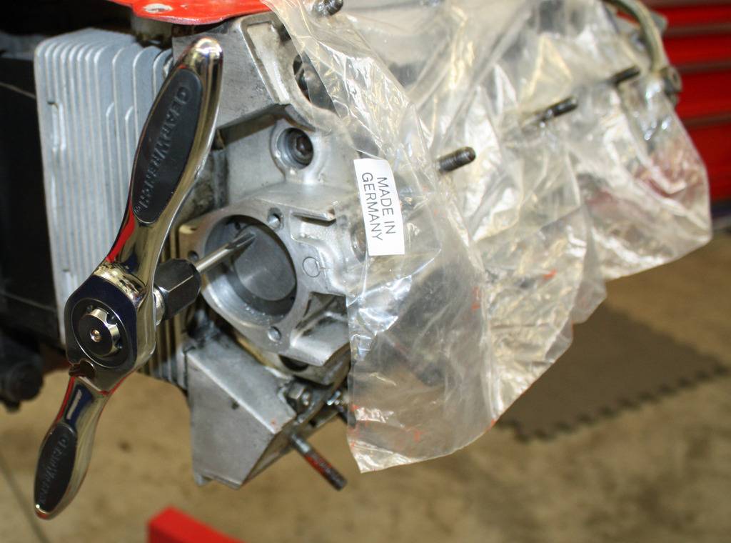

jerhofer   I worked all afternoon and accomplished quite a bi...   Aug 31 2018, 07:47 PM
jerhofer   Now it was the throttle bodies turn. First up is ...   Aug 31 2018, 07:59 PM

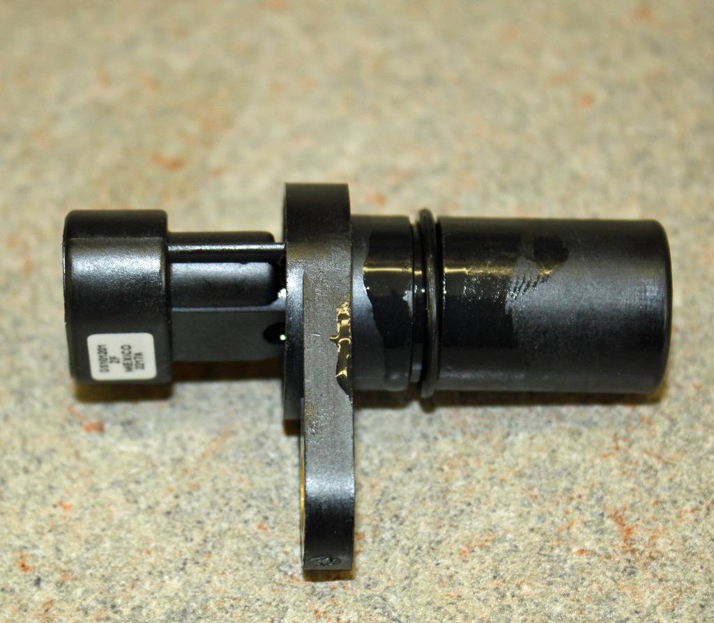

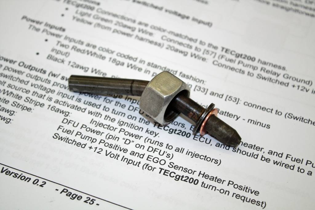

jerhofer   Another day, another sensor for the engine. This ...   Sep 6 2018, 01:51 PM

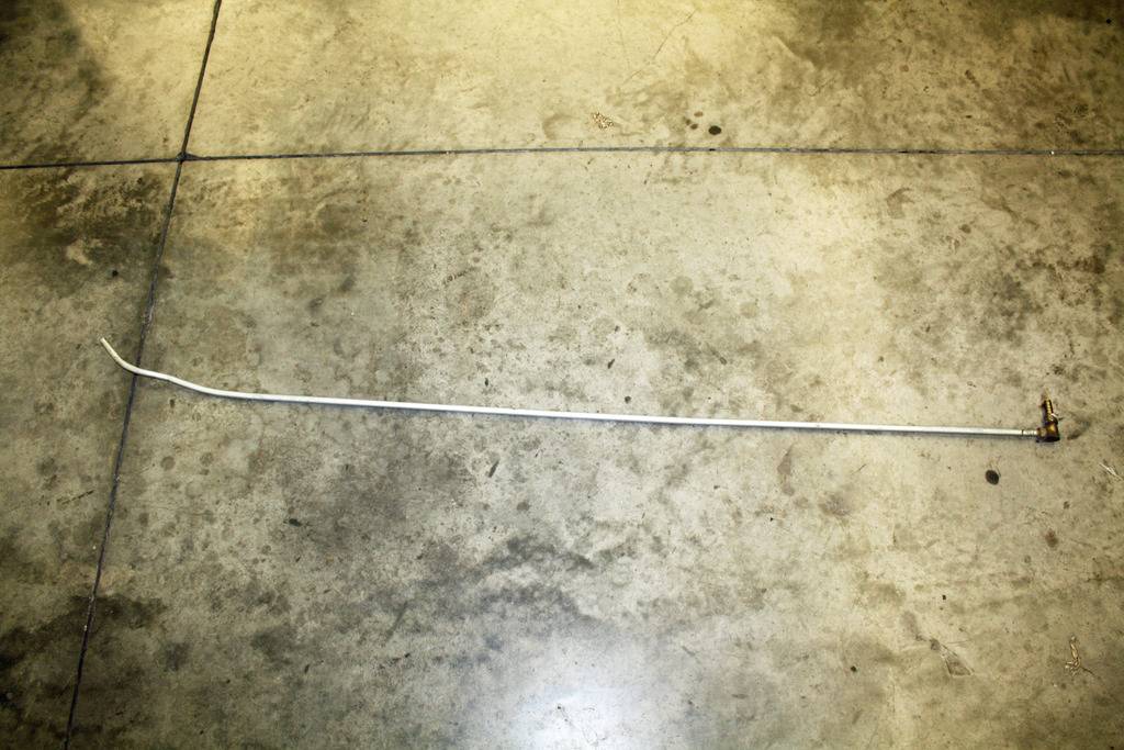

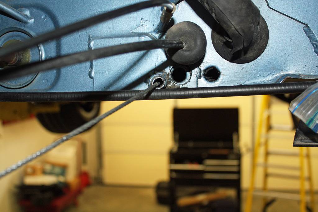

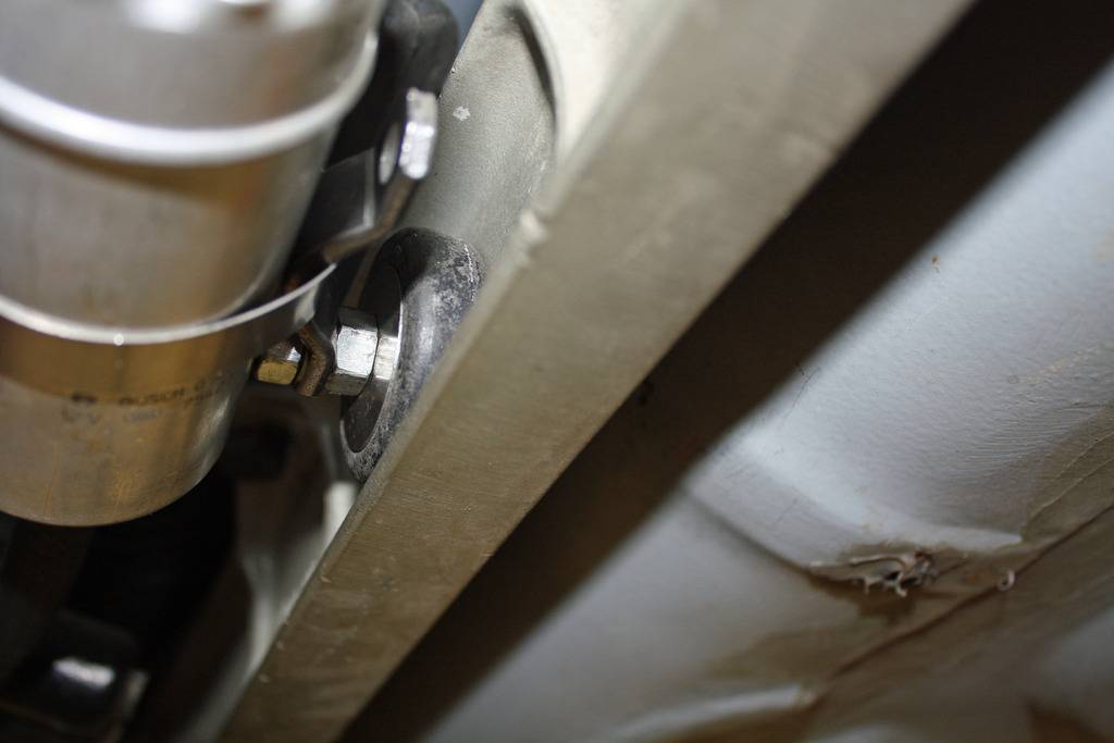

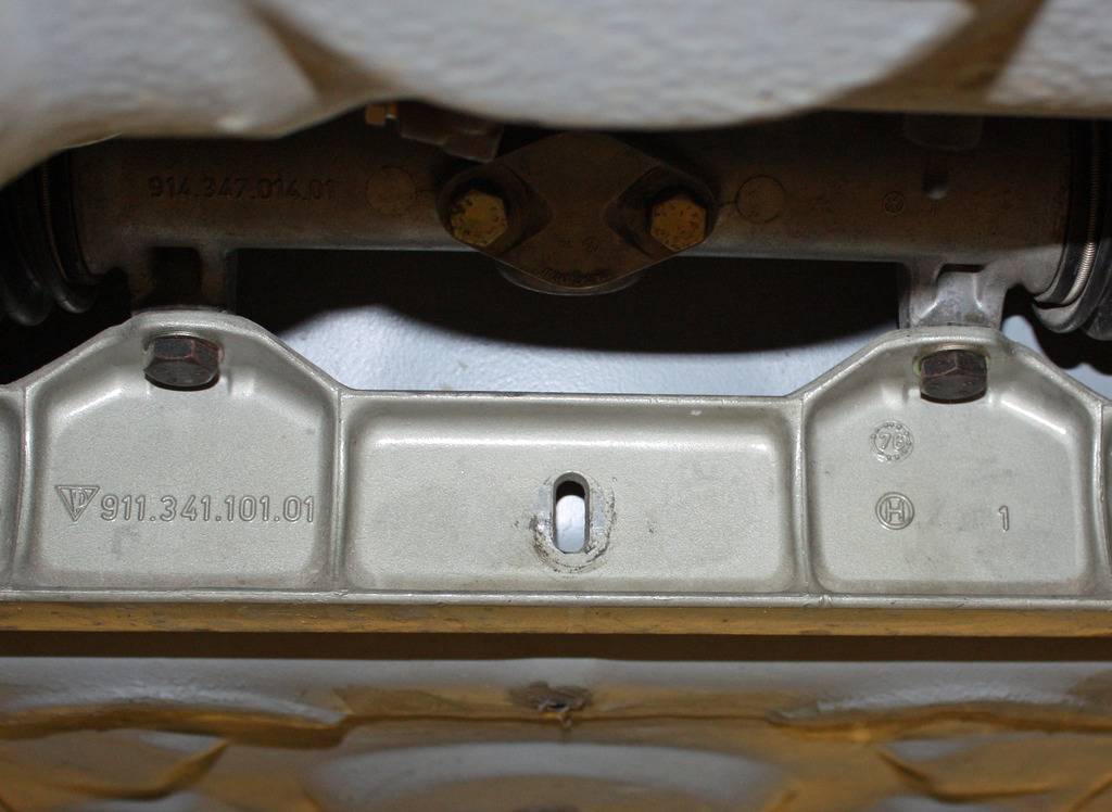

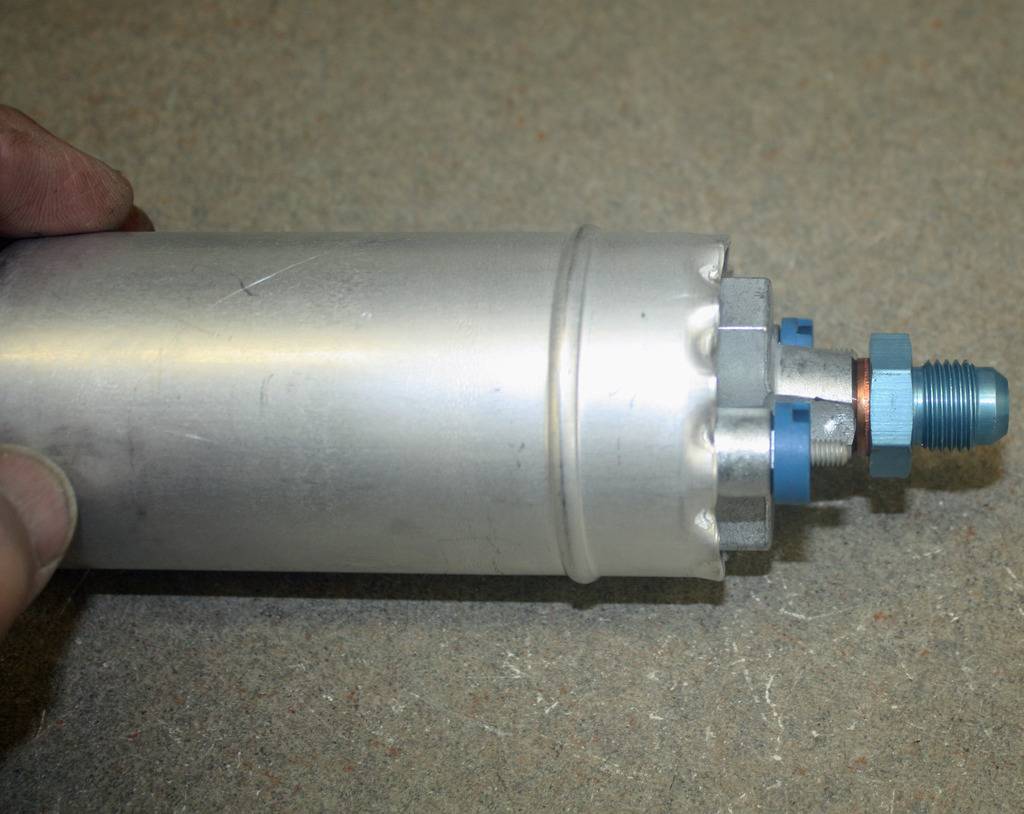

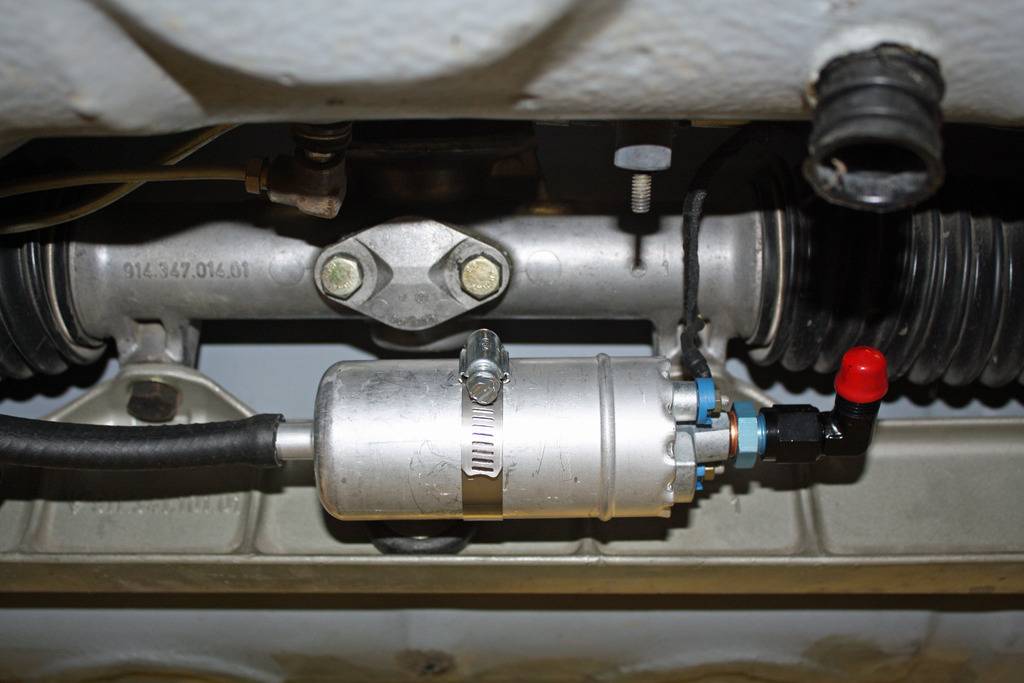

jerhofer   To prepare for running the fuel lines, I removed t...   Sep 8 2018, 04:17 PM
914forme   You can see them in the tunnel by opening up the r...   Sep 8 2018, 05:22 PM
jerhofer   You can see them in the tunnel by opening up the ...   Sep 8 2018, 07:36 PM

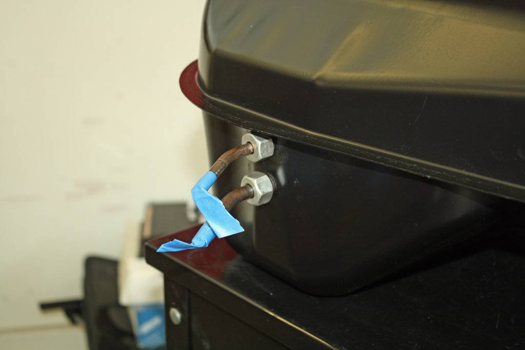

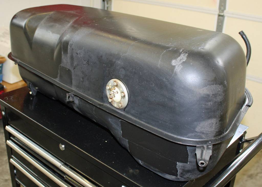

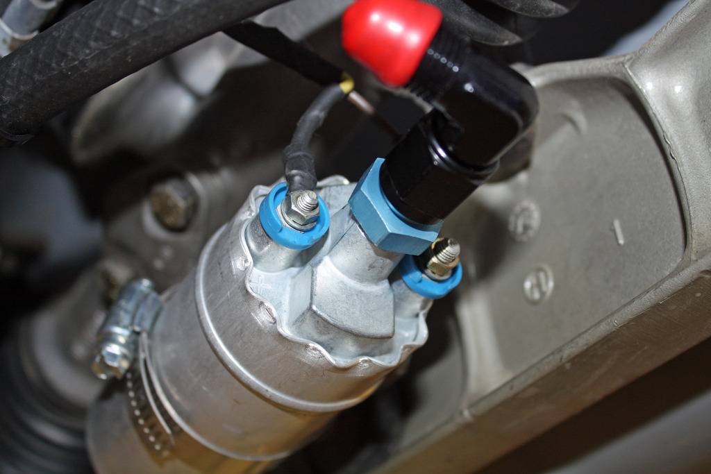

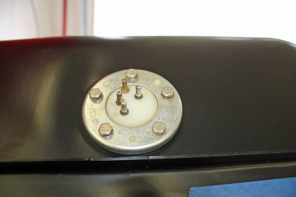

jerhofer   I pulled the fuel tank this morning. First up was...   Sep 10 2018, 02:43 PM
jerhofer   Before removing the tank, I looked inside to see i...   Sep 10 2018, 02:54 PM
