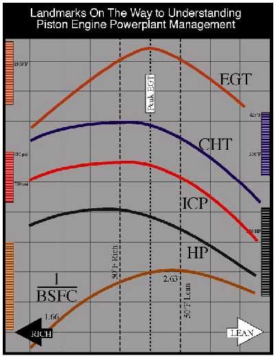

With regards to jetting....
If you're using a centrifugal only distributor shoot for 13:0 - 13:5 across the board.
If you have a vacuum advance distributor you can go leaner but stay out of the 'Deathzone'....14:0 - 15:0 AFR zone At WOT. This is where EGT & CHT temps are the absolute highest.
Go leaner than 15:0 and the temps are cooler than 13:0 or so (partial throttle). Ideally 15:5 - 17:0 at cruise speed light load/cracked/part throttle = GREAT MPG's! This can only be done with a vacuum advance distributor or mapped EFI set up.
WOT = 100% load
Load = Throttle position
Part throttle = light load
See where the EGT and CHT temps go beyond peak....

gereed75   Hardtop, that is a very good graph and if you un...   Oct 8 2018, 08:20 AM
72hardtop   Hardtop, that is a very good graph and if you u...   Oct 8 2018, 08:47 AM
