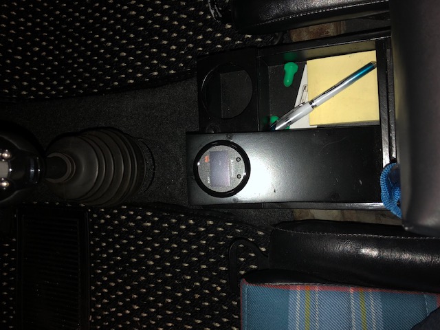

Hi Toy914 and all,
Did you use the Innovate "DLG-1 Dual Lambda (Air/Fuel Ratio) Gauge" with the 8 foot long leads? If so were the leads long enough to mount the gauges somewhere sensible?
I need to do the same for my Corvair-powered 2.8L engine - which has O2 sensor bungs in each exhaust right at the back of the car.
I'm running zenith 40TINS with 30mm chokes, running way too rich. May copy your jetting and see how I go.
Your reply much appreciated,
DaveO
914Toy
post Oct 8 2018, 08:25 AM
Posts: 746
Joined: 12-November 17
From: Laguna beach
Member No.: 21,596
QUOTE(DaveO90s4 @ Oct 7 2018, 10:51 PM) *
Hi Toy914 and all,
DaveO
Yes, and here is where I placed the gauge.
