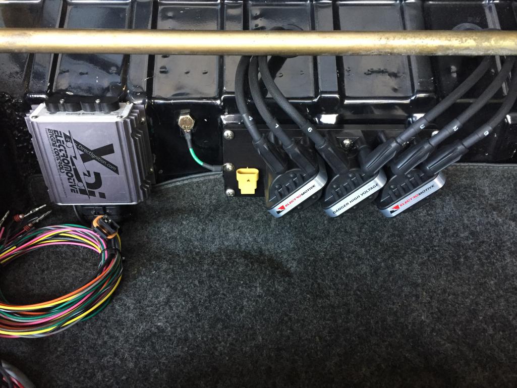

I'm running the Clewett ignition system as well. This photo was taken while I was doing the wiring, so it doesn't appear finished.
