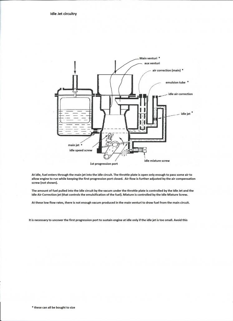

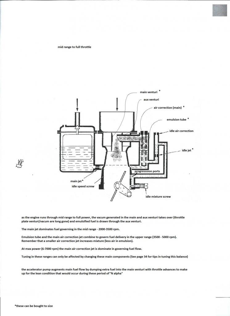

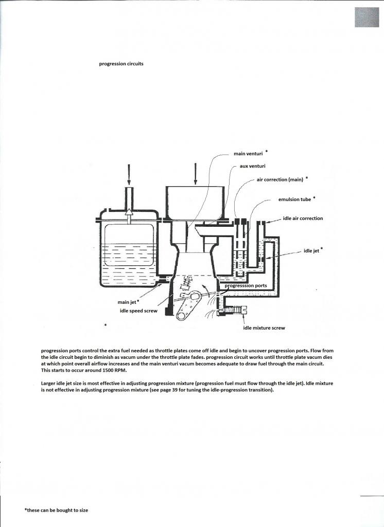

gereed75
post Oct 10 2018, 03:22 PM
Posts: 1,446
Joined: 19-March 13
From: Pittsburgh PA
Member No.: 15,674
I am not sure where I got these but they graphically show how the jetting and float level inter-relates and operate as the throttles are open. Thanks and credit to whoever authoured these. Attached Image
Understand all of this, apply it in 30 or 40 applications, and you are on your way to weber guru status
