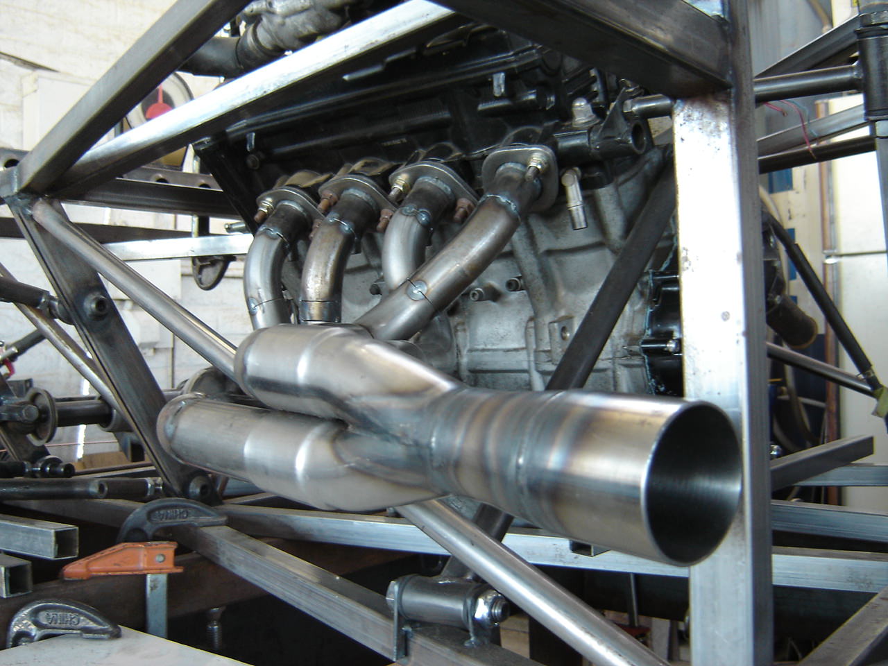

So get to work . Here is another system.
(IMG:http://www.914world.com/bbs2/uploads_offsite/i.imgur.com-8123-1539925334.1.jpg)
