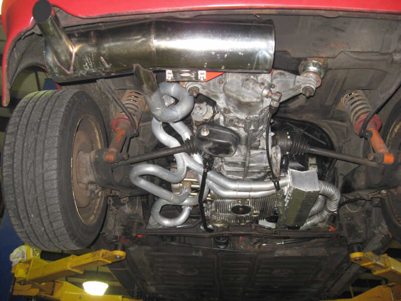

ChrisFoley
post Oct 18 2018, 08:48 AM
I am Tangerine Racing
Posts: 7,990
Joined: 29-January 03
From: Bolton, CT
Member No.: 209
QUOTE(maf914 @ Oct 18 2018, 09:50 AM) *
QUOTE(mepstein @ Oct 18 2018, 04:11 AM) *
Thread is 10 years old.
(IMG:style_emoticons/default/laugh.gif) Yes it is!
And not much has really changed on the 914 exhaust scene. (IMG:style_emoticons/default/idea.gif)
Except that the Tangerine Exhaust has been further improved. (IMG:style_emoticons/default/smile.gif)
I doubt any development has been done to the other 914 "performance" exhaust systems.
This picture is from 2013, already different from the 2008 version, and I've just started building systems with some subtle new changes.
