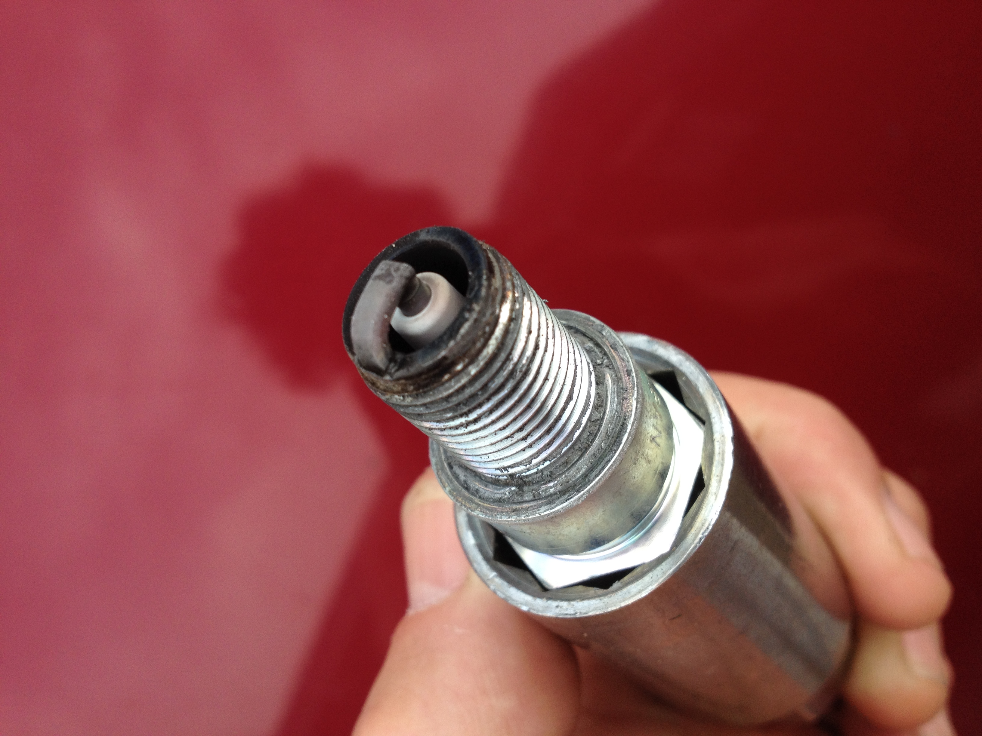

Ok what do you think? Maybe 1000 miles with this new AFM and it's set up.

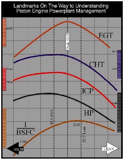

Was it allowed to idle prior to pulling the plug/ It matters even the slightest. Also with today's ethanol blended fuel E10+ it takes a few thousand miles of seasoning the plugs before you can use them as a gauge for AFR.
Load = WOT
Part throttle is NOT load
Cruise = part throttle condition
An AFR of 16-17 at cruise (part throttle cond) is COOLER running than at an AFR of 13:0 - 13:5
With respect to jetting....Get above (14-15AFR range) when on the progression and below (14-15AFR when on the main jets. 90% of ones driving is on the progression circuit (idle jets).
The following chart shows this....

Mark Henry   I'd say that plug is a tad hot, what number is...   Mar 27 2017, 05:17 PM
malcolm2   I'd say that plug is a tad hot, what number i...   Mar 27 2017, 07:11 PM
Olympic 1.7   Spark plugs are an easy change, you could try NGK ...   Mar 28 2017, 07:55 AM
