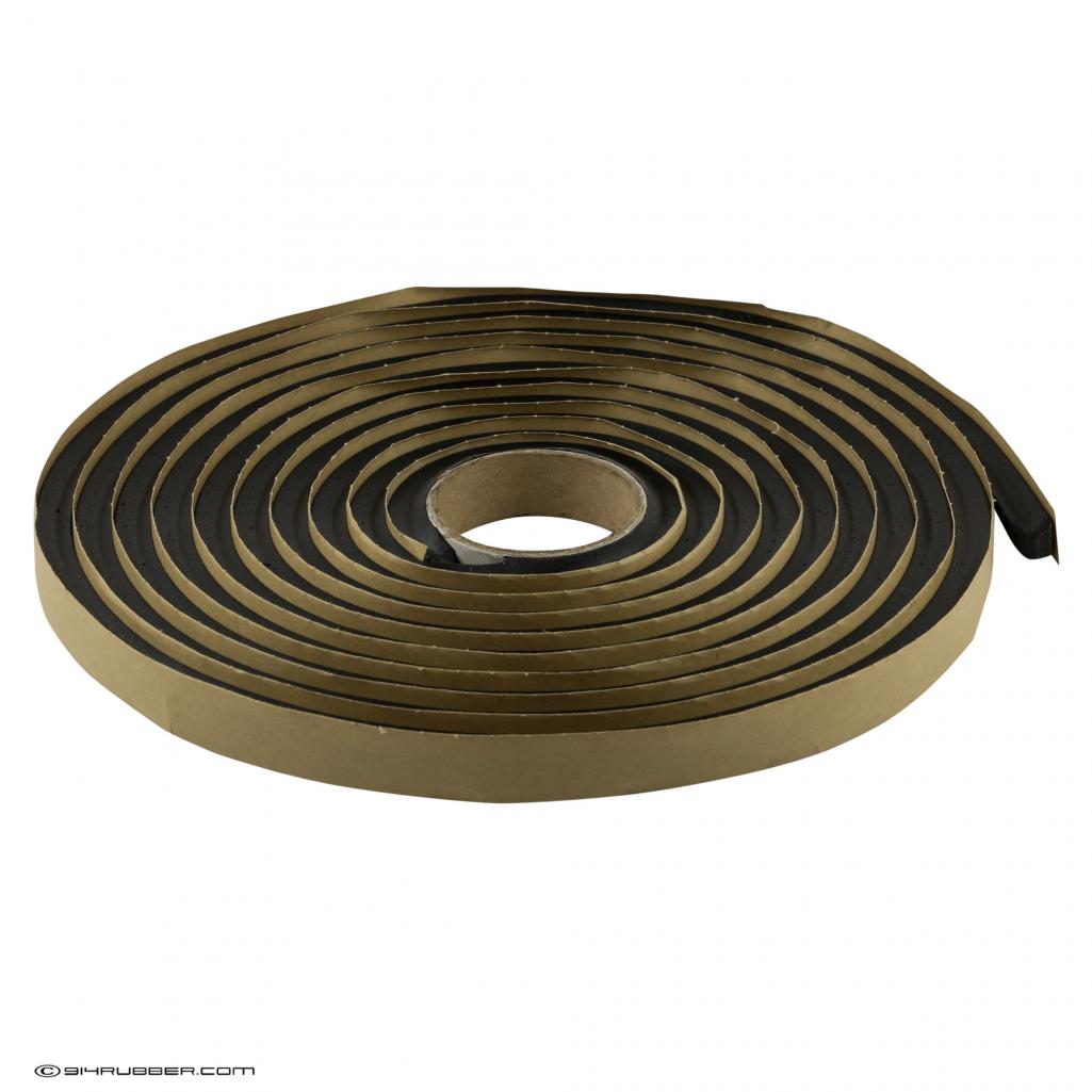

Also for those of you that prefer the 8mm butyl chord, we have it.
https://www.shop.914rubber.com/Butyl-Cord-8...m?categoryId=-1
1/4" is way too small
