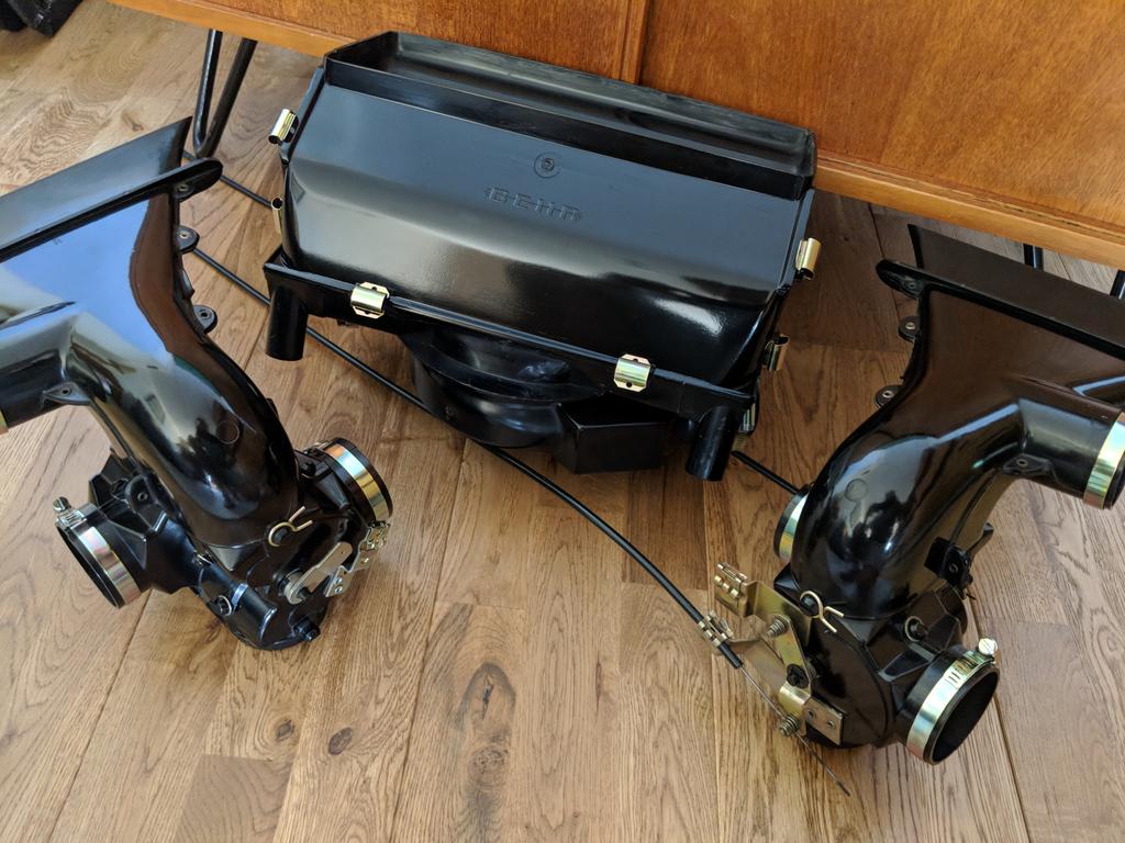

Yes it is a sickness; and I believe other World members have it. I went so far as to transfer the stickers and felt bad from my broken fan housing to the new one. Only I will know.
Inspired by the crew here, I spent more hours than I should have on my blower. Though a hidden part, I am happy with my results.
I started with my original system paired with a donor system I purchased several years ago. I used Easy-Off to remove most all of the overspray, followed by a combination of 1000, 2000, Autsol, and Magic Eraser. New 914 Rubber seals and plated hardware finished if off. Attached ImageAttached ImageAttached Image[attachmentid=673

Nice job. You're not alone, I also suffer the same sickness. (IMG:style_emoticons/default/lol-2.gif)
(IMG:http://www.914world.com/bbs2/uploads_offsite/i.postimg.cc-6621-1541325547.1.jpg)

Literati914   A tutorial? for those of us who are happily 914 si...   Nov 4 2018, 10:43 AM

Targa70   Since a few members have asked, here is how I did ...   Nov 5 2018, 08:47 AM

jim_hoyland   Any paint ? The plastic looks great ! Nice wor...   Nov 6 2018, 06:21 PM

Targa70   Although tempted, I did not use paint. The system ...   Nov 6 2018, 07:48 PM
jim_hoyland   Does the shine come from dancing with 1,000 and 2,...   Nov 15 2018, 05:28 PM
Targa70   Yep, w/d 1K/2K sandpaper Worked great for the big ...   Nov 15 2018, 06:27 PM
jim_hoyland   Yep, w/d 1K/2K sandpaper Worked great for the big...   Nov 15 2018, 08:58 PM
Targa70   Autosol is a metal polish I first heard about on h...   Nov 16 2018, 06:41 AM
jim_hoyland   Autosol is a metal polish I first heard about on ...   Nov 16 2018, 10:20 AM
