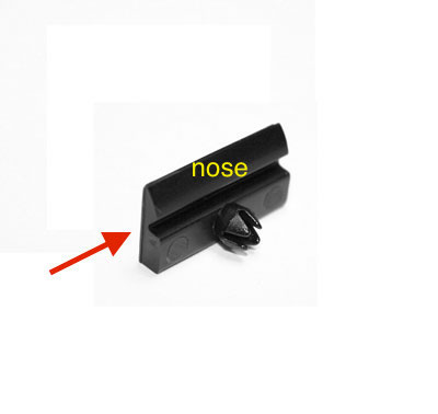

I can't speak for others, but this is where mine have been breaking.
At the thin spot where the arrow is pointed.
Obviously this is the groove where the trim snaps into.
The nose section of the clip must pivot a little to allow the trim to snap into the groove.
Seems like the plastic is too brittle for this to happen in a reliable manner.

QUOTE(raynekat @ Nov 2 2018, 11:40 PM) *
That is where m8 e broke as well
