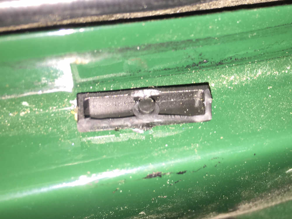

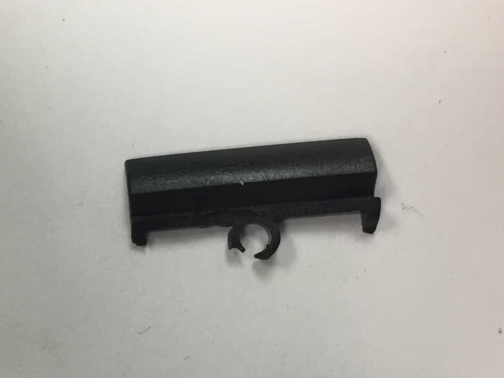

Here are two pics of failed parts, typical of what we experienced when setting the trim:
The failure is not thru the thin hinge section.
We also had failures of the ears which go thru the hole, just from pushing the into the hole or from setting the pin.
I've frequently re-used original clips that were removed from cars (by pushing the pin out thru the back) more than 30 years after installation at the factory. The hardest part is finding an appropriately sized pin to set them in place.

Similar to the failures on mine....
QUOTE(ChrisFoley @ Nov 5 2018, 08:20 AM) *

rhodyguy   hard to imagine why the failure occurs in that spe...   Nov 5 2018, 10:56 AM
Mikey914   It appears to be a materials issue. It did shear. ...   Nov 5 2018, 11:40 PM
