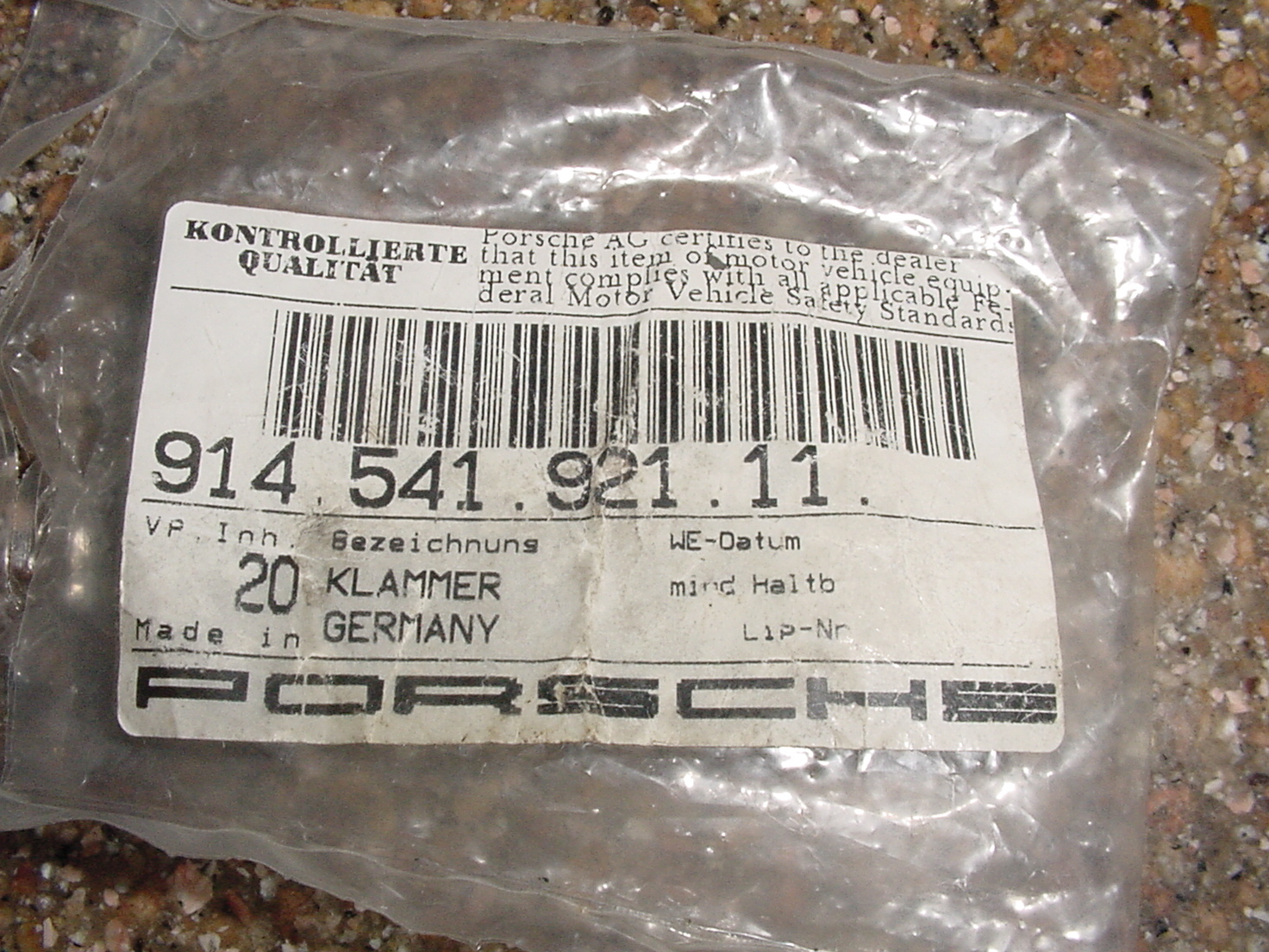

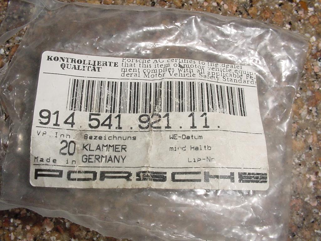

hard to imagine why the failure occurs in that specific area and not where one might consider the weakest point. not a solution but checkout the labeling on this. I've had a set of 20 for years. MADE IN GERMANY. I wonder if the recycled material mix is a factor?
