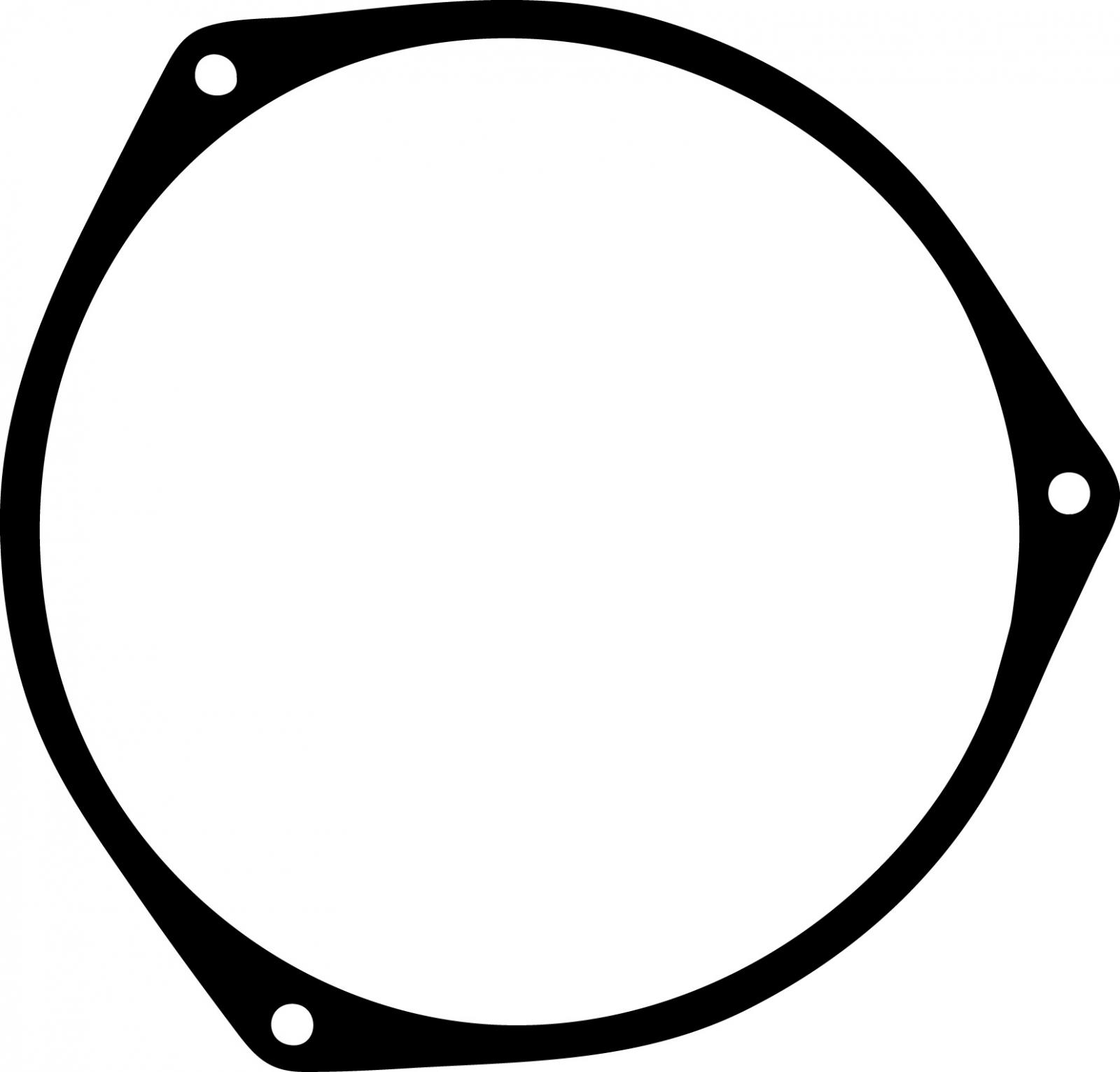

template for alternator gasket 021903637 / 021 903 637
Print out at 300dpi and you're good to go.
