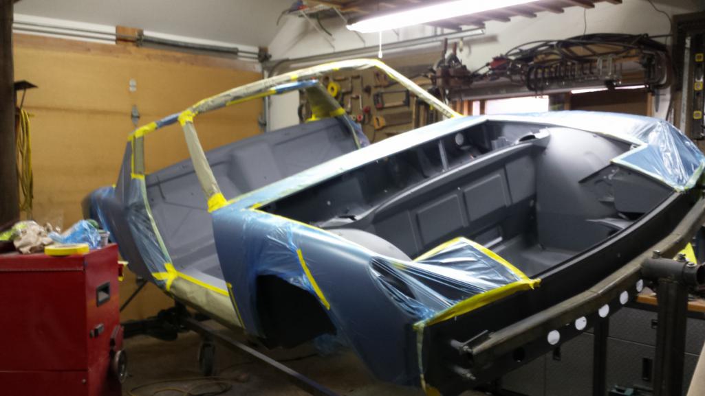

(IMG:style_emoticons/default/agree.gif) Plus some fabrication of parts not readily available or try to get the whole chunk of what you need from a donor. I was able to patch my inner long but it was a lot of work.
Take heart, your car looks to be in similar condition as mine when I finally dove in for the resto. Thirty years of discouragement from nonbelievers is probably what saved my car. Spite can be a great motivator (IMG:style_emoticons/default/happy11.gif)
(IMG:http://www.914world.com/bbs2/uploads/post-20845-1513794304.jpg)
That spot repaired before the jack point went back on.
(IMG:http://www.914world.com/bbs2/uploads/post-20845-1506041831.jpg)
And here's a recent pic taken about 18 months later
(IMG:http://www.914world.com/bbs2/uploads/post-20845-1540170873_thumb.jpg)
You can check out my build thread to see how a clueless idiot tackled a project of this size, or check out Jeff Hail's Bring Out Your Dead thread in the rebuild forum to learn from someone who knows what they are doing. Also, read through the various build threads from @cary . He provides lots of detail of repairs that are a treasure trove to learn from.
Congrats on getting the engine running.
Good luck and keep posting your progress! (IMG:style_emoticons/default/beerchug.gif)
