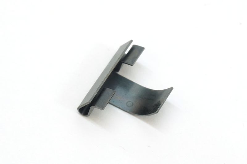

When installing the 3 aluminum trim pieces on roll bar, are the 2 side trim pieces the only support for the top roll bare piece. The reason I’m asking is on my previous 914 I thought there was a clip in the center of the trim piece that fit in a hole in the bar to hold it in place. Thanks

part # 914.559.223.10
About $10 each at the porsche dealer but you can probably find used. Maybe bdstone, Garold, ect @xperu Attached image(s)

part # 914.559.223.10 About $10 each at the porsche dealer but you can probably find used. Maybe bdstone, Garold, ect @xperu OK so now that I picked up the 3 clips, What is the best method to install. I looked at several threads, but no info. Like I said before it's been 10 years or so sense I removed the trim and really can't remember. I just do not want to screw things up. Thanks Mike |

part # 914.559.223.10 About $10 each at the porsche dealer but you can probably find used. Maybe bdstone, Garold, ect @xperu OK so now that I picked up the 3 clips, What is the best method to install. I looked at several threads, but no info. Like I said before it's been 10 years or so sense I removed the trim and really can't remember. I just do not want to screw things up. Thanks Mike Clip goes on the trim then push trim onto targa bar. Push straight on, it doesn’t slide on from the side. |

rgalla9146 Just to clarify...The clips are slid into the hori... Nov 9 2018, 01:03 PM
dr914@autoatlanta.com yes three clips slide into the aluminum trim and t... Nov 9 2018, 01:15 PM![]() ![]() |
