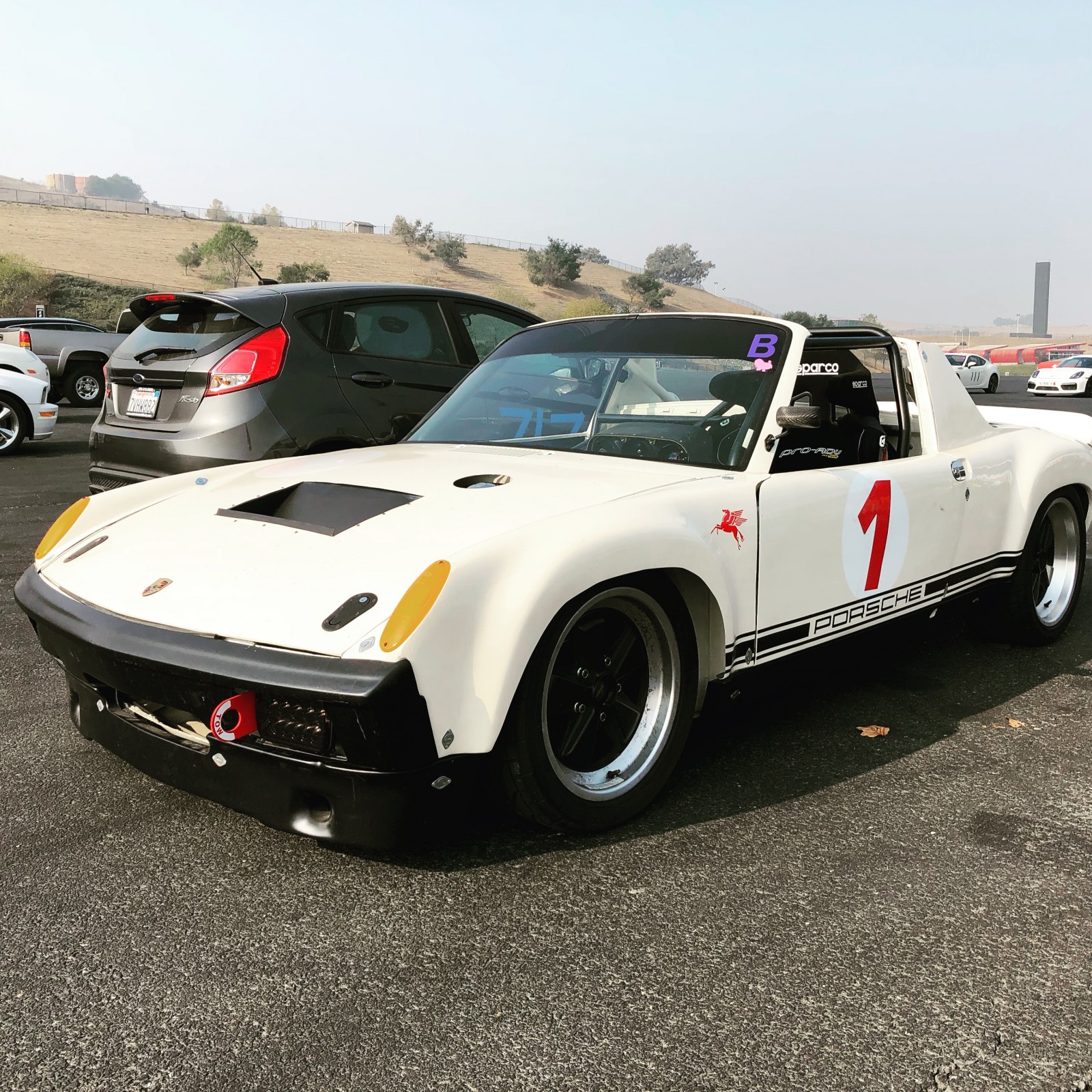

Heres a pic of the car in the paddock @ Sonoma. She looked the business even if she drove like a manic-depressive rodeo bull.

MichiganMat   It lives. First track day for the car is in the b...   Nov 18 2018, 12:01 AM
ConeDodger   P It lives. First track day for the car is in the...   Nov 18 2018, 09:11 AM
raynekat   Car looks and sounds great. Yeah, get that handlin...   Nov 18 2018, 12:34 AM
MichiganMat   Heres a pic of the car in the paddock @ Sonoma. S...   Nov 18 2018, 08:53 AM
914forme   Great to see the car get out on the track, that is...   Nov 18 2018, 09:50 AM
MichiganMat   • Rear: 250lb Swift springs over new Bilstein s...   Nov 18 2018, 11:27 AM
914forme   :WTF: Add a front sway bar NOW!!!...   Nov 18 2018, 02:00 PM
MichiganMat   :WTF: Add a front sway bar NOW!!!...   Nov 18 2018, 02:03 PM
mepstein   :WTF: Add a front sway bar NOW!!!...   Nov 18 2018, 02:11 PM
914forme   I missed the lowered car part, it is fine to lower...   Nov 18 2018, 02:14 PM
914forme   I think your close on the spring rates. Stock wit...   Nov 18 2018, 02:23 PM
