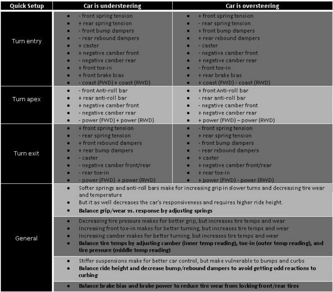

Great to see the car get out on the track, that is a big day. (IMG:style_emoticons/default/piratenanner.gif)
Time to get to sorting all the issues out, nobody nails this right on the money. Everyone likes their cars setup slightly different.
Modify the shifter. Extended the lever to increase the perceived throw, move the cable points so that it increases the throw, that is pretty easy one. Lots of 818 guys run this setup with out issue. BTW, in two different shifters where made from Toyota, early cars had a longer throw, the later cars got it shortened up. If you used after market short throw kits they are not know to be the best quality and can add some error to the movement.
Suspension start with alignment, and worn components. To make an educated guess we would need to know what you're running for all the various bits and pieces.
Spring rates in the back
Running a rear swaybar? If yes size
Running a front sway bar? I hope so, If yes size
Torsion Bar size
Shocks - settings come into play, and valving.
Bushings in the Front
Bushings in the Rear
Tire sizes front and rear also come into play
My one suggestion is document everything as it sits now, and build out a list from there, and change one thing at a time, then recheck the alignment.
You most likely know all this stuff, just wanting to help get the car sorted fast here is a simple cheat sheet, image quality is poor.

MichiganMat   :WTF: Add a front sway bar NOW!!!...   Nov 18 2018, 02:03 PM
mepstein   :WTF: Add a front sway bar NOW!!!...   Nov 18 2018, 02:11 PM
914forme   I missed the lowered car part, it is fine to lower...   Nov 18 2018, 02:14 PM
914forme   I think your close on the spring rates. Stock wit...   Nov 18 2018, 02:23 PM
