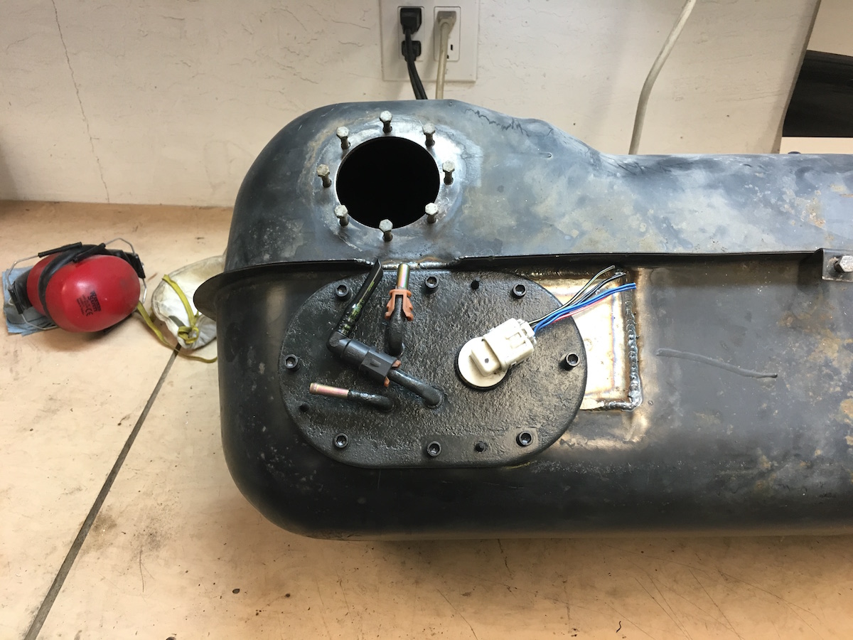

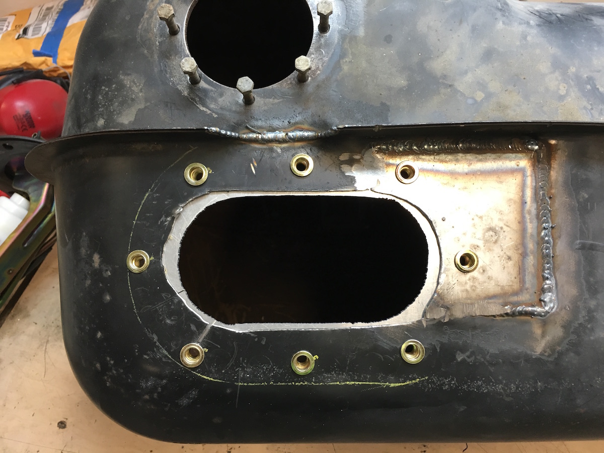

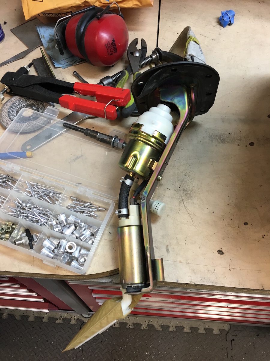

Bought a WRX fuel sender/filter/pump and modified it to work in the 914 tank.
Cut and bent the lower portion downwards to fit well and pull from the lowest portion of the tank.
Modified the internals of the tank, pulled out some baffles, and welded up the bottom.
Installed an aluminum inner ring and then riv-nut'd that in to give support to the tank area.
Bought a fuel filler neck, more on that later...

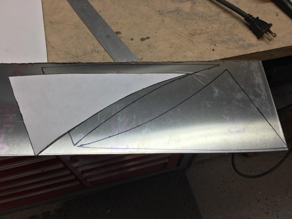

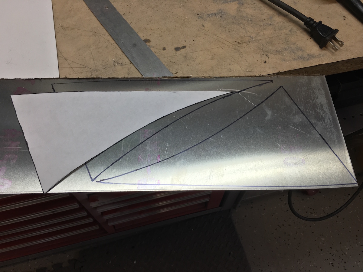

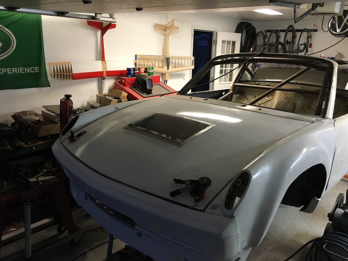

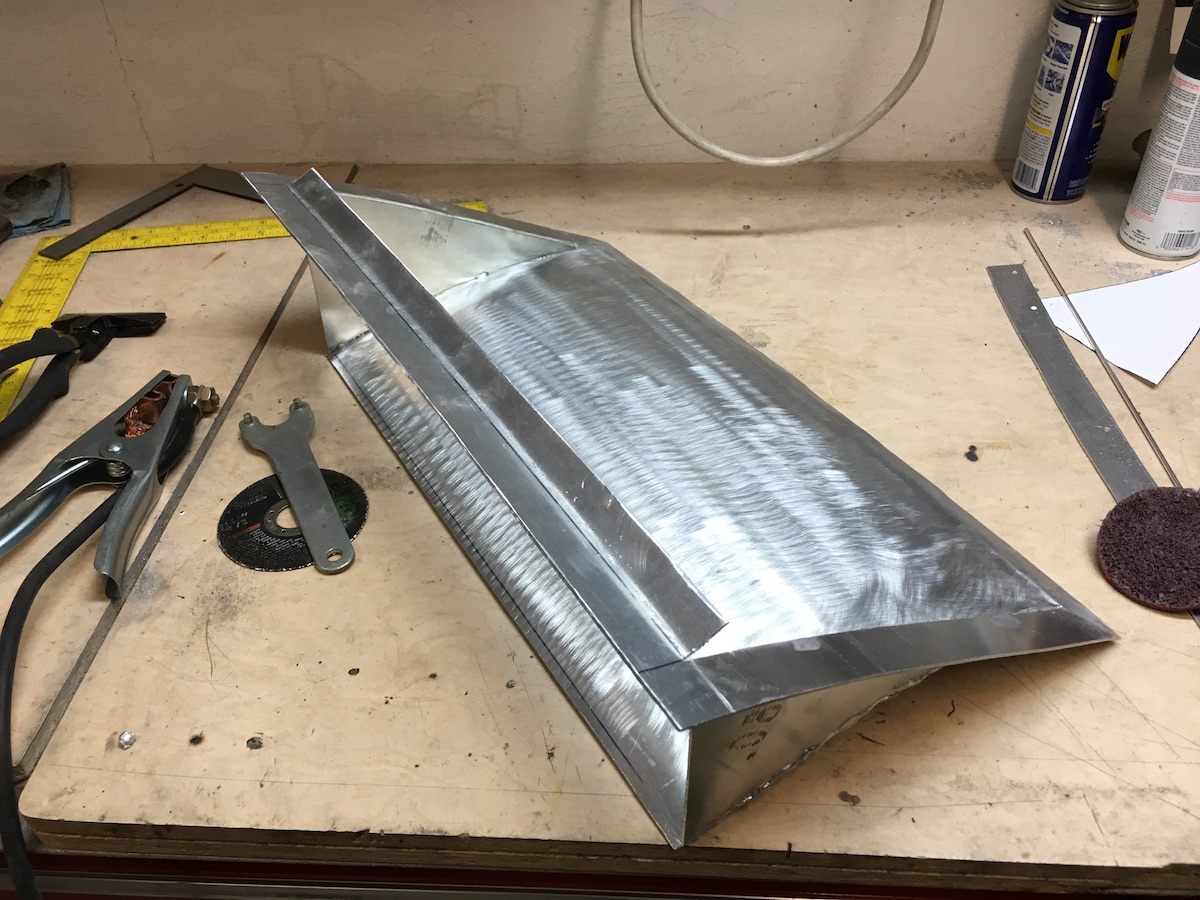

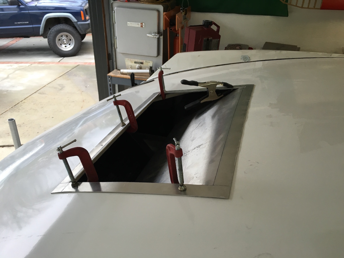

Next up was the air outlet through the hood.
Cut a nice big hole and fab'ed up as best I could an outlet vent.
I need to work on my aluminum welding, I've done better work :/ But it'll do for now.
I plan to finish it in black paint and mount externally. It'll be industrial looking, and functional.
I was also able to get the front lower lip mounted, the drivers rocker, and the rear trunk hood pins all attached. Pics aren't too sexy so maybe I'll skip 'em for now.
Next up: fuel filler neck install on the tank and through the hood, put the rotisserie back on the front of the car, fit and mount the rear bumper, reinforce the drivers-side dog-ear, and buy a bunch more parts, haha
