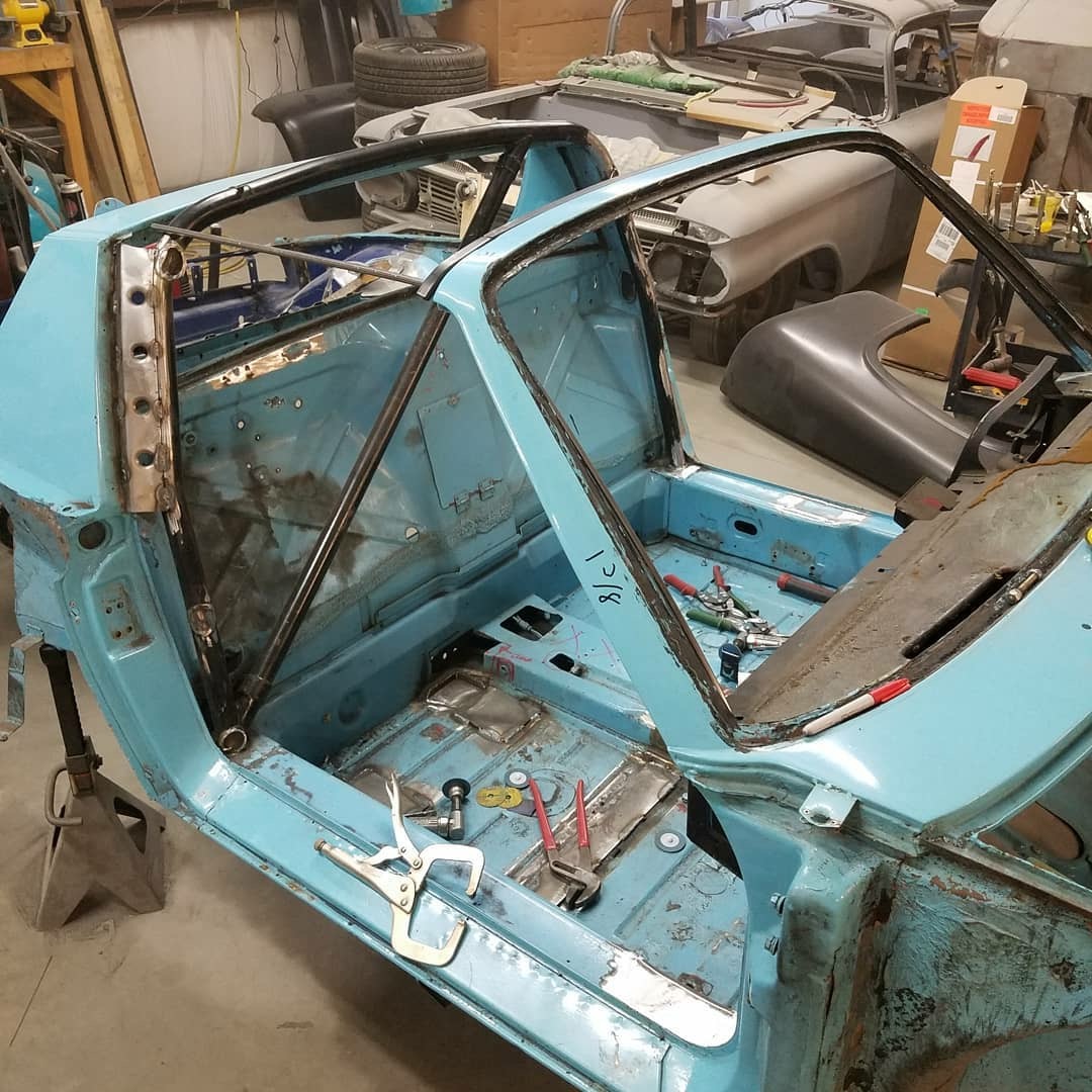

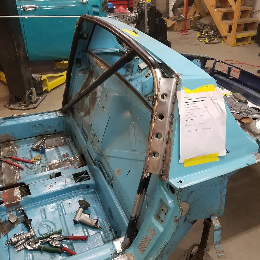

Ok, so far out guys at the fab shop have cleaned up the passenger floor board area and a bunch of holes and messy areas, and started redesigning the cage. Moving the front legs forward, adjusting the top bar by the windshield, better door bars, roof cross bar, then tying into shock points and triangulating it all. Plus adding Chris Foleys rear shock towers with spherical bearings.

jmitro   heckuva winter project. that A pillar bar is pret...   Oct 27 2018, 07:21 AM
MichiganMat   Whoa, the suspension points aren't tied into t...   Oct 27 2018, 10:14 PM

tygaboy   I've bent a few tubes in building my car and I...   Dec 2 2018, 04:22 PM
jmitro   that's a really great fit you got there! ...   Dec 23 2018, 08:27 AM

Cairo94507   Wow- that is some serious bracing. That car will ...   Dec 23 2018, 06:51 AM
dan10101   Very nice. I'm taking notes and saving pictur...   Dec 23 2018, 08:39 PM
naro914   Cage is pretty much done, just some minor braces. ...   Dec 28 2018, 02:57 PM
GeorgeRud   Glad to see the Nascar styled side impact bars - m...   Dec 28 2018, 03:20 PM
