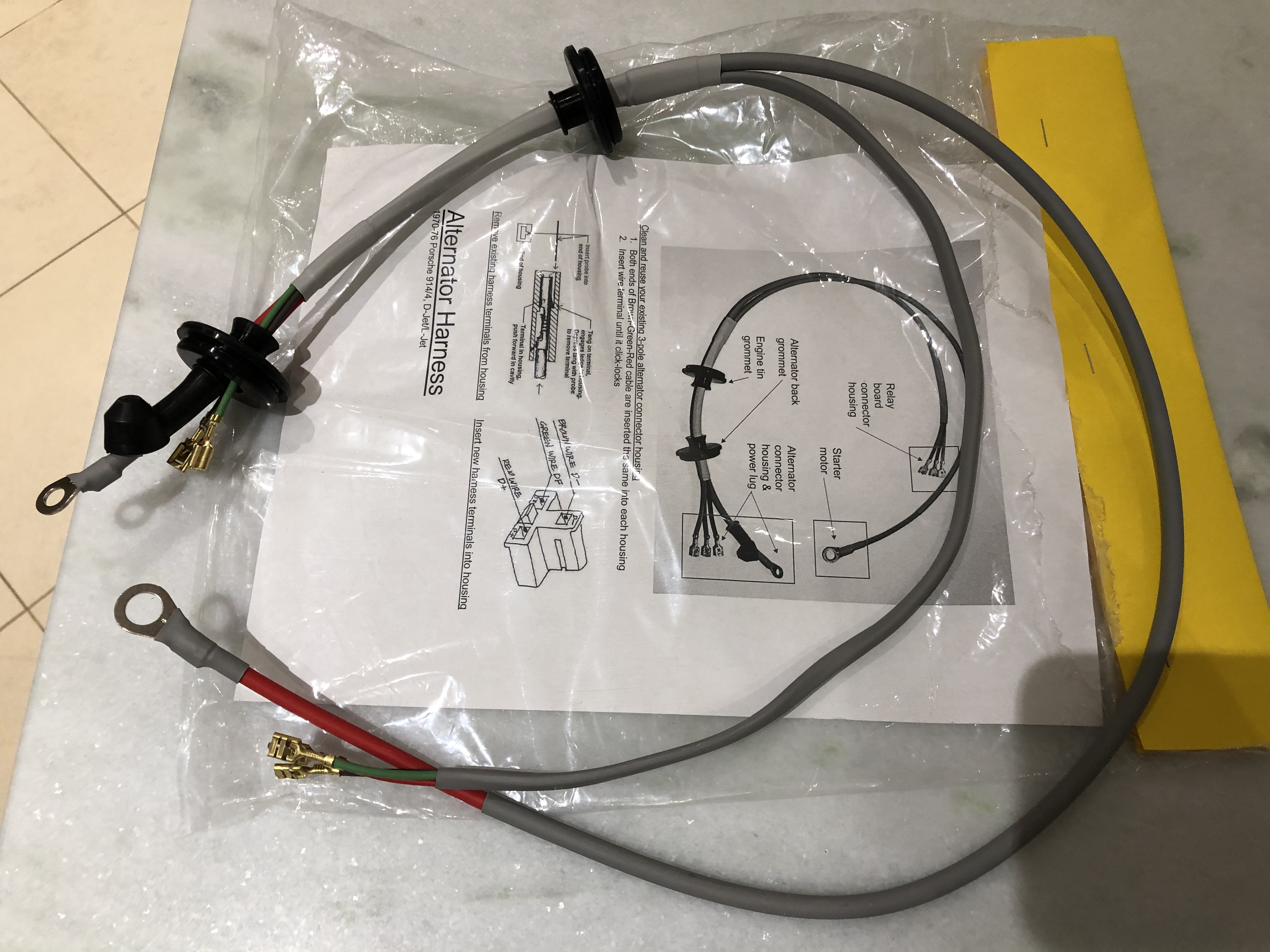

So a nice package arrived today from Mr Bowlsby....
Btw - the replacement alternator has a large plastic type washer instead of a metal one under the bolt for the wires...
