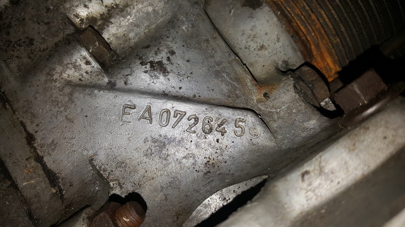

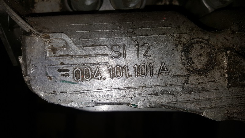

Senior Member ![]() ![]() ![]() Group: Members Posts: 553 Joined: 16-December 13 From: Kingston, Ontario, Canada Member No.: 16,770 Region Association: Canada |
I decided I might as well at least take off one of the heads. No use building up my other engine on the off chance that this one has already been upgraded.
Starting with the serial numbers, what do these indicate? ![]() |

jcd914 The EA engine code means it started out as a 72 or... Nov 27 2018, 10:01 AM
