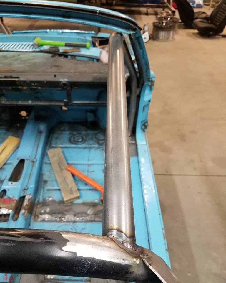

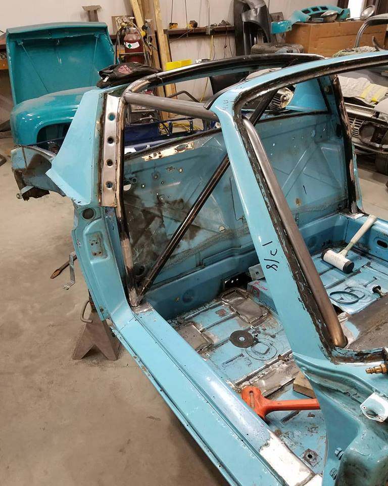

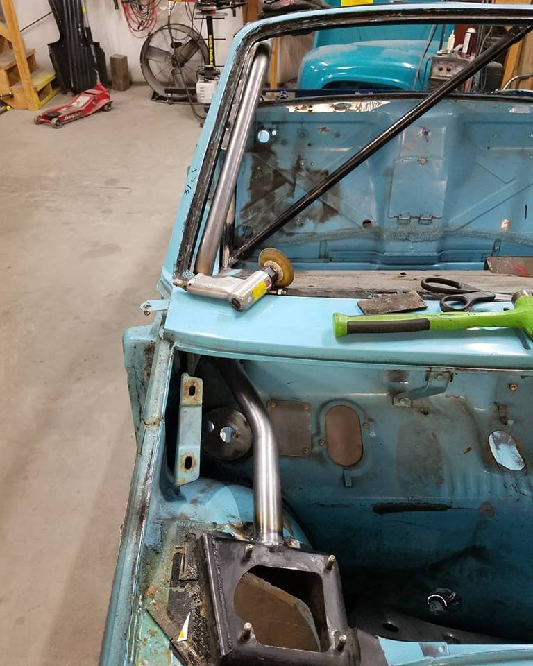

lots of fab work done, and work progressing on the roll cage.
We decided to keep the back hoop in since it was in a good place, no need to replace it.

tygaboy   I've bent a few tubes in building my car and I...   Dec 2 2018, 04:22 PM
jmitro   that's a really great fit you got there! ...   Dec 23 2018, 08:27 AM

Cairo94507   Wow- that is some serious bracing. That car will ...   Dec 23 2018, 06:51 AM
dan10101   Very nice. I'm taking notes and saving pictur...   Dec 23 2018, 08:39 PM
