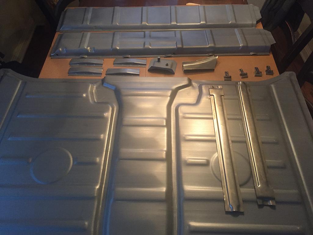

The floor pans and outer longs will be replaced by Restoration Design pieces
shown below:
