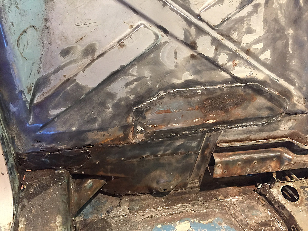

OK, well I had to have a thread title. I am calling it that because it will restore structural integrity to the car and I want to be able to say that the rust has been correctly repaired if I eventually sell the car, unlike the lack of integrity of the person who hid the rust to sell it.
Pictures below
The floor is a little shiny because there is still some mineral spirits on it from trying to get the tar off.
The open areas that you are seeing are after I wire brushed with knotted wire wheels on a grinder, then a carbide burr on a die grinder. While I will take some more off, what you see is getting close to good weldable metal.
First the longs:
The driver’s side is the worst. The bottom edges inside and out were full of holes, or very thin, so I cut the outside of the driver’s all the way off—except I haven’t got to the front under the door pillar yet.
I have cut out about 30 percent of the passenger’s side. The middle section is solid but I will replace it anyway. I started getting a little scared to take more out until I brace up the body.
The floor pan:
There are lots of sloppy welded patches and holes around the seams. The rear passenger’s and rear drivers quarters of the floor pan have been replaced with some plain steel—blue for some reason. The PO welded a solid bar on each side to mount the seat hinges. Sloppy, unground welds abound. There are some rust-through spots at the front of the pan that will need patching, but overall the pan in front of the cross member is solid.
Some patches in the lower firewall are solid.
Measuring diagonally, window frame to targa bar and straight back window frame to targa bar it is off no more than 1/8 inch. This changes depending upon doors open or closed or movement of the jack stands. The door gaps were never problems—maybe the driver’s side was a little wide. So it seems the car is pretty within spec and adjustable doorframe bars should be able to pull—or push—things to be good

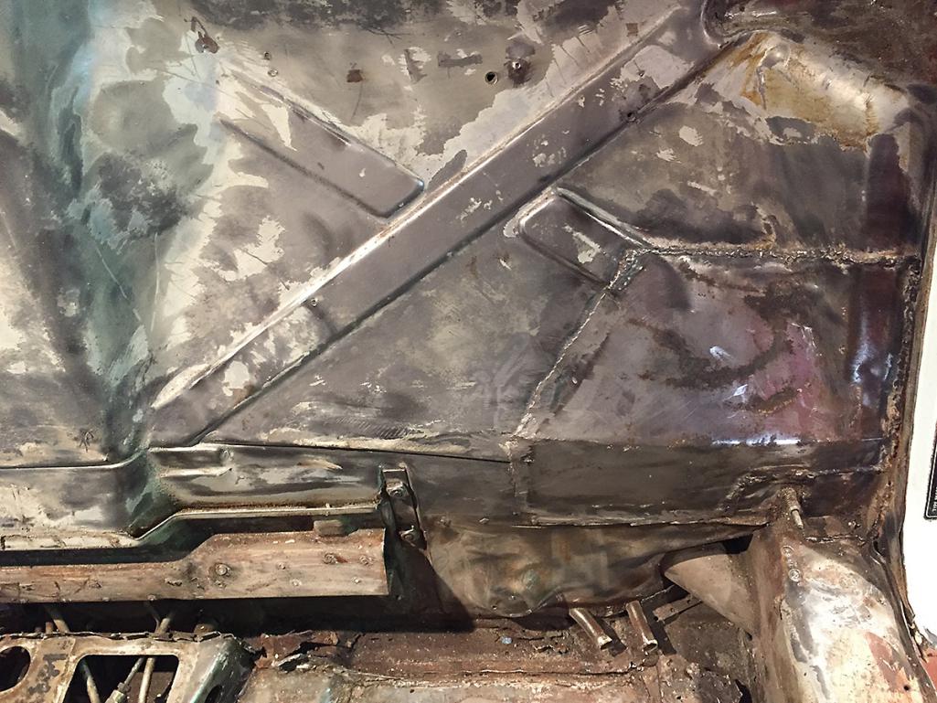

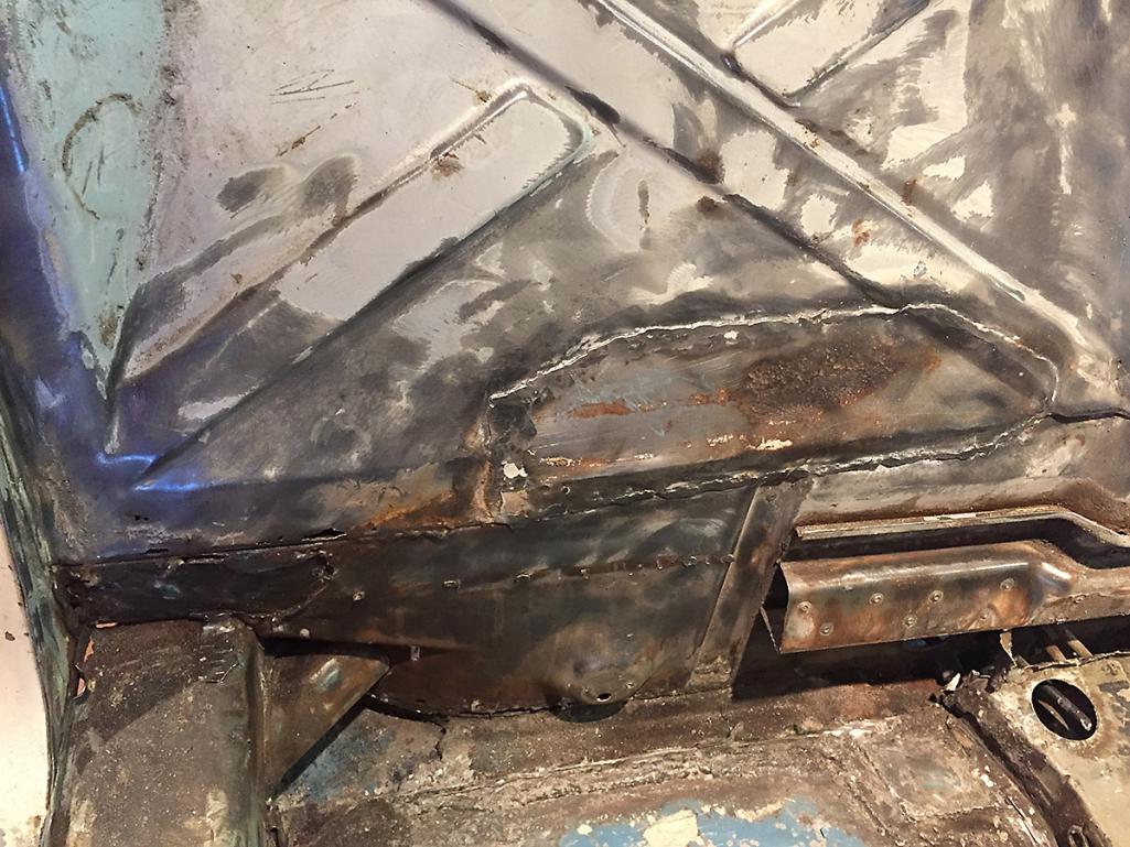

The upper firewall had some sloppy patches, so I got a hunk of firewall from another member and have repaired a couple of small holes and then added the new section into what I cut out.
Photos of the P.O. Patches:

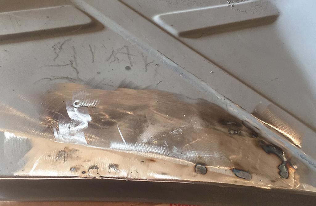

Other Side:

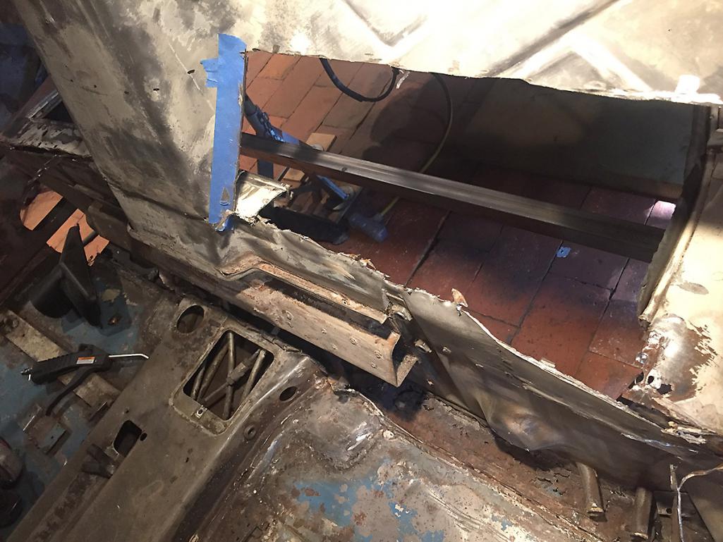

Then I braced and the chassis and cut out a hunk of upper firewall:

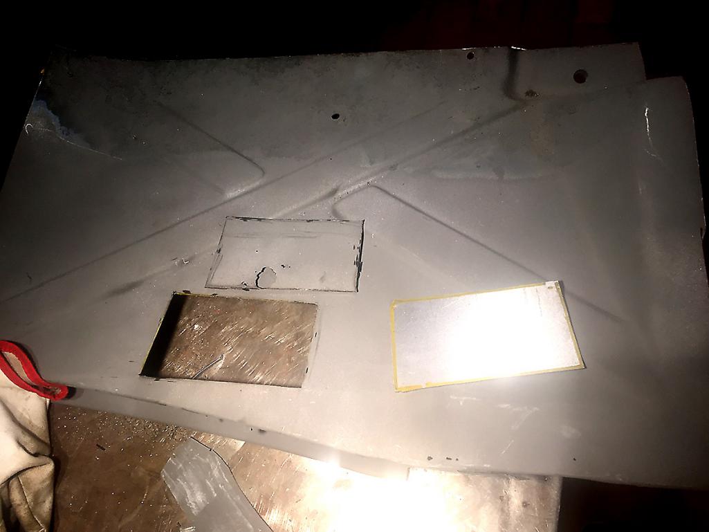

Then I made some minor patches on the "new"hunk of firewall:

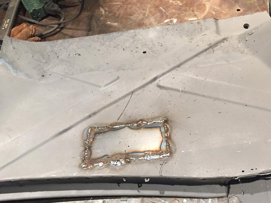

Excuse the sloppy welds:
Ground:
My welding has improved a lot since then, I was using my old Lincoln. I bought a Hobart Handler MVP and it has made quite a difference for me.
