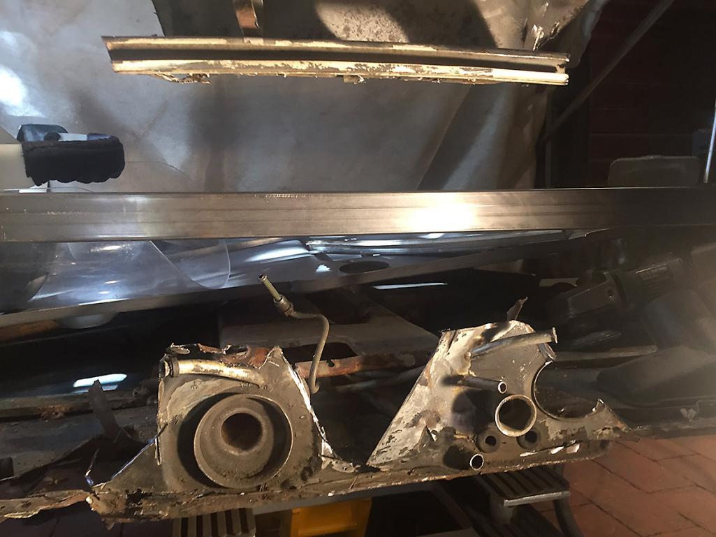

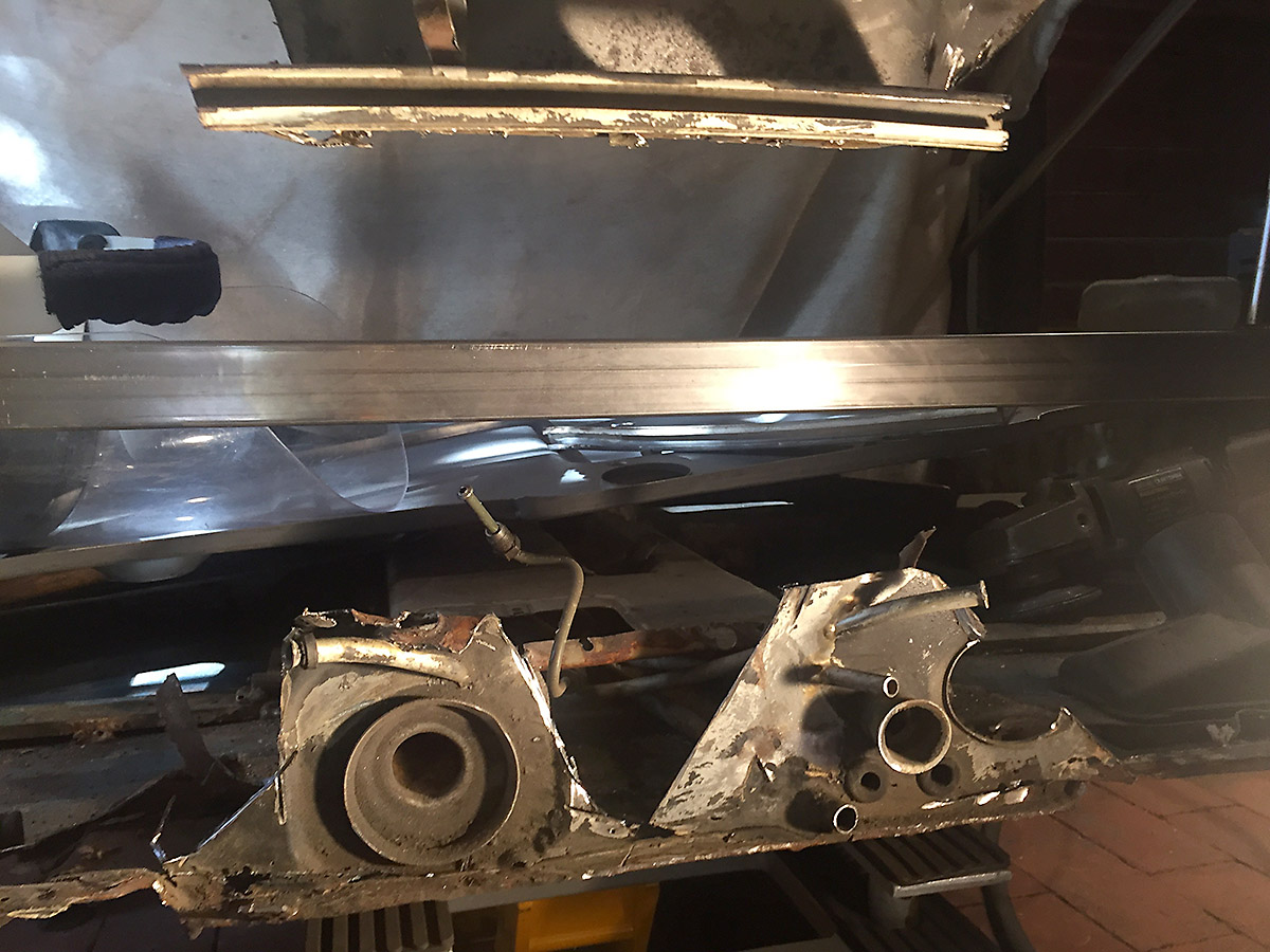

The driver’s side is the worst. The bottom edges inside and out were full of holes, or very thin, so I cut the outside of the driver’s all the way off—except I haven’t got to the front under the door pillar yet.
I have cut out about 30 percent of the passenger’s side. The middle section is solid but I will replace it anyway. I started getting a little scared to take more out until I brace up the body.

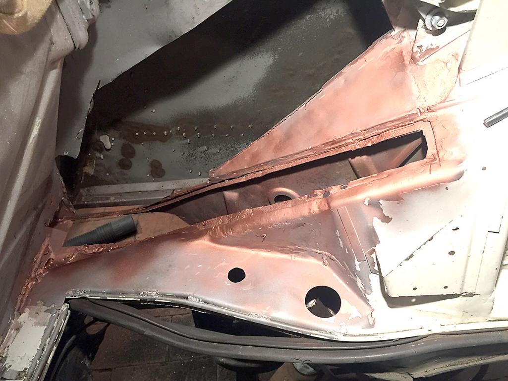

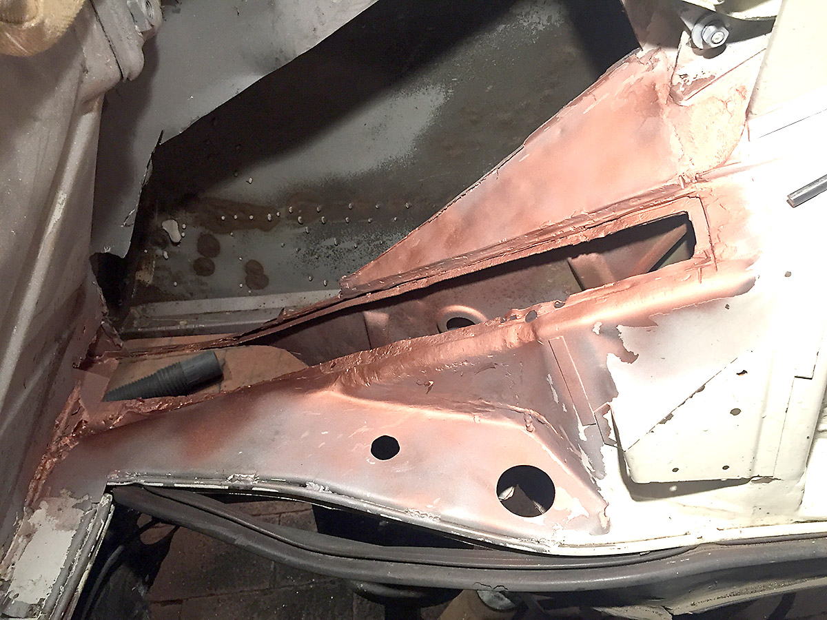

As you can see from the above patch photos the lower inner and outer firewall were trashed so I cut them out and have new RD pieces going in.
The hellhole and area around it had been repaired badly by a P.O.
Lap welds all around. I cut it all out and replaced with part of an inner wheelhouse from AA (RD was out of stock on the part) and a patch piece I made.
The color is from the Upol copper weld-through primer
I will have to find a picture of the area with the repairs done
