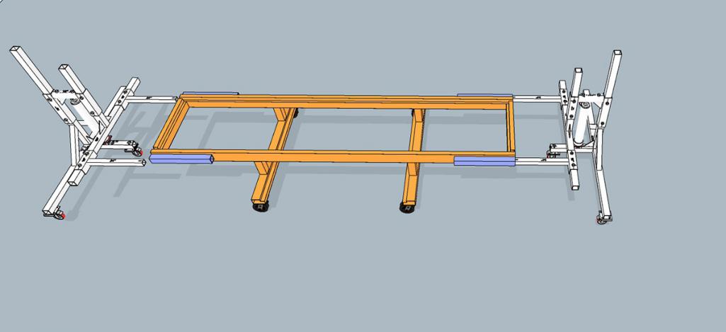

I decided that the easiest way to work on the car was going to be on a dolly—to keep it rigid, or a rotisserie to allow easy access.
I emailed back and forth with Jeff Hail a bit who was a great help—Thanks Jeff!
I couldn't decide which to do so I did both. I came up with an idea to build a dolly frame for the car out of pallet rack shelving and make it so I could mount the dolly/car on the Rotisserie.
Here is the idea I came up with:
Basically, build a dolly and weld trailer hitch tubes on each corner to receive the arms of the rotisserie.

amfab   Thanks Dion, I ended up having the 993 repainted....   Dec 5 2018, 09:04 PM

bbrock   Fantastic work. I absolutely LOVE that dolly-roti...   Dec 6 2018, 01:52 PM
amfab   Fantastic work. I absolutely LOVE that dolly-rot...   Dec 8 2018, 09:52 PM

amfab   Dollisserie I like that. Maybe its my fondness fo...   Dec 9 2018, 08:18 PM
bbrock   Yeah, in addition to heat, they eat a lot of metal...   Dec 9 2018, 08:55 PM
amfab   Yeah, in addition to heat, they eat a lot of meta...   Dec 9 2018, 09:05 PM
