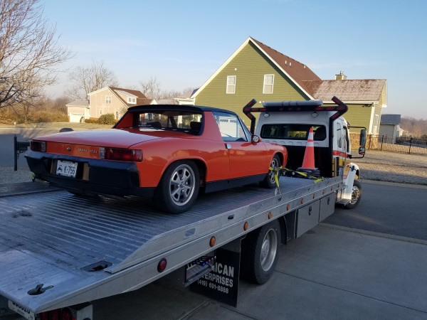

Anyway, time is now up, and she is off to the clinic:
Will let you guys know what they find.
