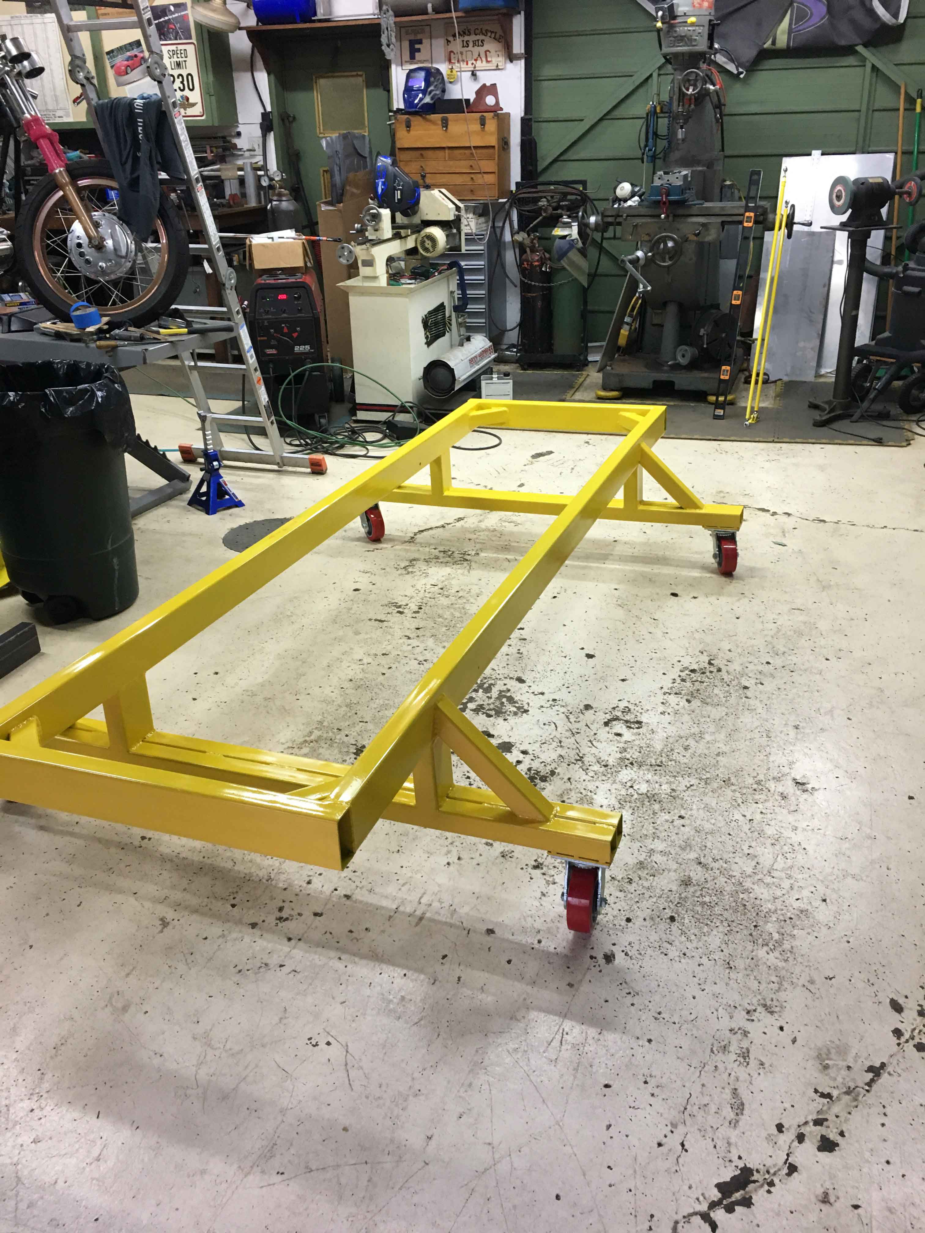

With a new found 914 where else would I go but to the interwebz and I promptly found 914World! Much nicer than the old school 914 newsletters I used to have to subscribe to.
(IMG:style_emoticons/default/cheer.gif)
Everything you could ever want to know about 914's at your fingertips all on one place. At least this internet is good for something.
Basic Plan:
1) Find someone that has done it before
2) Follow their advice
I eventually found Jeff Hail's post on Bringing Out the Dead. Wonderful stuff and top level craftsmanship. It is so rare in these days to find someone so willing to share his skill and knowledge. I spent many hours reading that thread and many others on the site and I finally settled on a course of action. . . . copy Jeff!
http://www.914world.com/bbs2/index.php?showtopic=76791
Jeff's posts are so elegant and to the point. And to top it off he offered up a "blueprint" for his build cart.
So I copied it . . . (IMG:style_emoticons/default/welder.gif) ruthlessly . . . . down to the paint color. Yellow makes perfect sense to me. Leave it raw, and it rusts. Paint it black and you'll surely smack your head on it having not seen it out of the corner of your eye.
