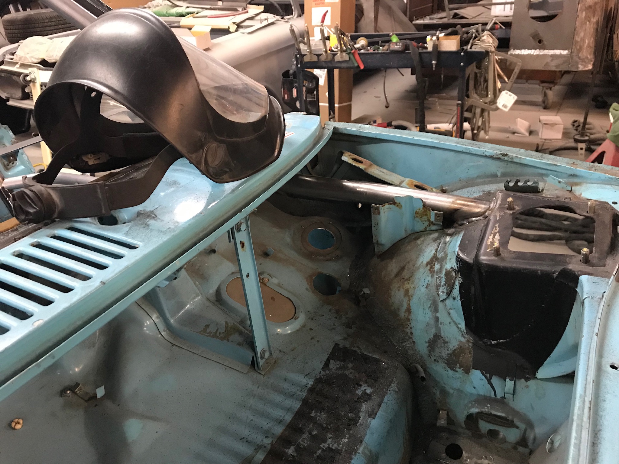

So while everything is out, I figured it was a good time to fix all the damaged fiberglass body panels, fix the newly found crack in the chassis, strengthen and reinforce everything, tie suspension points to the cage, re-route hoses and lines to be cleaner, redo some of the wiring, add lightness where I can, fix the roof (came flying off at Road Atlanta and cracked it), etc. etc. etc. Essentially tear it down to bare chassis. Then media blast the whole thing (fix any rust spots we might find), powder coat, paint or wrap what needs what, and reassemble...hopefully before our first track event in March!!

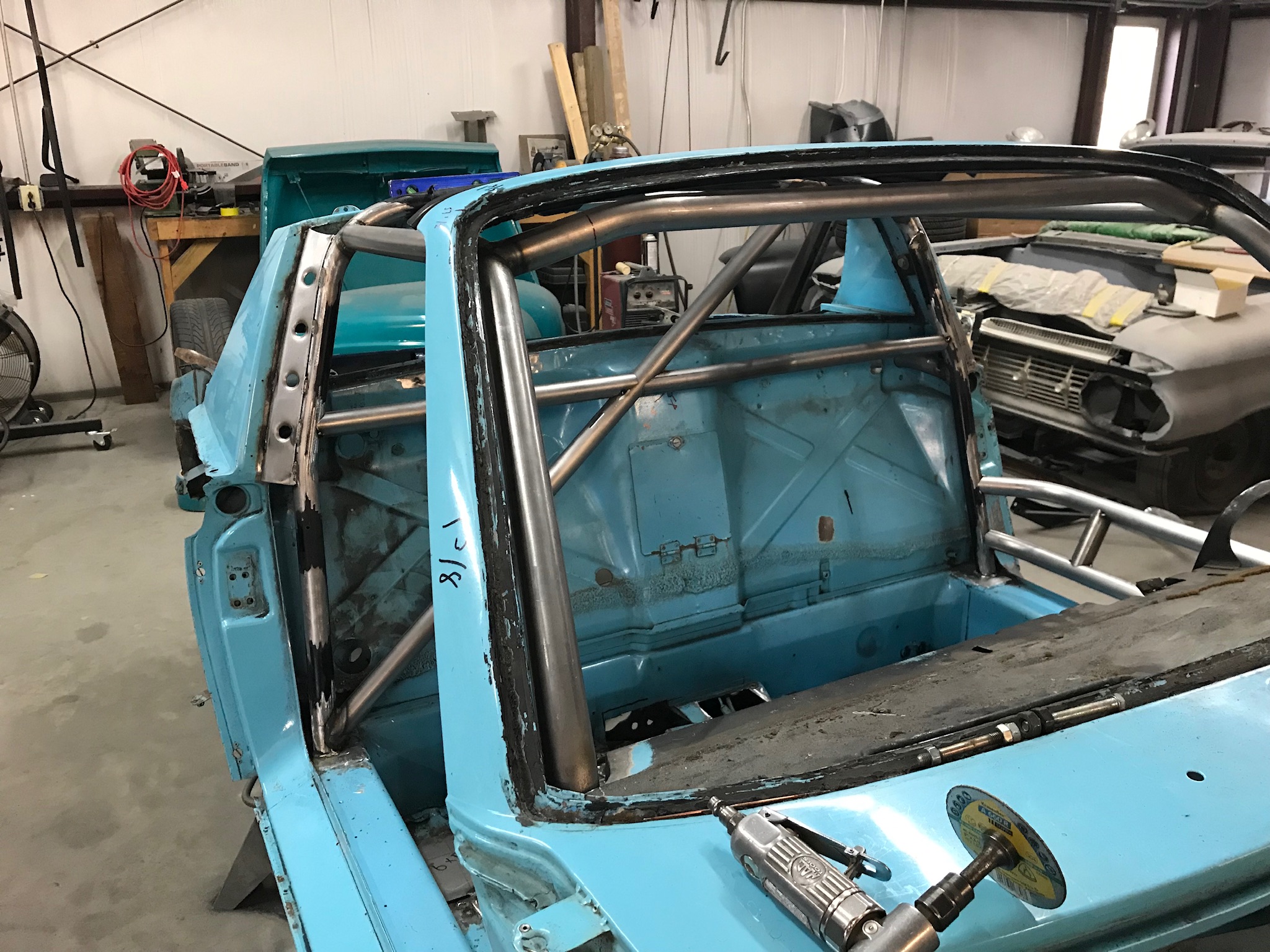

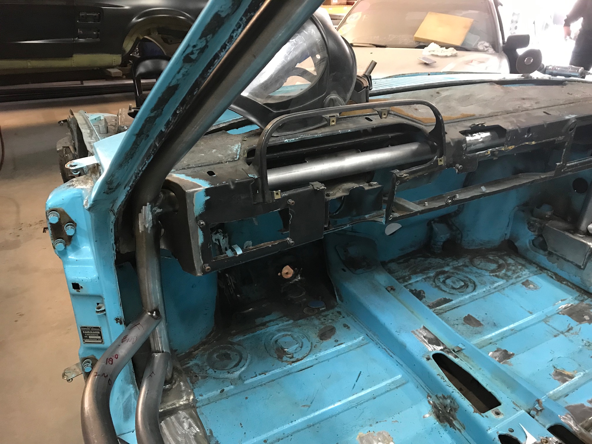

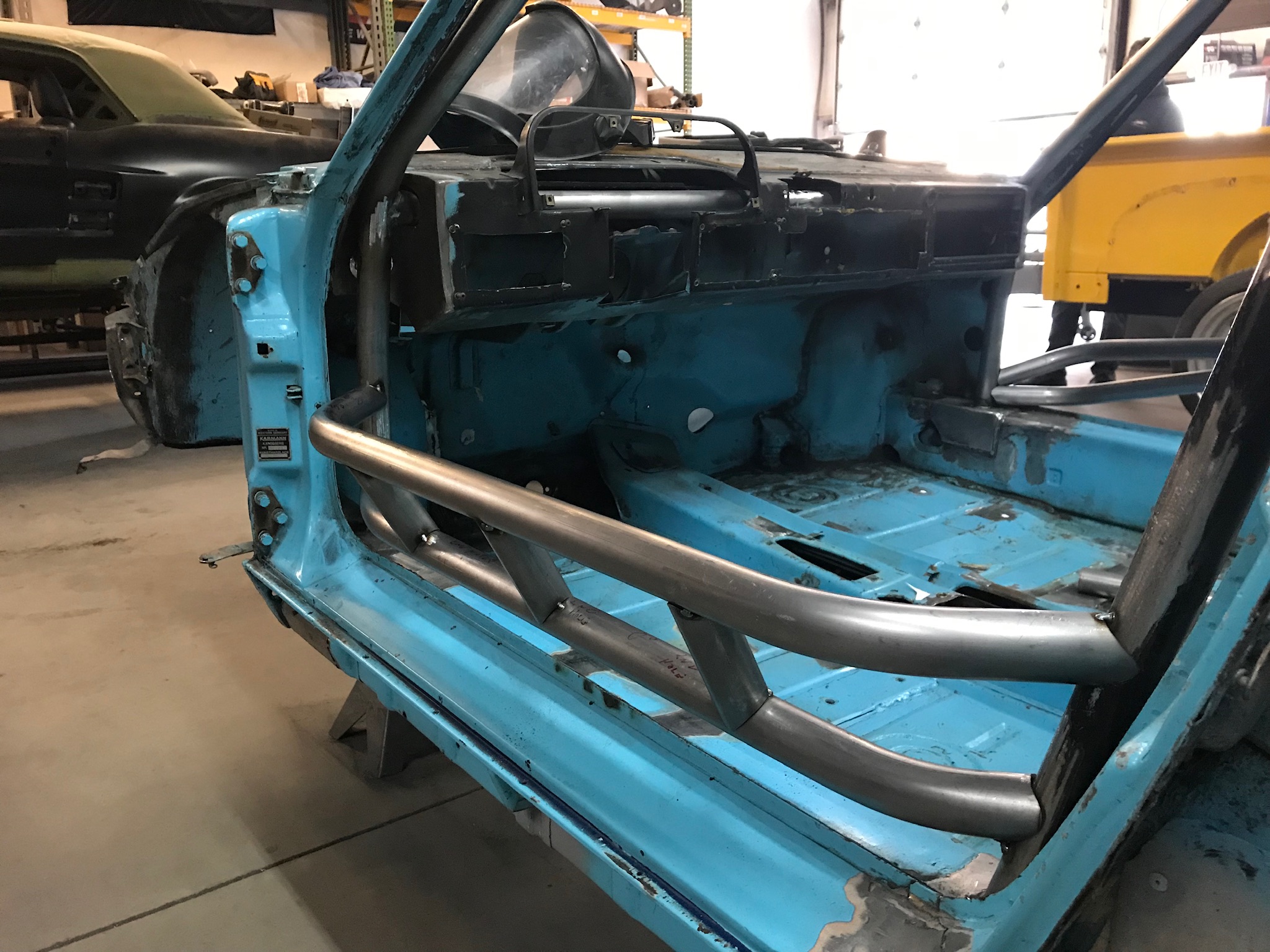

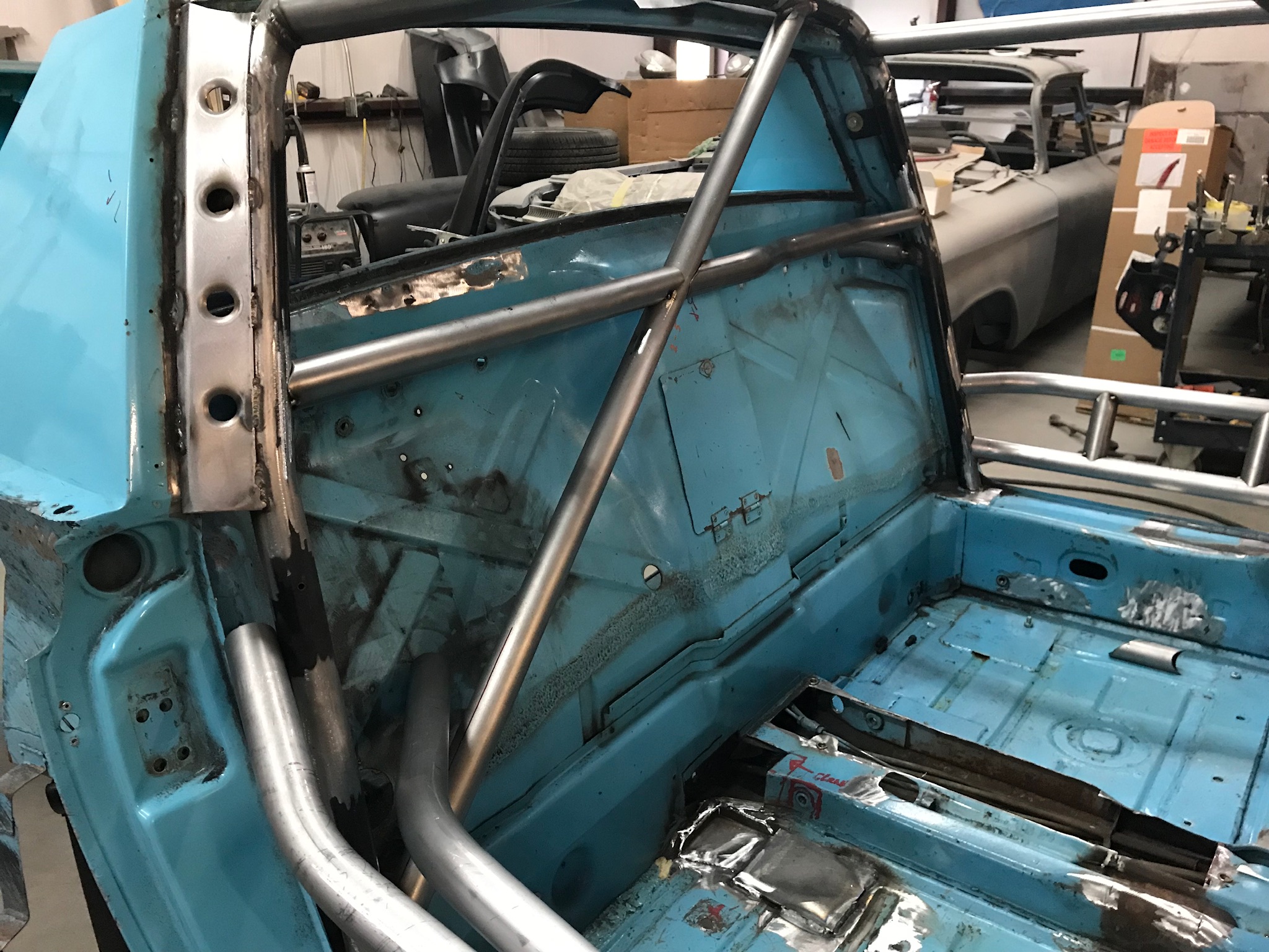

As of last I saw it (4 days ago), all the chassis repair work had been done, the Tangerine Racing rear shock towers welded in, cage is MOSTLY done except the passenger door bars. Dash bar is done, horizontal and angled bar behind seats are done, tying into the shock points is done, etc. Lots of the parts are tacked in for fit though by the time I typed this they are probably done.

tygaboy   I've bent a few tubes in building my car and I...   Dec 2 2018, 04:22 PM
jmitro   that's a really great fit you got there! ...   Dec 23 2018, 08:27 AM

Cairo94507   Wow- that is some serious bracing. That car will ...   Dec 23 2018, 06:51 AM
dan10101   Very nice. I'm taking notes and saving pictur...   Dec 23 2018, 08:39 PM
naro914   Cage is pretty much done, just some minor braces. ...   Dec 28 2018, 02:57 PM
GeorgeRud   Glad to see the Nascar styled side impact bars - m...   Dec 28 2018, 03:20 PM
naro914   Glad to see the Nascar styled side impact bars - ...   Dec 31 2018, 01:25 PM
horizontally-opposed   Glad to see the Nascar styled side impact bars -...   Jan 3 2019, 01:08 PM
