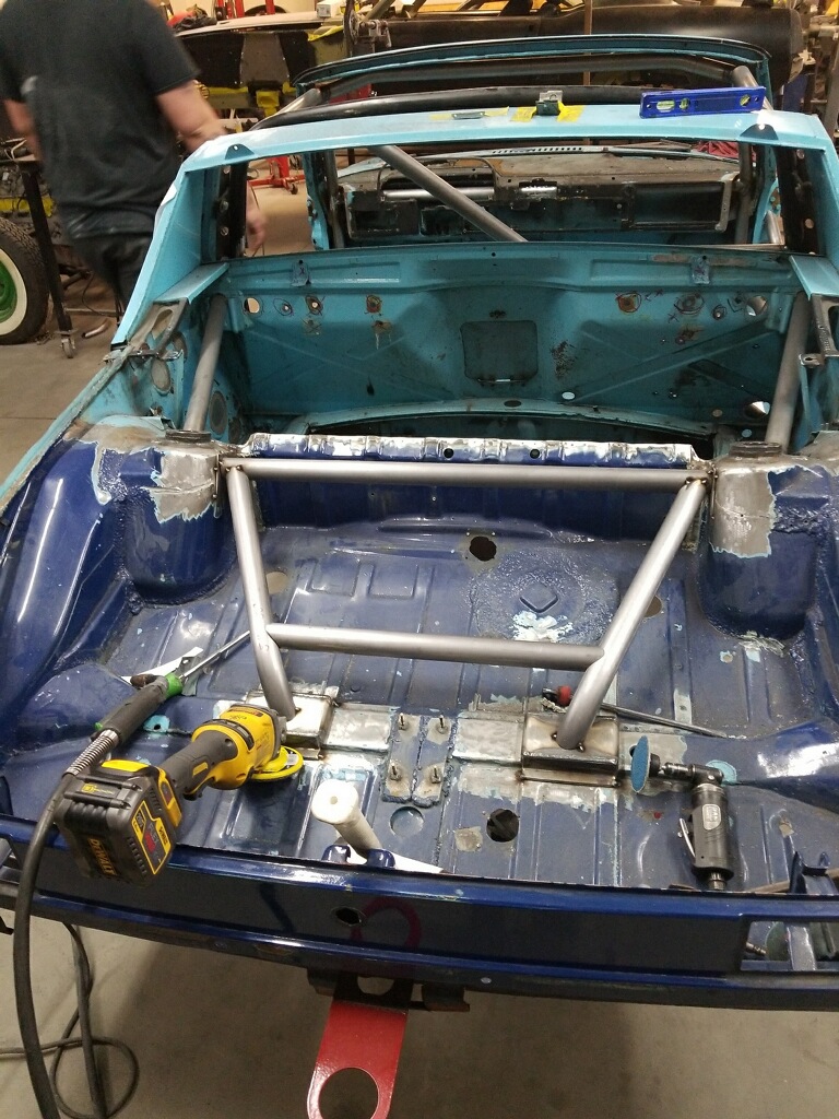

naro914   lots of fab work done, and work progressing on the...   Dec 2 2018, 12:15 PM
tygaboy   I've bent a few tubes in building my car and I...   Dec 2 2018, 04:22 PM
jmitro   that's a really great fit you got there! ...   Dec 23 2018, 08:27 AM

Cairo94507   Wow- that is some serious bracing. That car will ...   Dec 23 2018, 06:51 AM

naro914   Cage is pretty much done, just some minor braces. ...   Dec 28 2018, 02:57 PM
GeorgeRud   Glad to see the Nascar styled side impact bars - m...   Dec 28 2018, 03:20 PM

Joemo5   I'm really fond of the way the roll hoop and t...   Feb 3 2019, 09:31 AM
