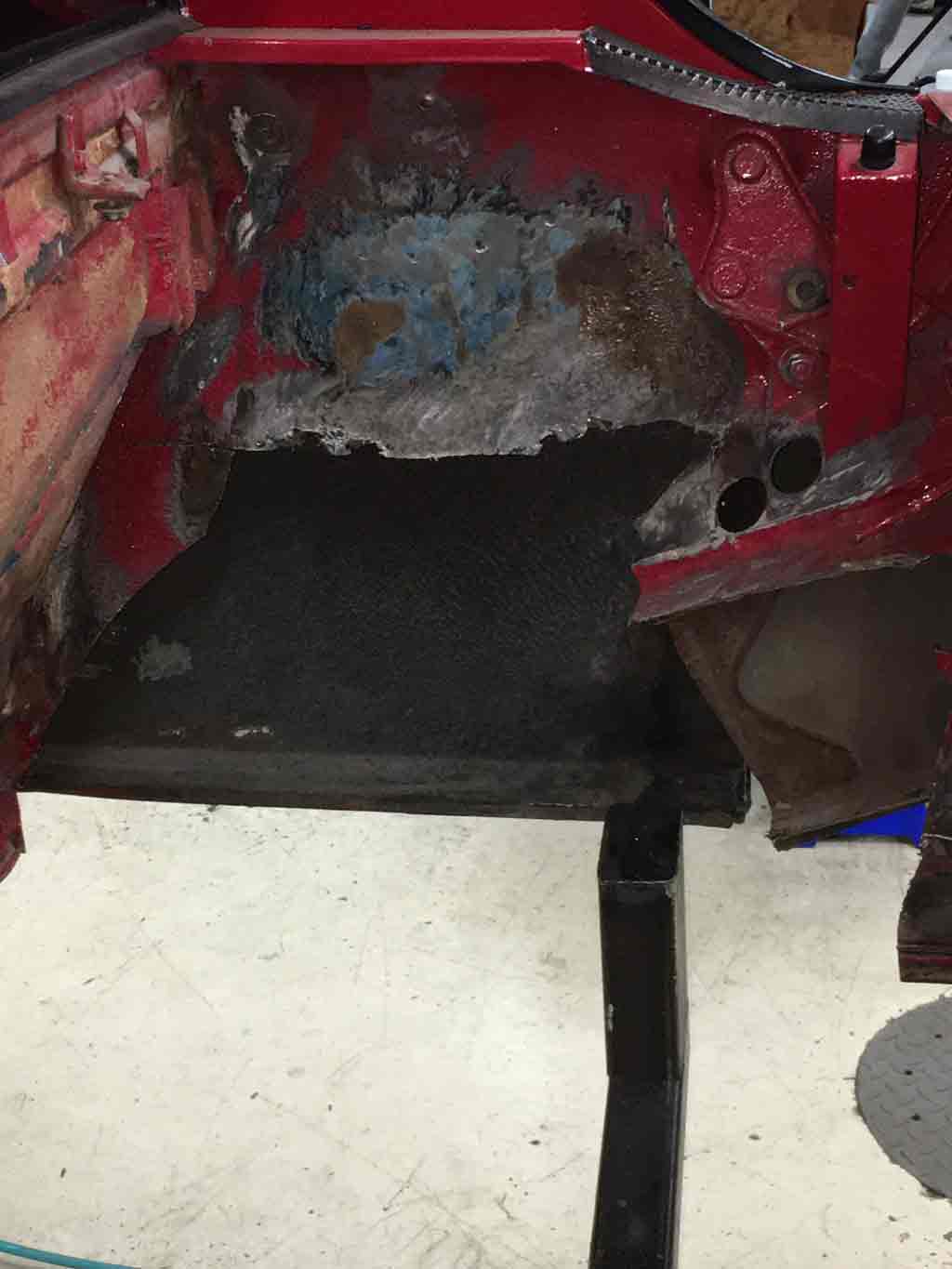

Here is what is lurking underneath once the rockers came off.
and when I started cutting back the rust. Oh my . . . .

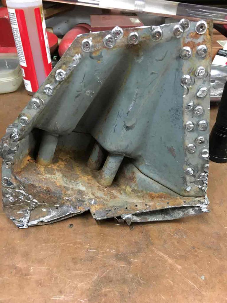

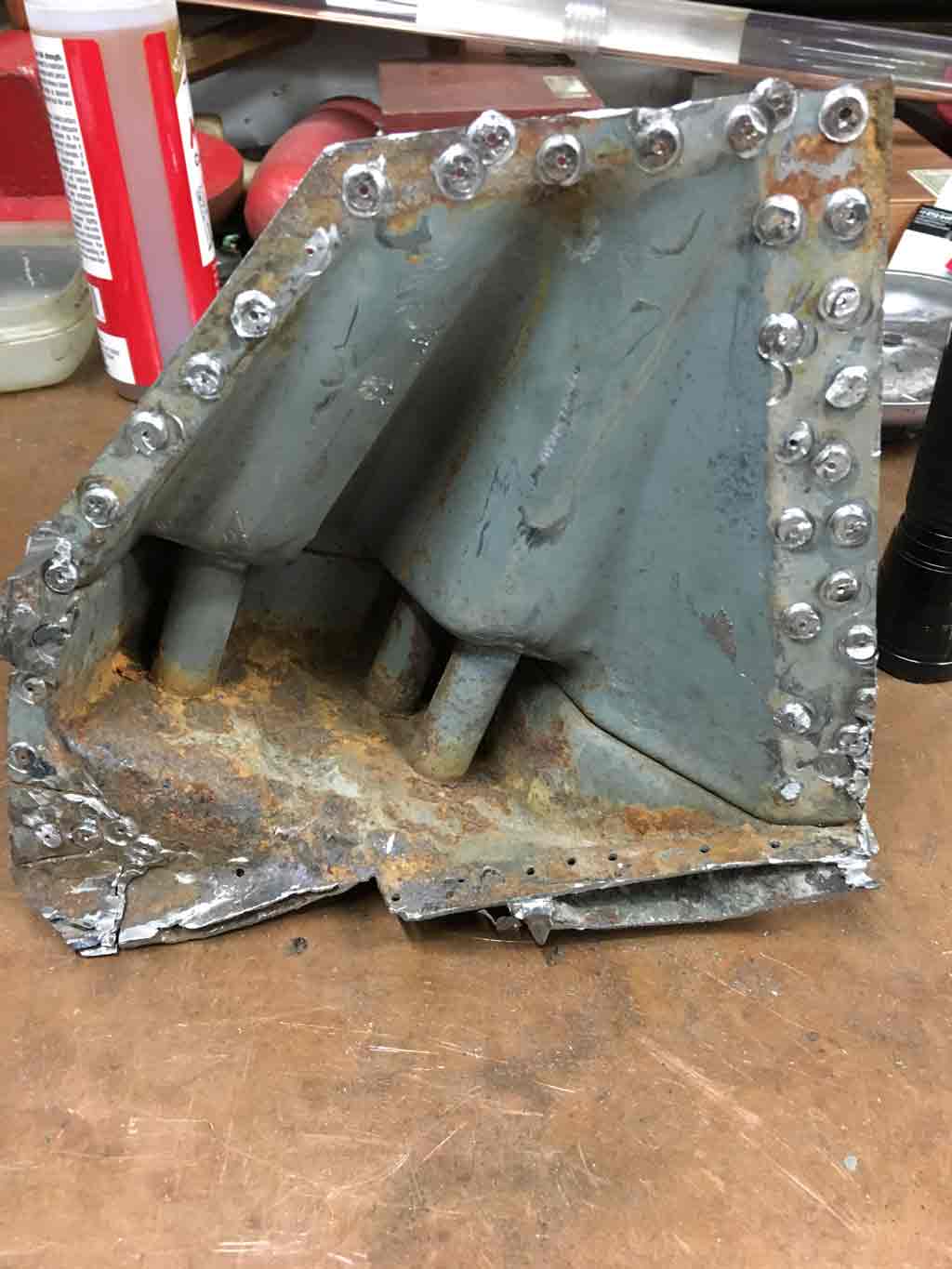

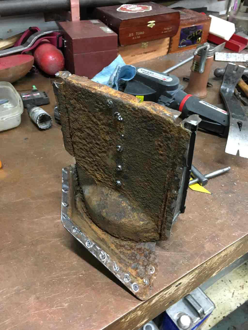

Also did some more removal of the rear frame & inner wheelhouse.
I can see that drilling spot welds is really going to be a re-occurring theme.
I can't believe how many spot welds are on the outer suspension console for the trailing arm. This is in addition to some factory MIG welds.
Pretty much the same story for the engine mount but with even more factory MIG along the outer perimeter.
Honestly, it took the better part of the day just to get these two pieces of sheetmetal freed up for recycling. Sure wish that new metal was available.

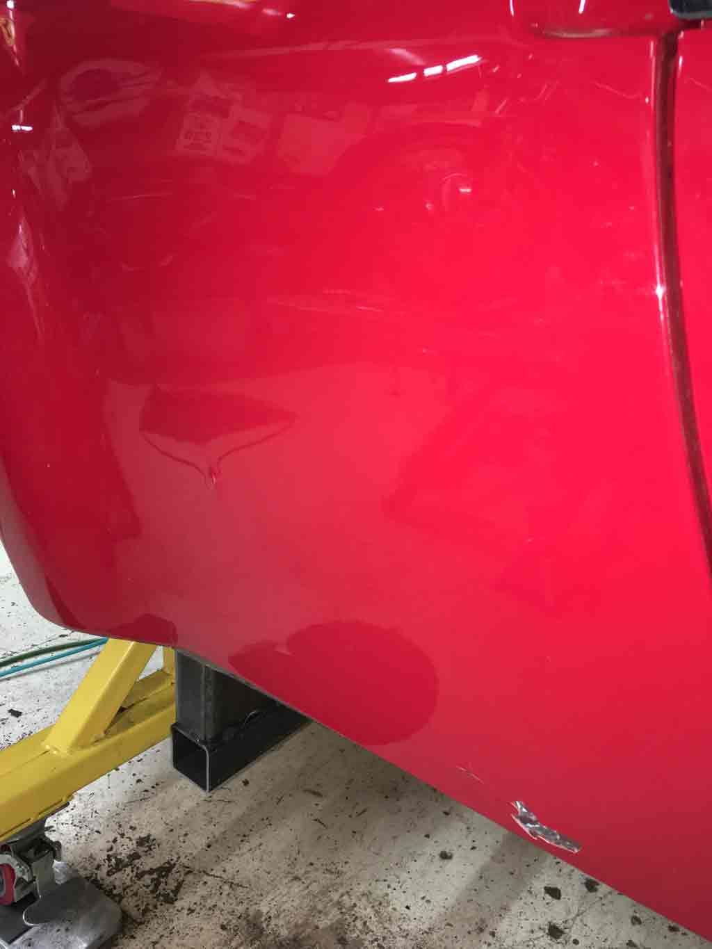

Just about the time I was thinking I was doing OK for the day, I got a little surprise. Turns out that during the demo of the frame, the saw blade had banged the rear fender from the inside -- totally buggering the paint.
This was a bit of a let down. Since the paint on the car is in very nice shape I've been trying to avoid cutting out a piece of the rear fender to allow easy access to the frame / console area like so may others have done.
I thought I had been careful. Nope. (IMG:style_emoticons/default/headbang.gif)
I think I'll still try not to cut out this section of rear quarter. At this point it is still easier to do a small paint repair than to deal with cutting into the quarter and having to deal with the fiberglass flares. Welding on the sheetmetal with the fiberglass is going to be a big problem that will likely force me to remove a portion of the flare, weld, and then have to reinstall the flare. Not a fun prospect.
Worst case . . . . paint will be hard to match. I had hoped to contain the re-spray to the door jambs and the engine compartment.

injunmort   to fill pits in rocker covers, try boiler cement. ...   Apr 29 2019, 04:33 AM
Superhawk996   @Tenner [b]Looks like nice work. You most defin...   Apr 29 2019, 04:44 AM
bbrock   @[url=http://www.914world.com/bbs2/index.php?show...   Apr 29 2019, 08:11 AM
injunmort   brake piston   Apr 29 2019, 10:18 AM
Superhawk996   brake piston Good guess . . . but it would ha...   Apr 29 2019, 11:40 AM
