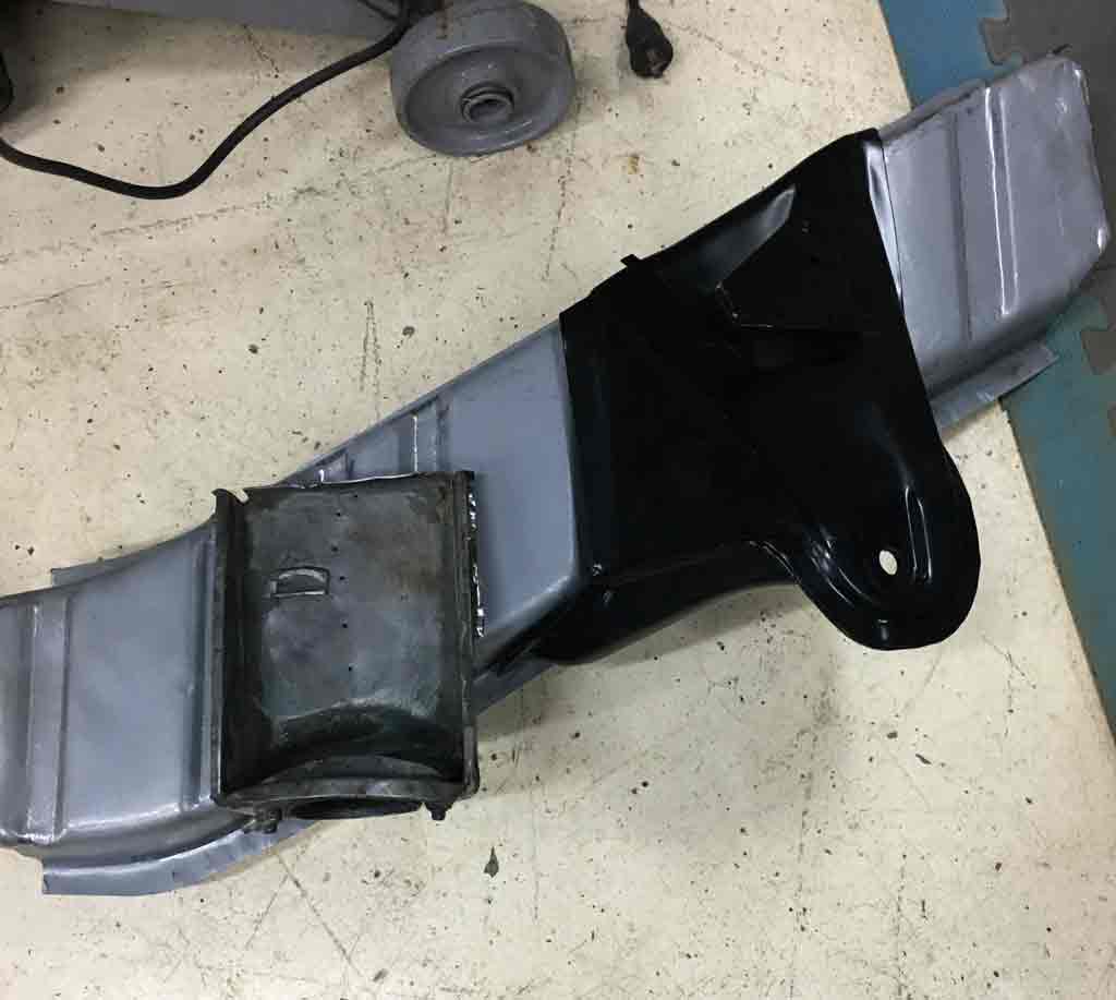

Superhawk996   The trailing arm mount on my car came with one of ...   Jan 19 2019, 12:34 PM
euro911   I drill two holes in the bottom of each jack point...   Jan 19 2019, 04:44 PM
Superhawk996   I drill two holes in the bottom of each jack poin...   Jan 26 2019, 10:11 AM
Superhawk996   :headbang: Having a rough go of getting the trai...   Jan 26 2019, 10:32 AM
Superhawk996   Also picked up some front brake calibers from PMB ...   Jan 26 2019, 10:47 AM
Superhawk996   Update on the trailing arm mount madness: Laser p...   Jan 30 2019, 09:59 AM

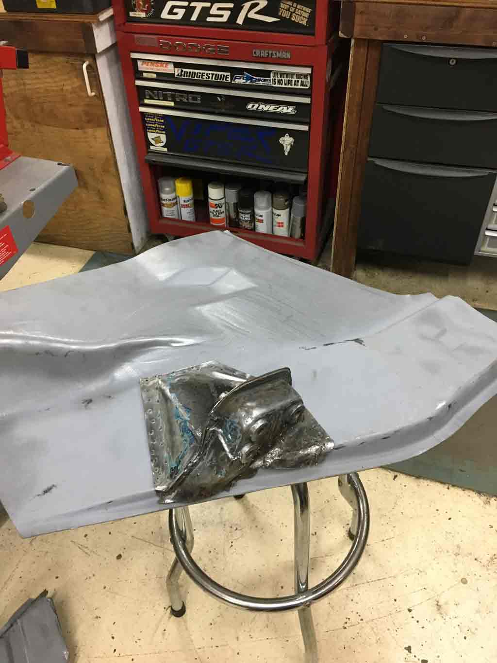

Superhawk996   Photo of passenger side donor sheet metal rough tr...   Mar 17 2019, 11:45 AM
