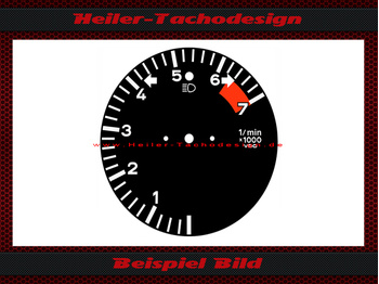

Tony,
What would it take to reset the Zero & 6K positions like this (with Zero at 6 O'clock position)? Thanks, Danny @Retroracer ![]() |
