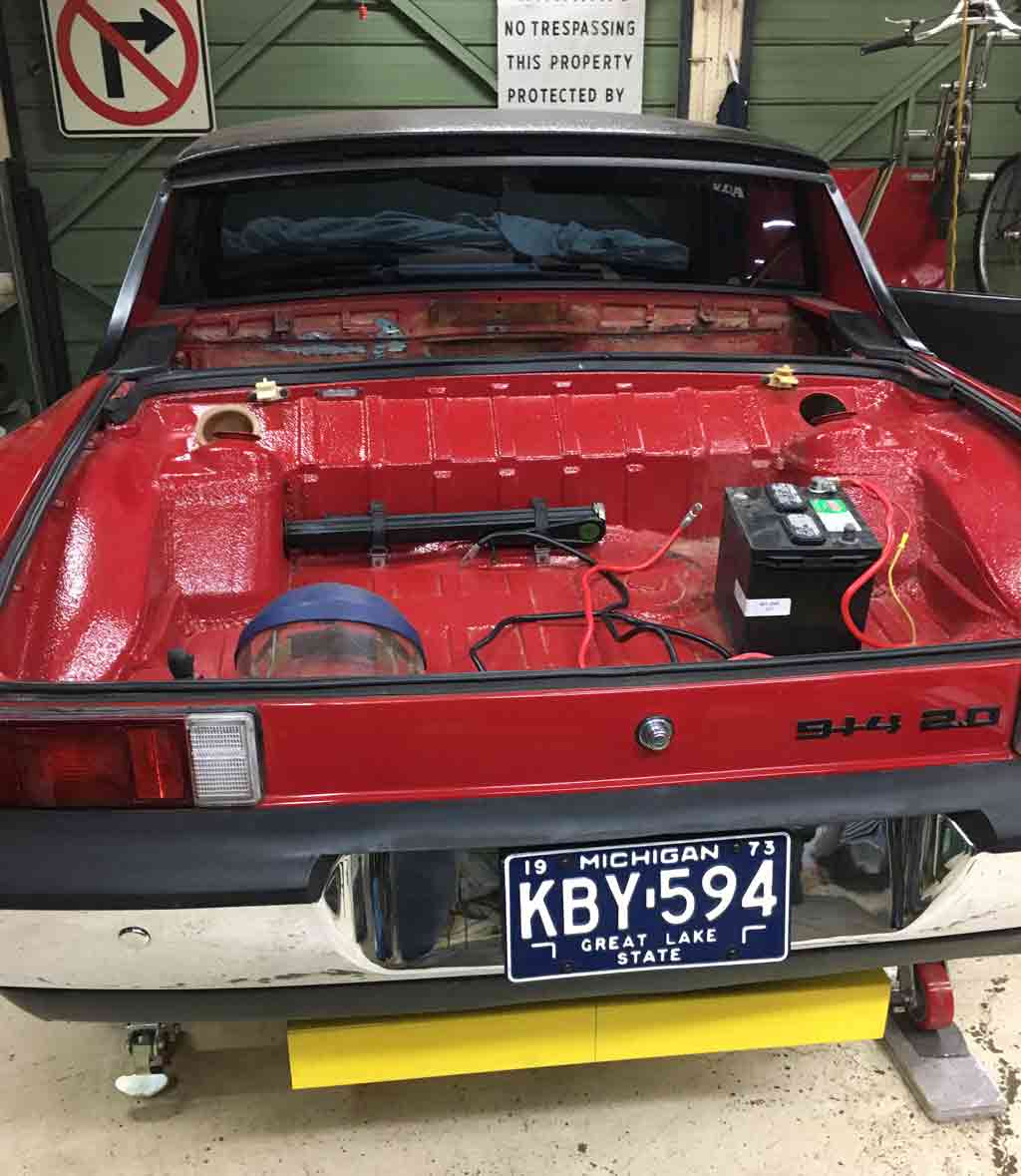

Also a reminder that I need to move the battery to the frunk! Previously was crudely mounted in the trunk and taking up too much area in that already limited space. Plus I prefer the weight to go up front like I had it in my 1st 914.

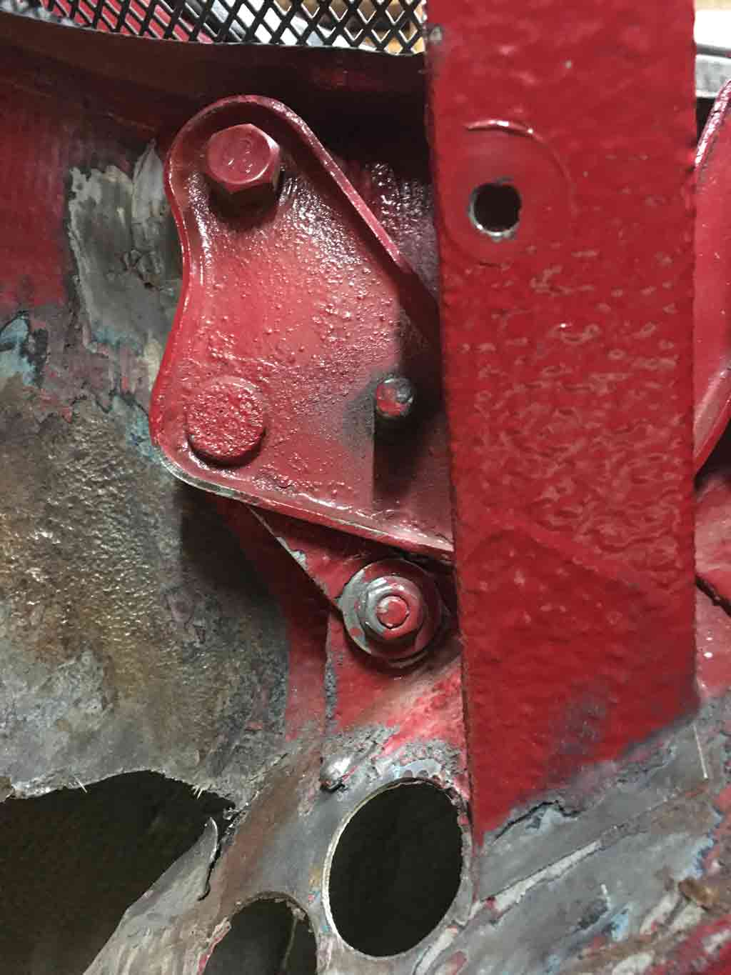

2) Repair the trunk hinge brackets. Although not broken off they were welded in with snot welds and look like they will eventually break. Even if they don't break I don't want someone to think I welded them!.
3) Upon removal, I discovered that the proper hinge bolts are long gone. Replaced with a 10 mm threaded bolt that is enlarging the bracket hole each time the trunk is opened. So the bright side is that I found this out before they broke! New brackets will address #2.

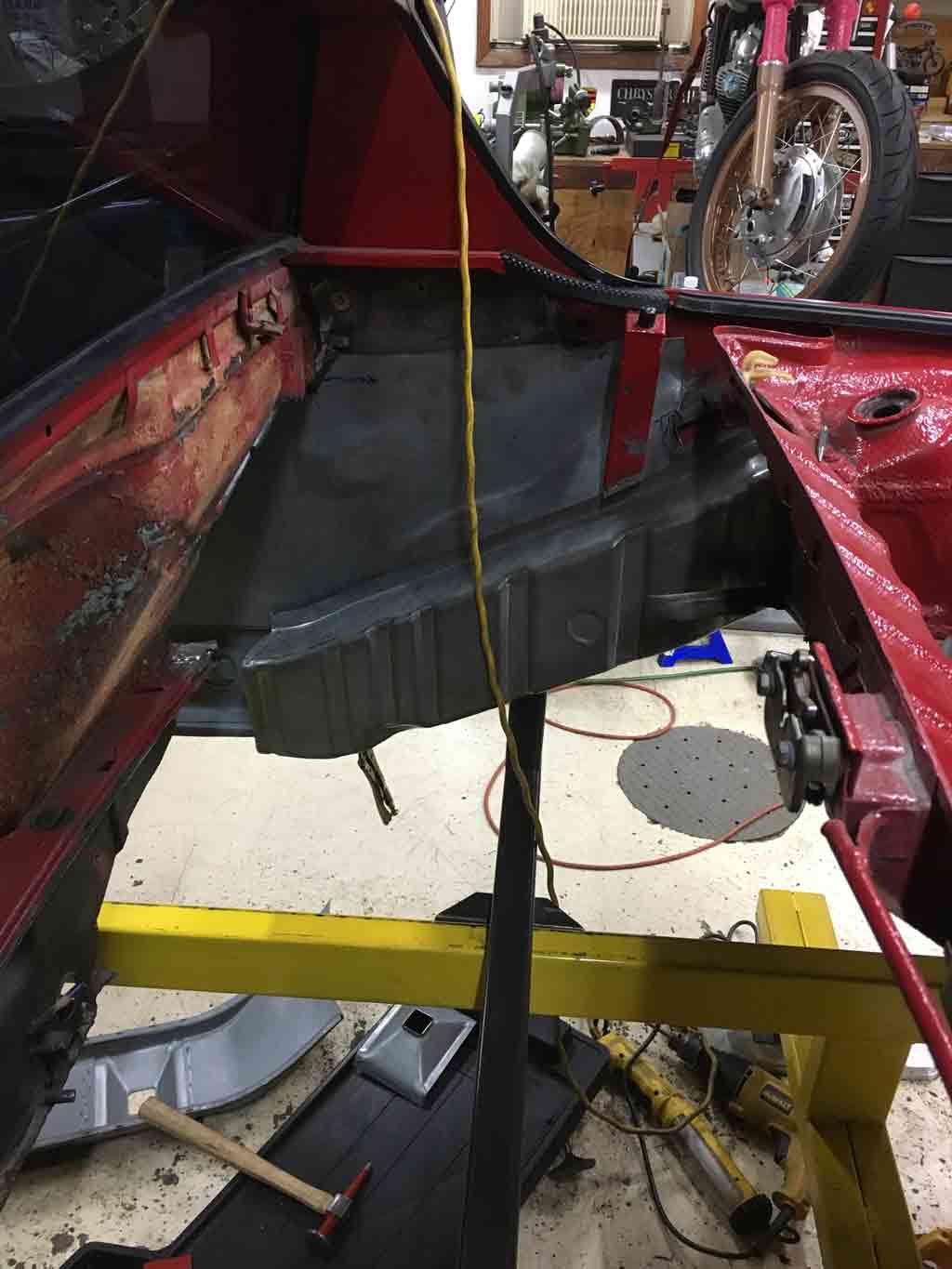

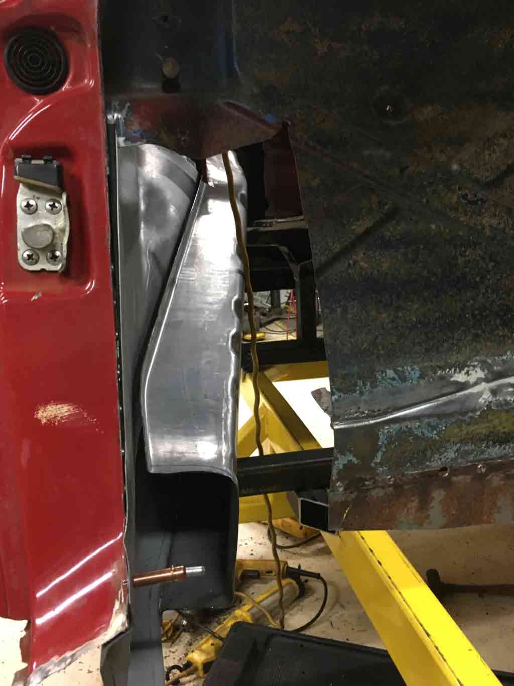

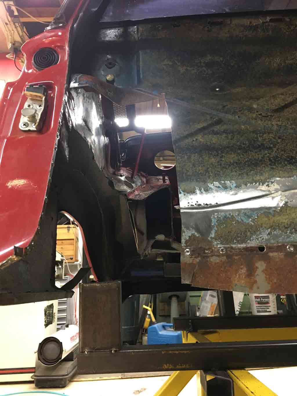

Got around to cutting the firewall to gain access to the Hell Hole to install the wheelhouse inner. More spot welds and cutting. (IMG:style_emoticons/default/sawzall-smiley.gif)
Spent the better part of two days getting this far. I think I was in for about 4 hours just to rough fit the inner frame rail. The way it fits up the the front of the trunk is tricky. Had to spend a lot of time reworking of the frame rail flanges to get it to fit right.
The one thing that bothers me is this frame section is corrugated. The original is two layers of steel. Inner is corrugated but the outer is smooth.
I think I'm probably going to have to fabricate a 0.030" (ish) outer layer to smooth out the appearance of this. Ideally, I'd like the rail to look OEM. May be too much work. Time to think that one over for a while. Open to suggestions if someone else has traveled this road. (IMG:style_emoticons/default/idea.gif)
Lots of rough mock up to figure how how stuff will fit and what the best assembly sequence will be.
