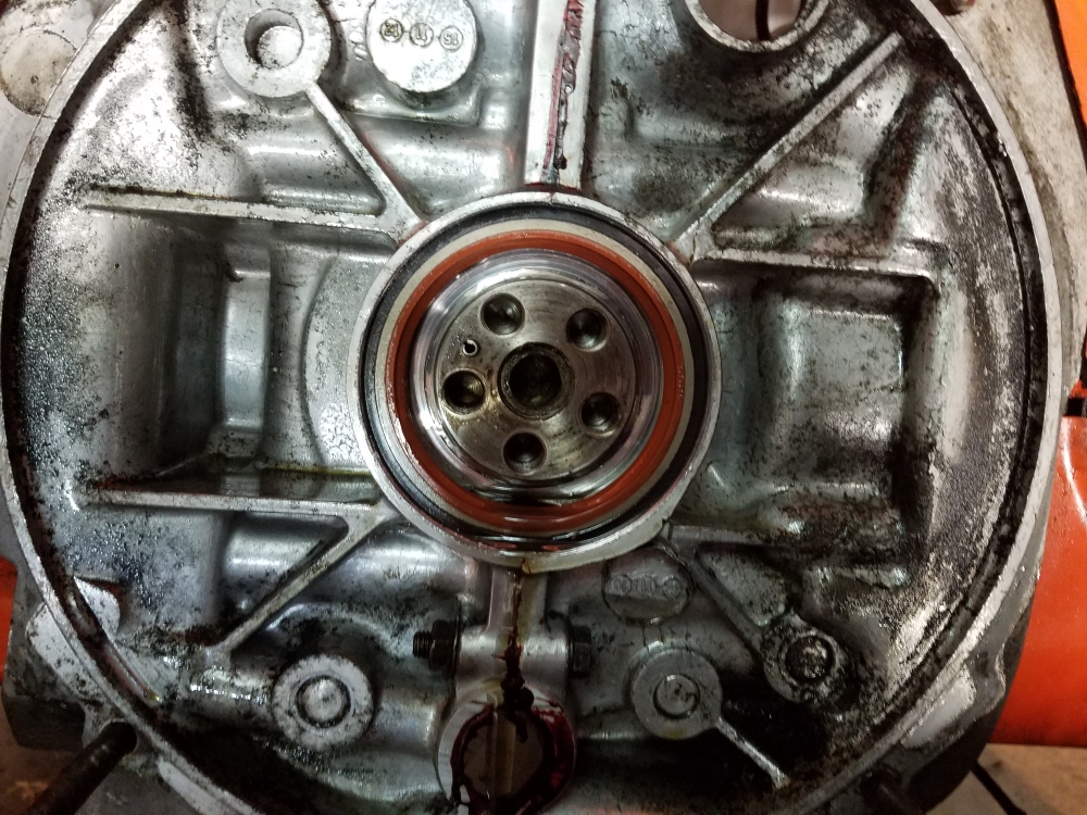

Finally got time to get the transmission off and removed the main seal tonight. Definitely seemed to be leaking from there:

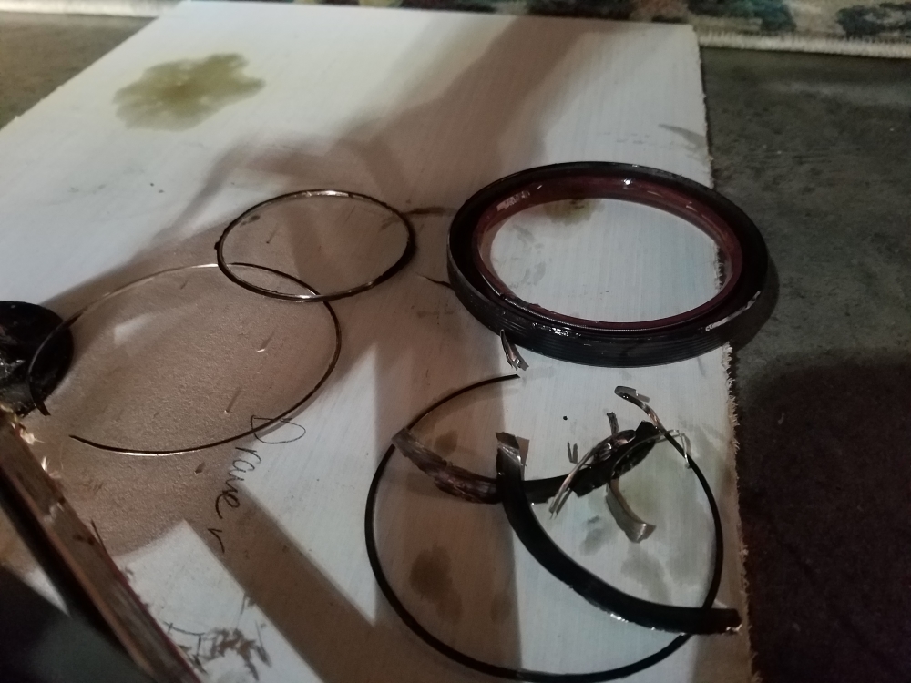

Removed the seal and bunch of scrap metel filaments fell out. I was expecting to find some end-play shims in there, is this whats left of those? Shouldnt they be wider (when intact)?

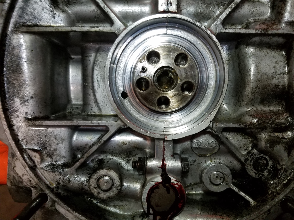

and final shot once everything is removed. Clutch is still clean of oil and flywheel seems fine. Have not found felt washer in there either. I bought everything to do the seal, but I guess I am going to need shims now...
What can you guys make of all this? Thanks for input everyone.

injunmort   there are no shims behind the seal. that's wha...   Dec 30 2018, 07:46 PM
wndsrfr   there are no shims behind the seal. that's wh...   Dec 30 2018, 08:01 PM
914_teener   there are no shims behind the seal. that's wh...   Dec 31 2018, 12:21 PM
ericoneal   It must be shim remains because the seal spring is...   Dec 30 2018, 08:12 PM
914_teener   It must be shim remains because the seal spring i...   Dec 31 2018, 01:59 PM
injunmort   if that is in fact shim remains, it was installed ...   Dec 31 2018, 01:05 PM
ericoneal   Hard question to answer. I dont know where the sh...   Dec 31 2018, 01:22 PM
injunmort   I am going to pull the flywheel off another motor ...   Dec 31 2018, 01:46 PM
injunmort   this engine has three shims behind the oil seal. I...   Dec 31 2018, 02:13 PM
ericoneal   Yeah, I'm with you on all of that. Just conce...   Dec 31 2018, 02:45 PM
injunmort   install the flywheel. measure endplay and order 3 ...   Dec 31 2018, 03:41 PM

cgnj   That doesn't look like enough material for 3 s...   Jan 1 2019, 10:37 AM
wndsrfr   That doesn't look like enough material for 3 ...   Jan 1 2019, 12:17 PM
