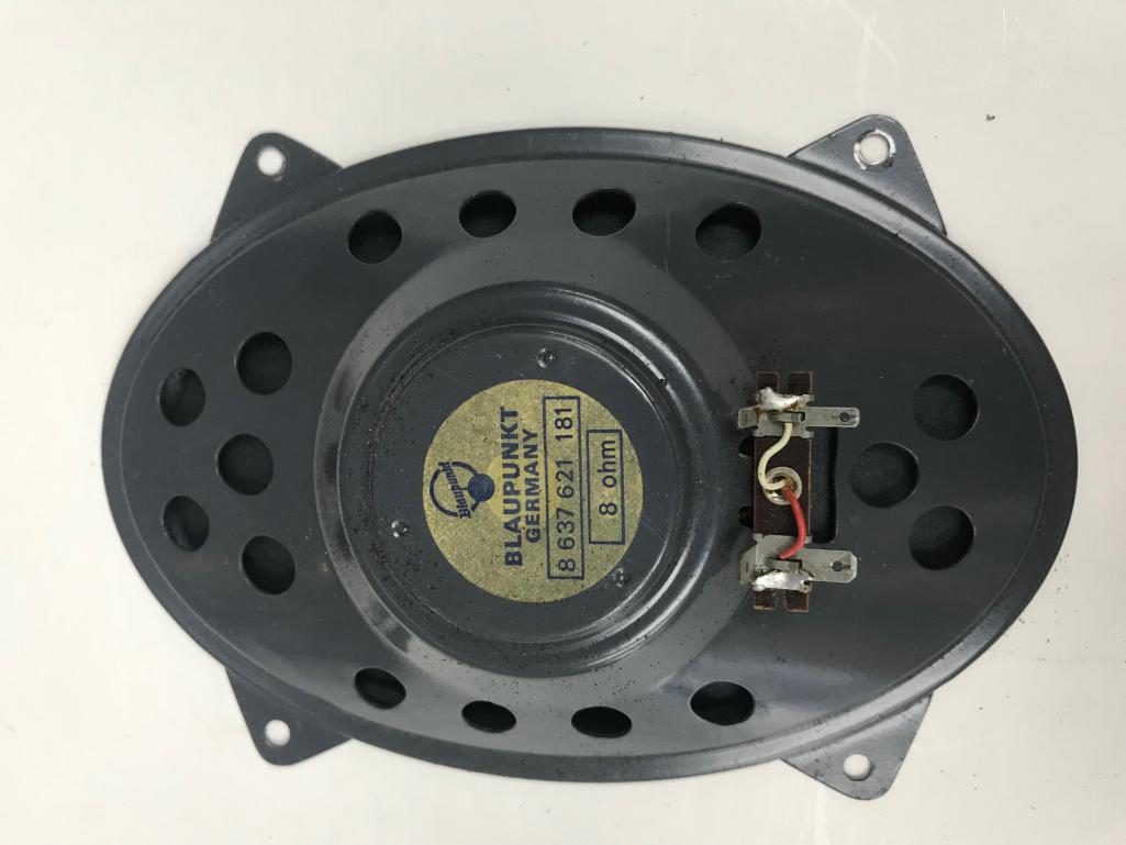

there is still some new old stock out there for the blaupunkt speakers with the internal magnet:
