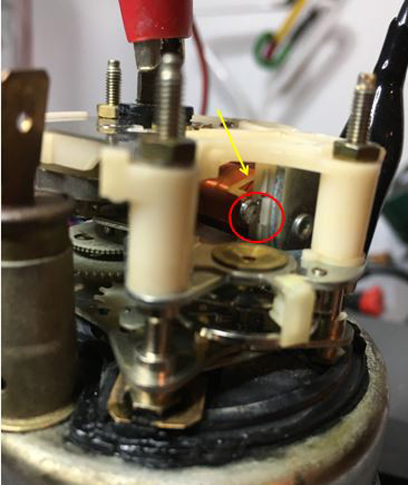

I suppose you could add in one of those miniature fuses but it wouldn't serve much of a purpose.
What maybe isn't clear is that the internal "fuse" is the dab of low melting temp solder itself. Tthere are basically two "eyelet" loops.
One is fixed firm to the solenoid. The other is "sprung" down from the rear of the clock. This is just a piece of spring steel that is copper plated.
The sprung eyelet portion is pulled down to the fixed one and then the solder is placed which holds the two pieces together.
If a short were to occur in the solenoid, or if the mechanism were to jam preventing the winding contacts from being opened after only momentary contact, the thin spring steel will heat up, melting the low temp solder and the "fuse" then springs open breaking the current flow.
Remember, the purpose of the fuse isn't to protect the clock, rather, it protects the car's wiring.
So if the internal fuse is already opened from whatever cause, the root cause needs to be fixed. In my case this was to flush the sticky internals with alcohol to free up the stuck rewind mechanism and the mainspring gearing.
In theory, if you either put the mini-fuse inside (maybe between the eyelets) or outside the clock, it wouldn't really matter. Just protect your vehicle wiring.
I looked at the spec's on the mini-fuses you linked to. Those take quite a while (up to minutes) to blow depending on size of the fuse. It would take some careful sizing to get the right fuse vs. time to melt it. I'd prefer to just go with a simple external 1/2 fast blow automotive glass fuse since I know this works to run the clock but would also be low enough amperage to blow well before melting the clock power feed if a short were to occur.
Attached is a closer view. Sorry for limited resolution. I can send high res photo via e-mail if that would help.
Yellow arrow points to the "sprung" eyelet. Red circle is around the two eyelets that are now soldered with the low temp solder.
