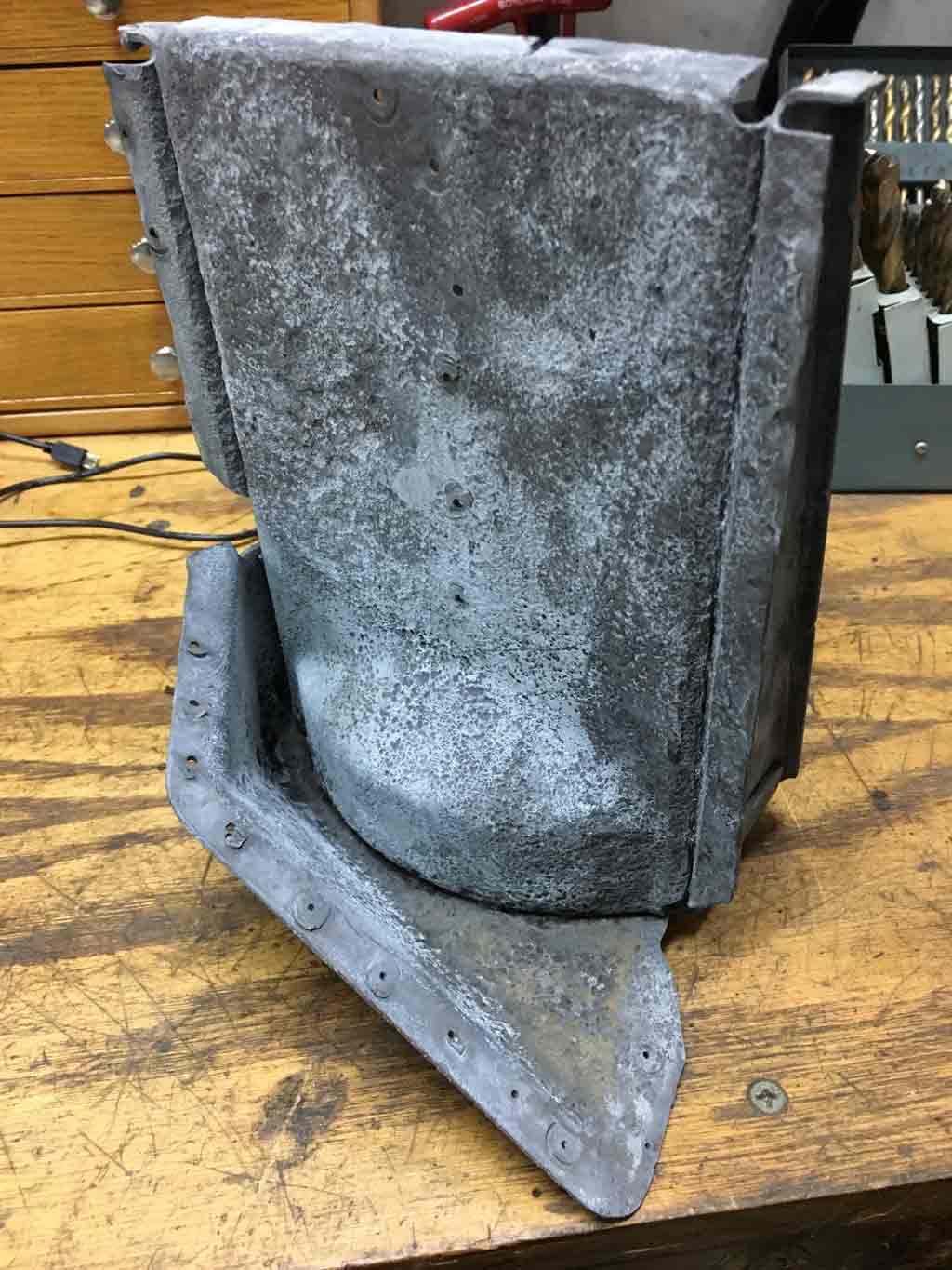

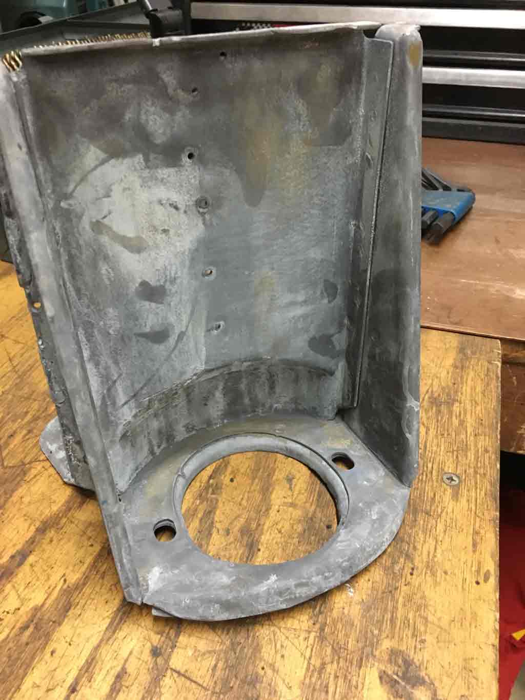

Didn't get much done that looks impressive.
I did sandblast and prep the engine mount with POR Metal Prep.
Back side was pretty heavily pitted. It cleaned up but there is some metal loss.
Does anyone have any tips on what to do with the heavily pitted material?
Front slide looks good.
Seems like if I've gone to this trouble to do all this removal and salvage of the part, I'd rather know that there is enough material there for sure.
I think there is still enough base metal there to weld to but would feel better if I maybe doubled it from the front side?
