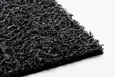

amfab   what about 3M Nomad mat material This Stuff:   Jan 8 2019, 03:36 PM
