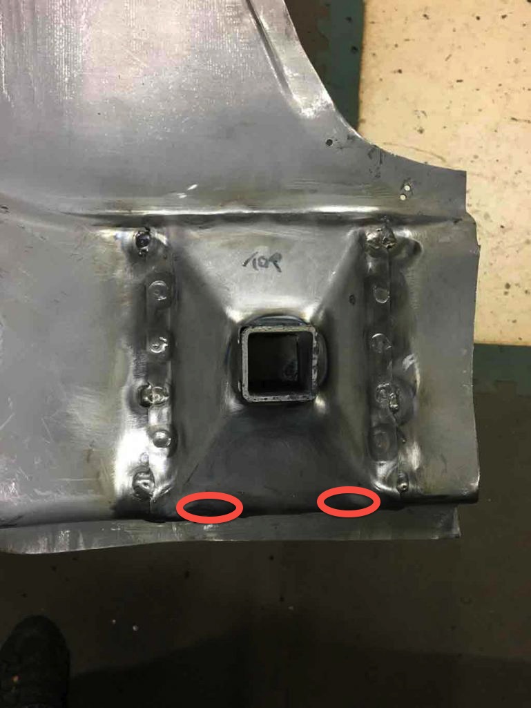

I drill two holes in the bottom of each jack point support to allow for better drainage.
Then a small dose of Eastwood's Internal Frame Coating can be sprayed in there to keep the inside surfaces protected.

euro911   I drill two holes in the bottom of each jack point...   Jan 19 2019, 04:44 PM
Superhawk996   I drill two holes in the bottom of each jack poin...   Jan 26 2019, 10:11 AM
