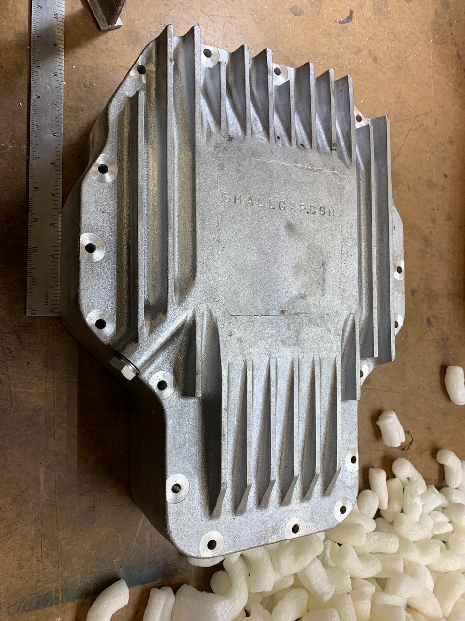

While in the shop I dug out my Smaller oil pan, had not even opened the box. Pan is interesting to say the least, cast aluminum, looks decent.

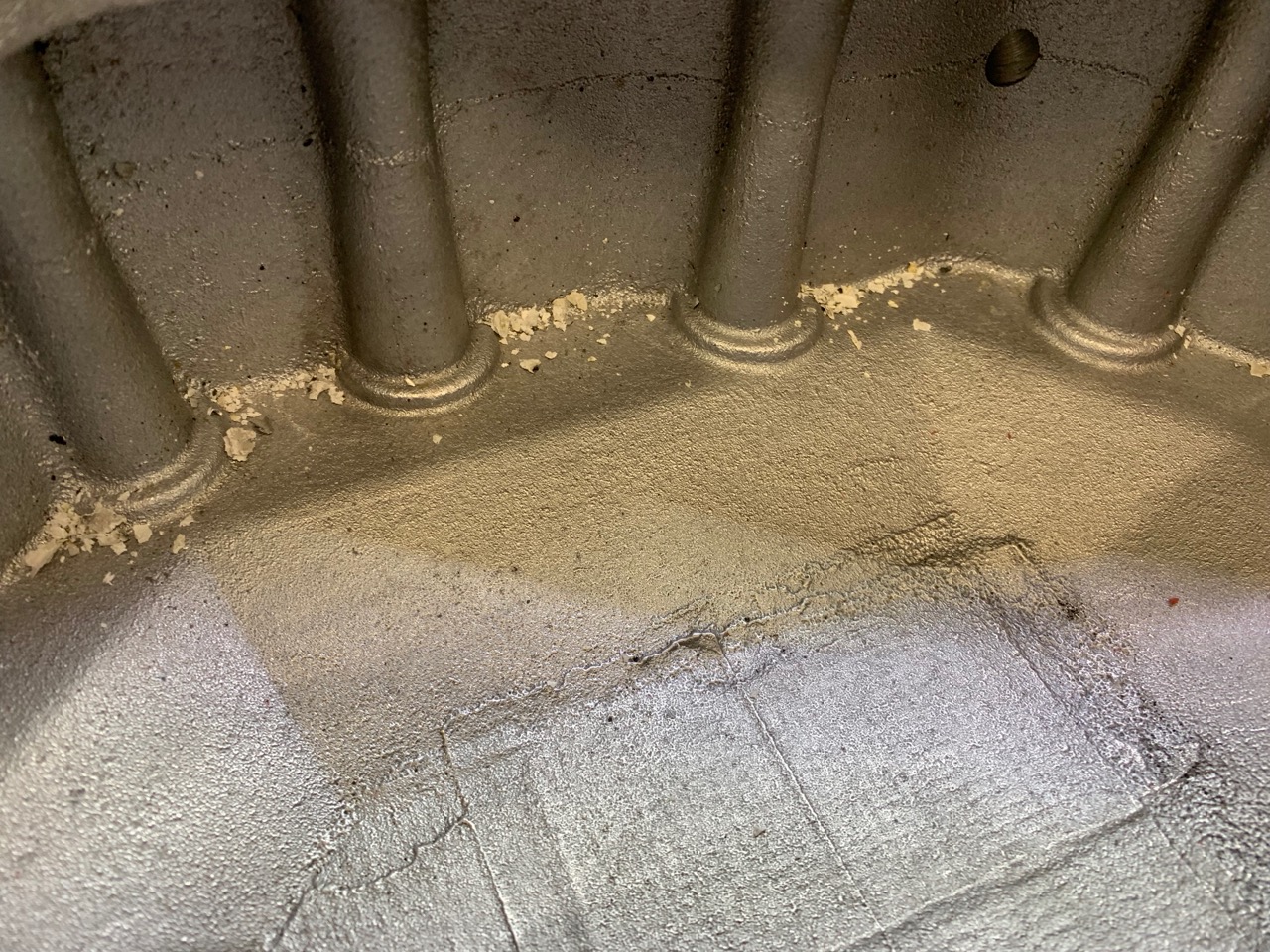

But what I found inside made none too happy.
What is that crap at the bottom of the pan? And who the hell fixes a mold with duct tap, and then uses it to create the sand cast? (IMG:style_emoticons/default/poke.gif)

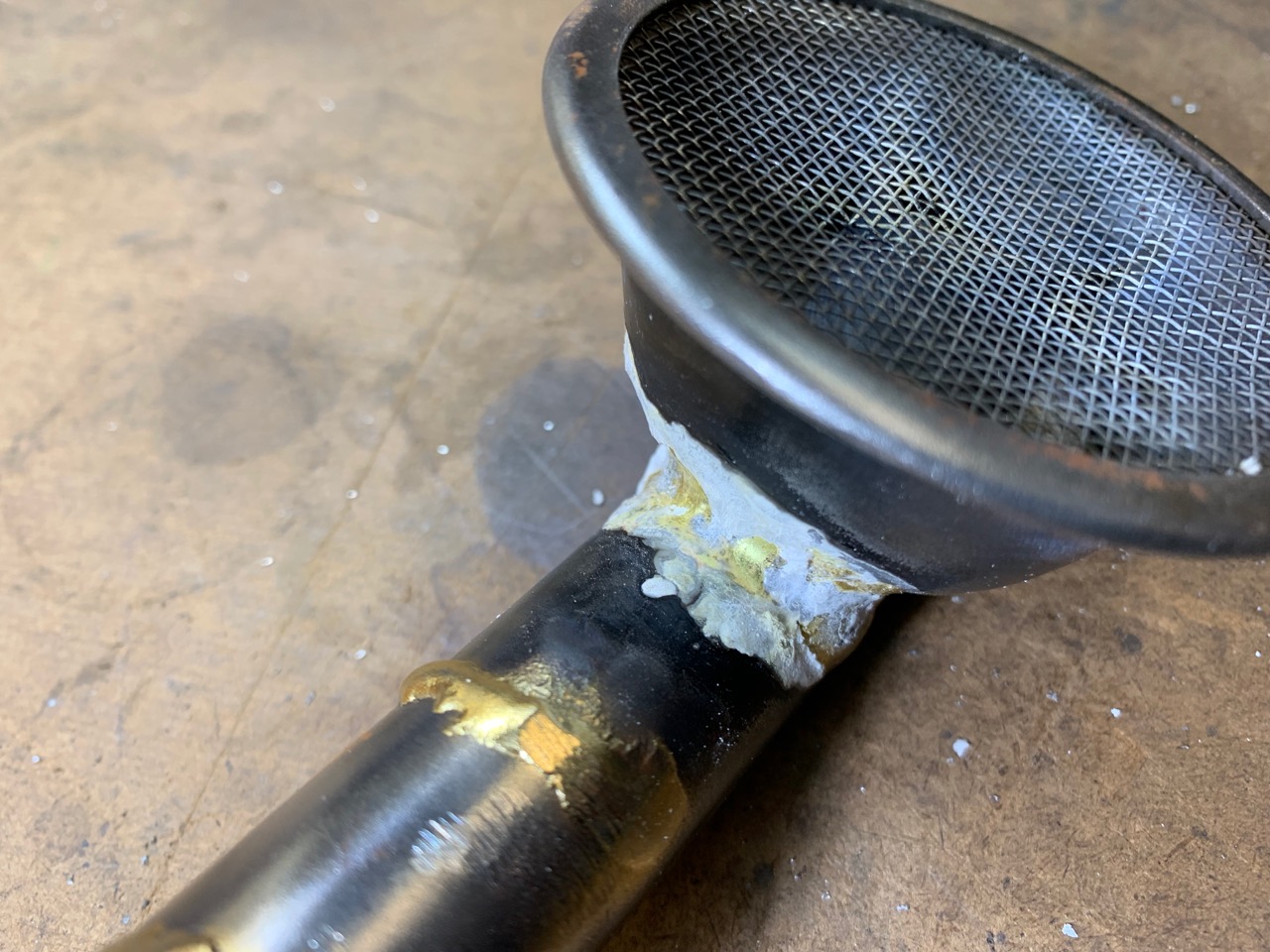

Well I found the crap at the bottom of the pan, I had small car modify the pickup tube. Now that I know what they did, I might have to redo this one. (IMG:style_emoticons/default/headbang.gif)
And well that explains the crap in the pan. (IMG:style_emoticons/default/WTF.gif)

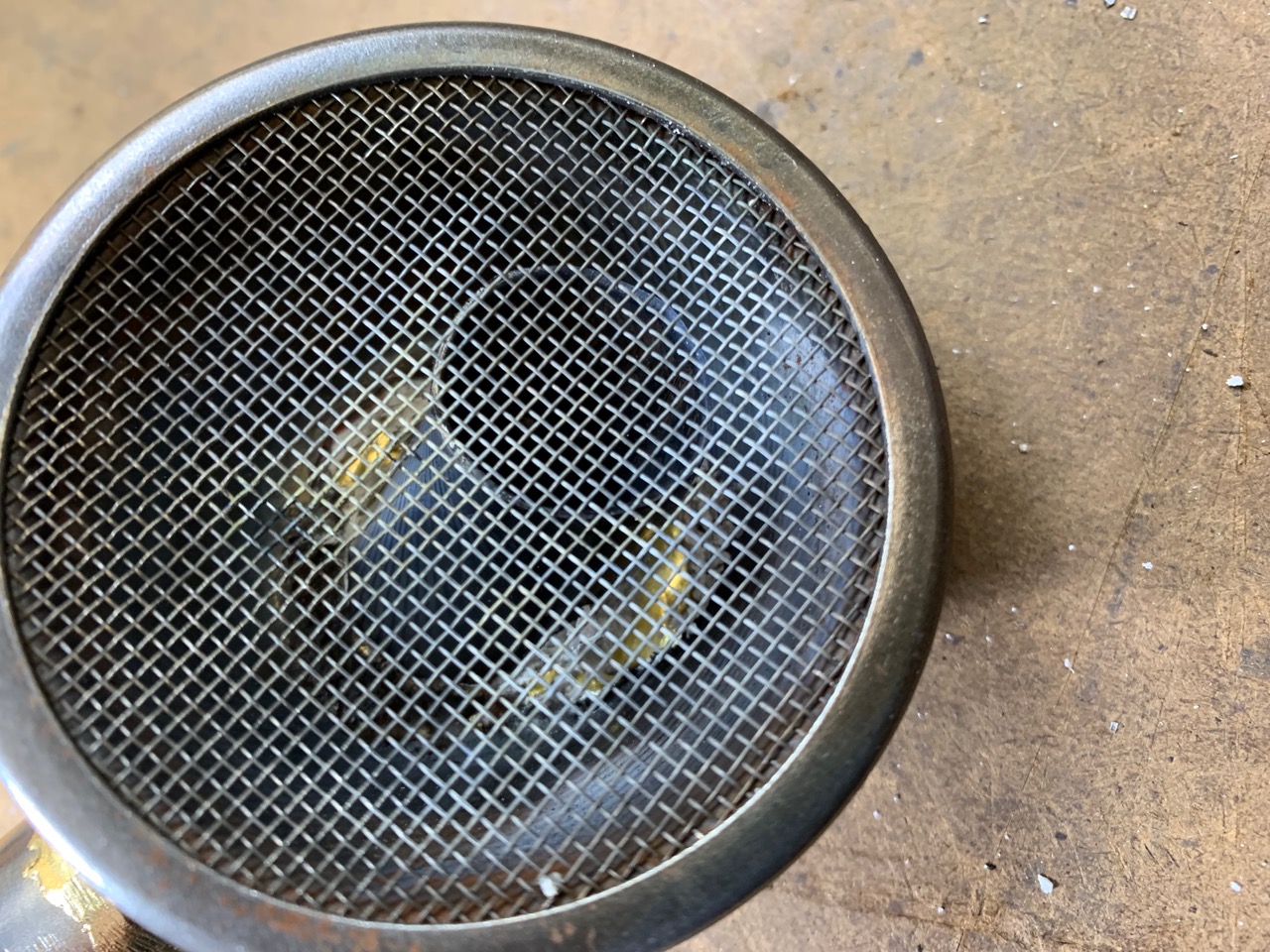

It is inside the pickup screen also.
Hard to see but that crap is in there.
So Scott I would recommend you modify the pickup your self if your using this pan. I will keep this one out of the car and most likely use the one from my my running engine to build another one.
And to answer the question.

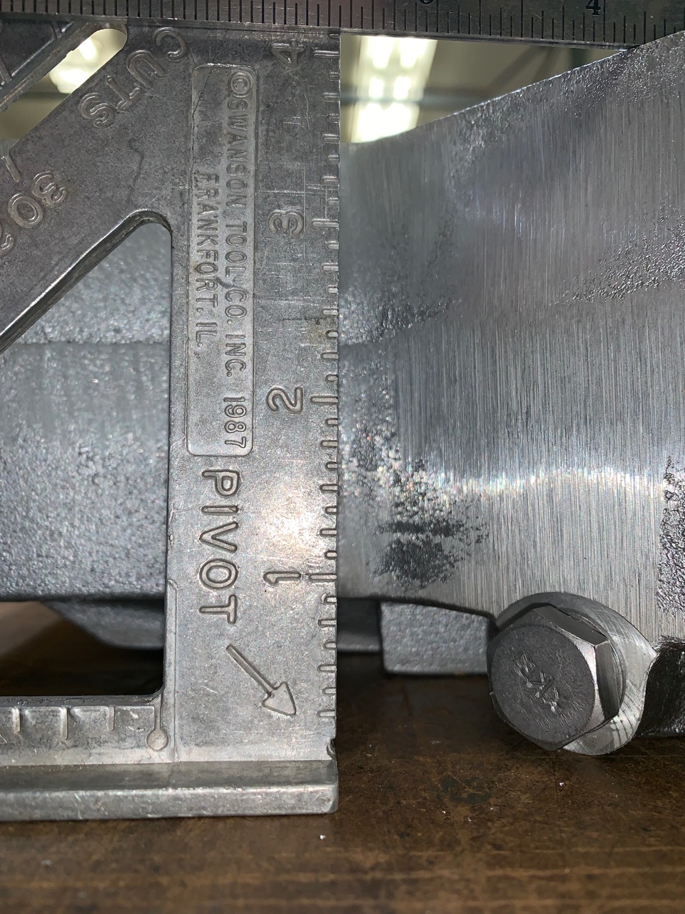

4 1/8" from flange to table. You can figure out clearances from there. Being cast AL, I might drop an Aluminum Skid plate under it.Just to make sure I don't lose it some how. VW has cast AL pans on some of the Jettas, and well the wife cracked one hitting a man hole cover, right place right time sort of thing.
Idk why the pickup tube was done like that. Ive met the welder they get to modify all of those pickups (he does hundreds at a time) and all of them are just tig welded. Ive never seen one he’s made, including the one i got personally, thats looked like that (IMG:style_emoticons/default/blink.gif) you must’ve really gotten the oddest of ones out. I also didnt junk in my pan when i got it, though I don’t remember the duct tape in the casting or not.
