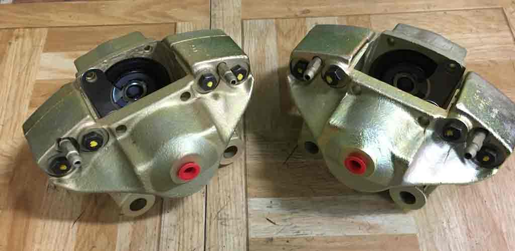

Also picked up some front brake calibers from PMB to address my old ones that were sticking during my October "test" drive.
This is always a tough call given that I'm a pretty cheap bastard. Rebuild myself and save money but takes time OR pay someone else $$ and save time. Right now my time is in shorter supply.
I've rebuilt 914 calipers before and quite frankly it is a bit of a pain. And even when I've done it they still end up looking ratty even though they are perfectly functional.
I've got to say that the work PMB does is top notch. Automotive jewelry (IMG:style_emoticons/default/crest.gif) !
