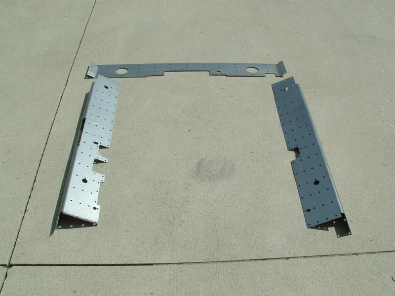

good amount of rust but clearly you are up for the challenge.
might want to consider a long reinforcement kit on top of all the repair you are gonna do? https://www.pelicanparts.com/More_Info/INLO...z0aAmwgEALw_wcB Attached image(s)
