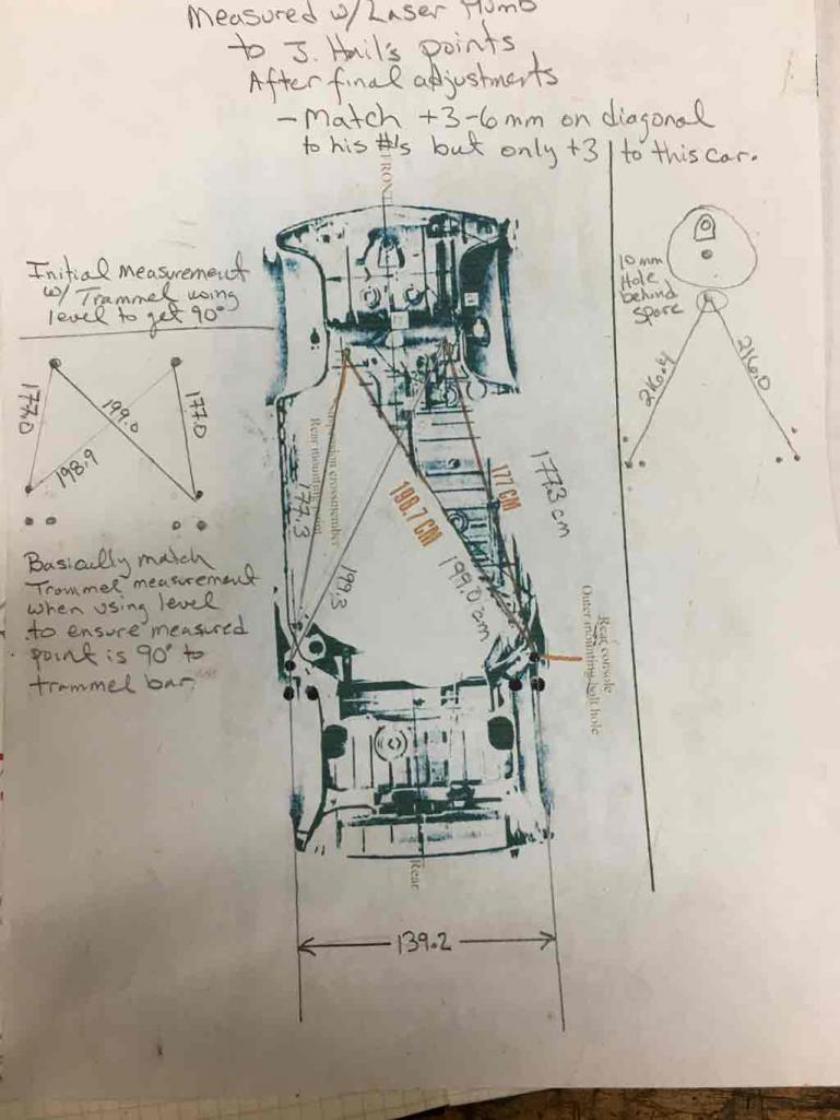

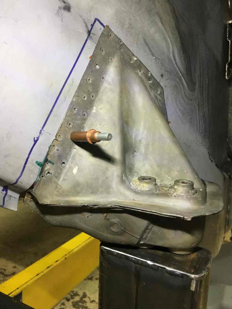

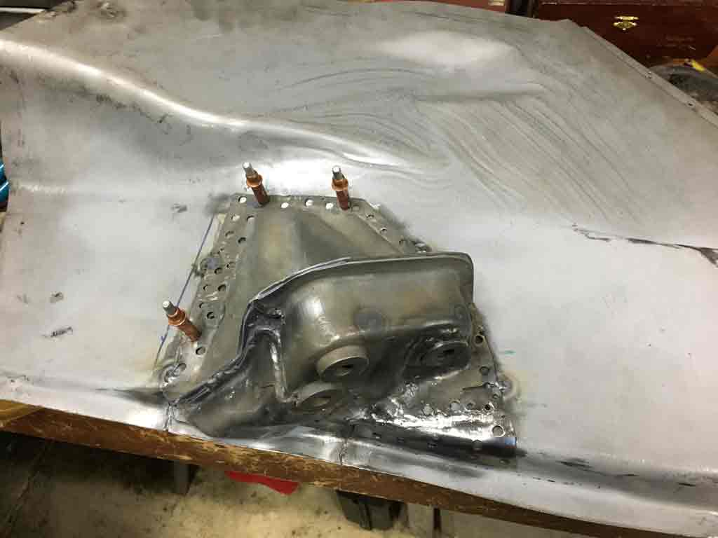

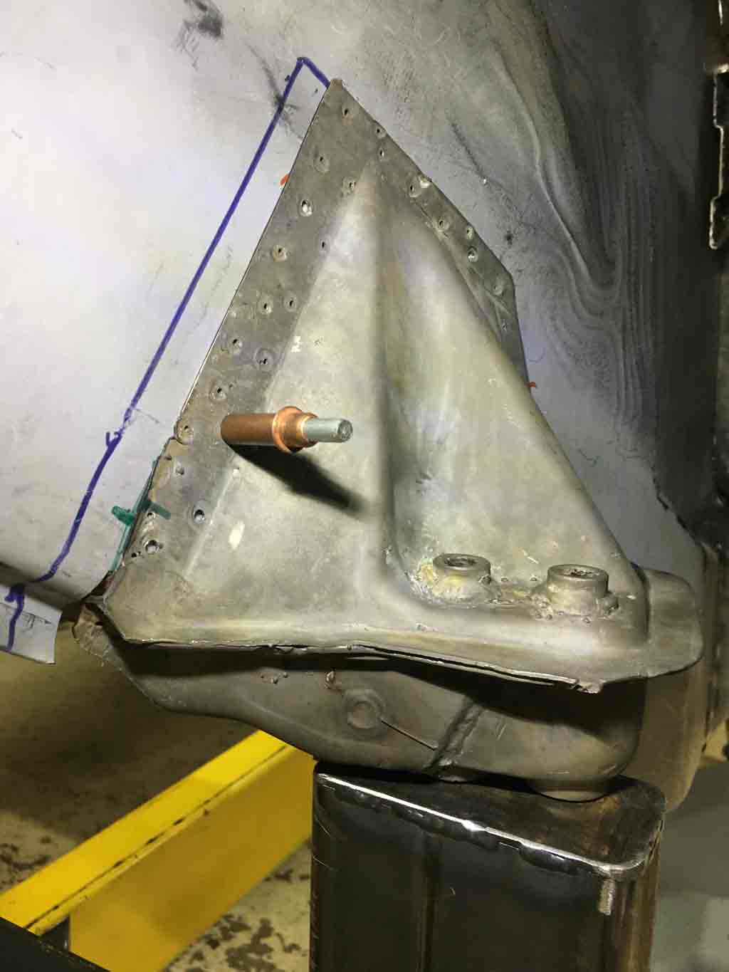

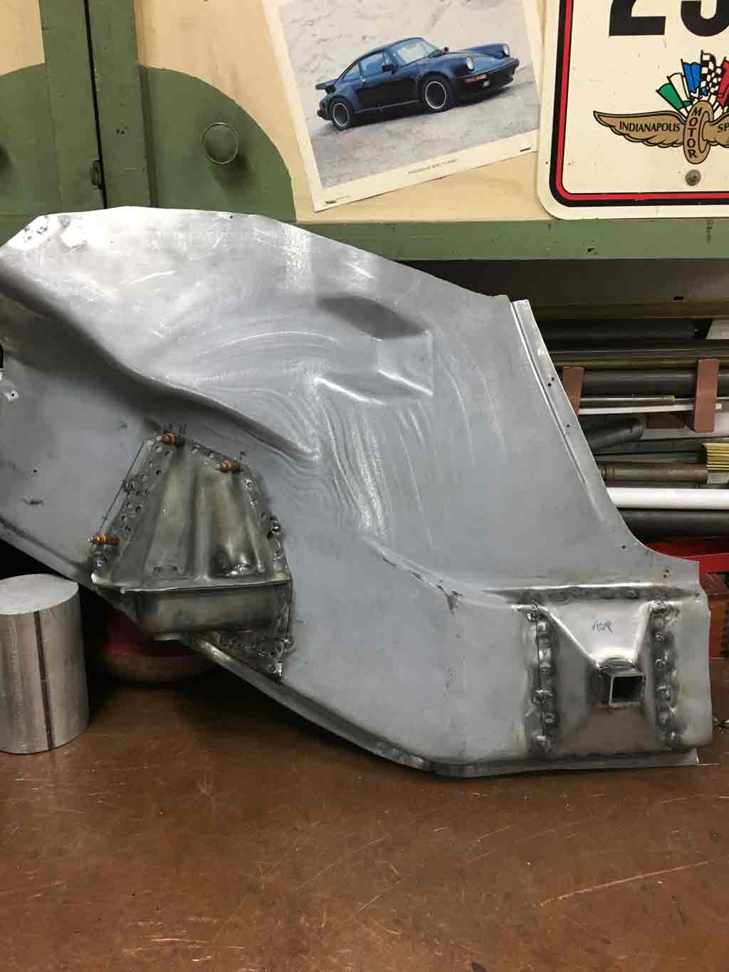

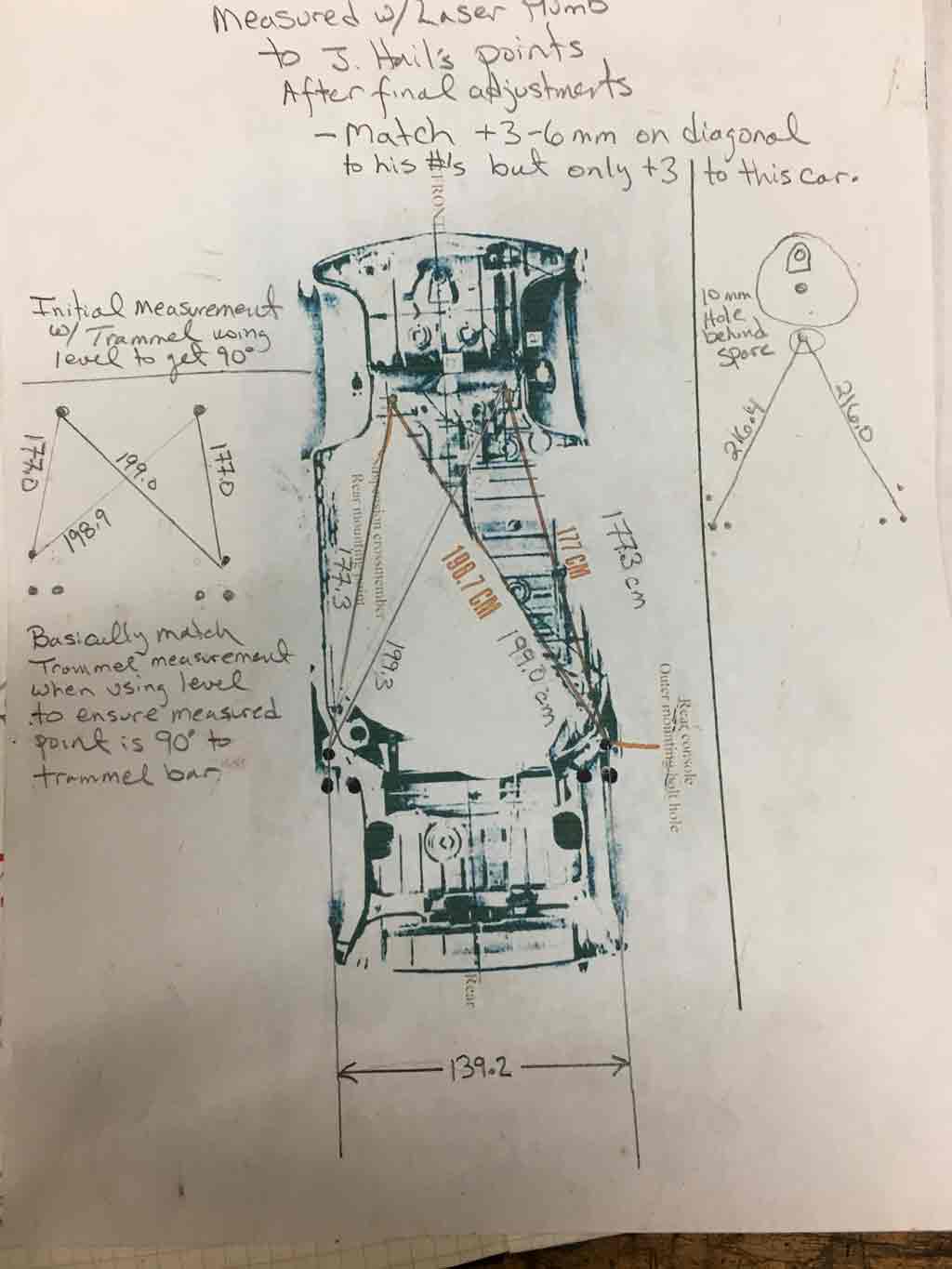

Update on the trailing arm mount madness:
Laser plumb bob only confirmed the trammel measurements and that although X/Y position is reasonable, Z is off.
My solution was to notch the wheelhouse frame rail section. The radius of the stamping doesn't match my OEM part exactly and is pushing the mount low in Z.
By notching the rail I was able to tighten up the radius to match my trailing arm mount and move it up to proper Z location while maintaining X and Y dimensions.
Once the part was correctly positioned I used a body hammer and dolly to return the flange to mate with the part and then welded the flange back where it belongs. In the photos below, I still need to add a doubler reinforcement on the inside to replace the material I removed.
put the panel back into the vehicle and reconfirmed my measurements. All in all I'm pretty happy. When everything is metal finished and painted, the modification won't be evident and will be as structurally sound as the unmodified panel.
I'm still off on the diagonal by a 3mm (~ 1/8") but that can be adjusted when I instill the inner section of the frame that resides in the engine bay.
Looking forward to moving on!! (IMG:style_emoticons/default/biggrin.gif) I know fitting the inner frame rail is going to be time consuming based on the rough fit work I had to do already.
Once that is done, I hope to make more rapid progress. February is here and it takes forever to heat up the garage in order to accomplish any work! (IMG:style_emoticons/default/mad.gif)
Still have lots to do!
