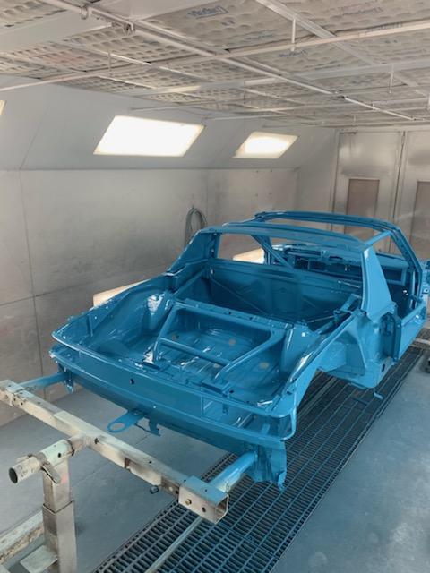

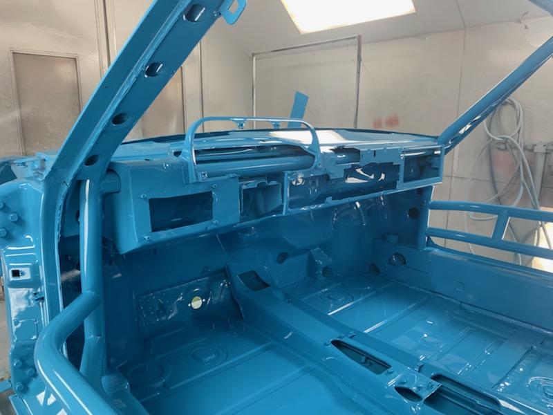

I've been a bit remiss in giving updates...thought part of that was the back and forth with paint vs. powder coat then scheduling the paint, etc.
So it went to paint last week.
We decided to change the color a little...make it a bit deeper and richer. So we went to 1975 Laguna Blue. We REALLY like how it came out! All the pictures make it look darker than it really is, but its really nice...still gonna do the dark blue section like before.
Here it is in the paint booth.
