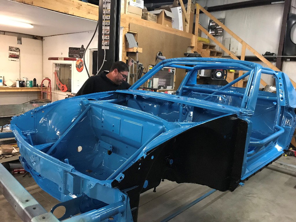

naro914   Update....so we decided not to powder coat. I’m ...   Jan 9 2019, 09:08 PM
Krieger   Bob, the car is going to look great. You made the...   Jan 10 2019, 01:08 AM
mepstein   The chassis I've seen powdercoated have been d...   Jan 10 2019, 06:37 AM

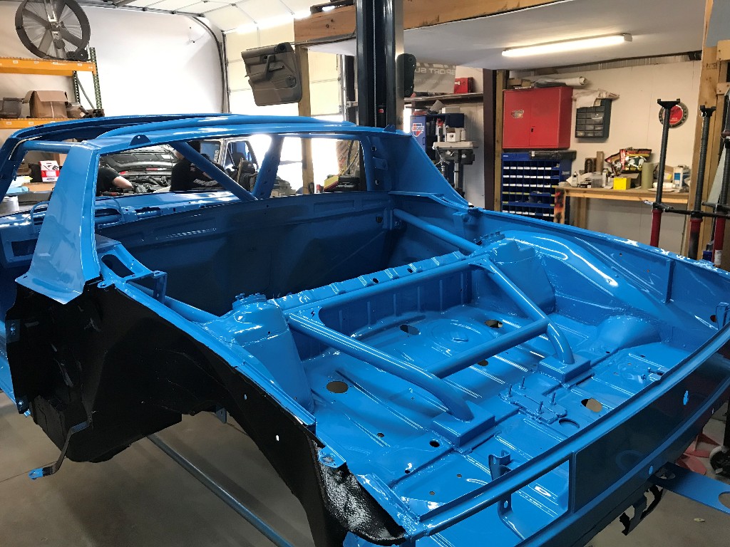

naro914   I've been a bit remiss in giving updates...tho...   Jan 30 2019, 04:16 PM
naro914   Then we decided to put bedliner type undercoating ...   Jan 30 2019, 04:20 PM
naro914   So yesterday we put the suspension on to make it a...   Jan 30 2019, 04:24 PM
naro914   and today he came home! Now comes the rea...   Jan 30 2019, 04:28 PM

raynekat   No offense to your old blue....but the new color i...   Jan 30 2019, 07:51 PM
naro914   No offense to your old blue....but the new color ...   Jan 30 2019, 08:49 PM
