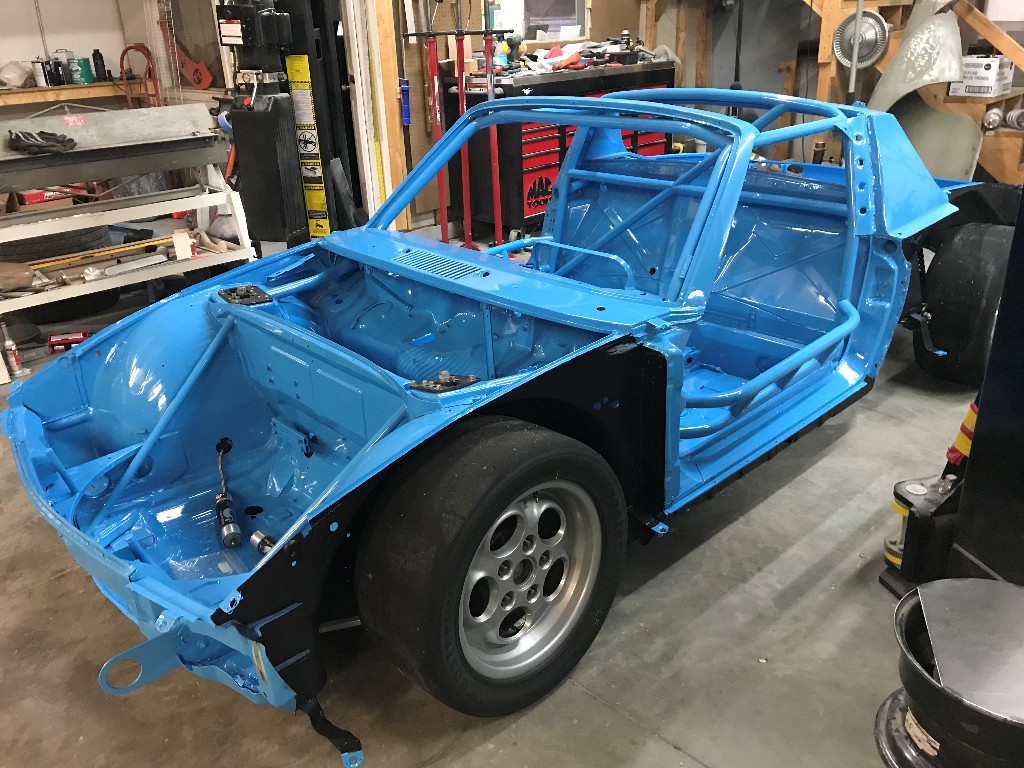

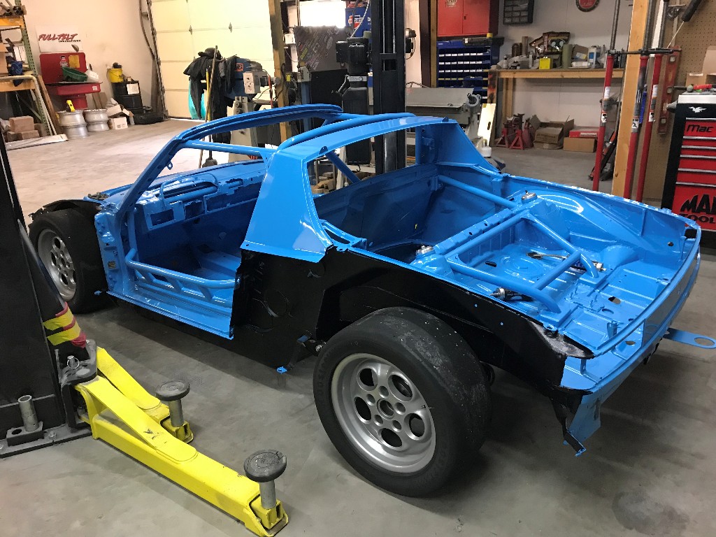

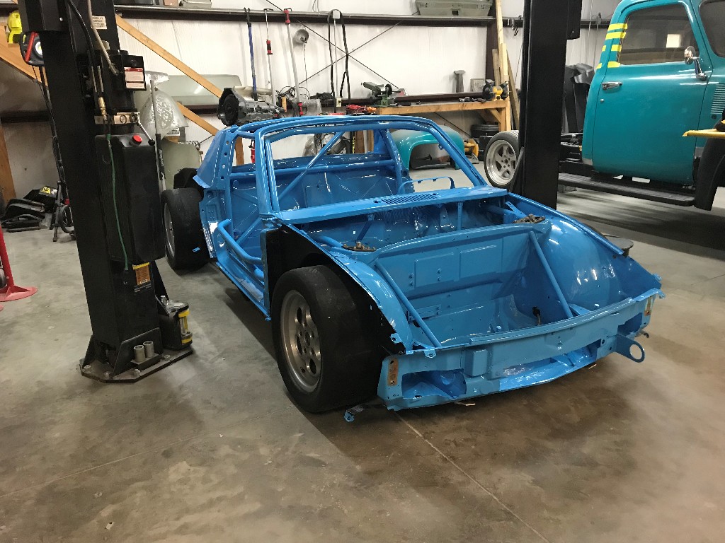

naro914   I've been a bit remiss in giving updates...tho...   Jan 30 2019, 04:16 PM
naro914   Then we decided to put bedliner type undercoating ...   Jan 30 2019, 04:20 PM
naro914   So yesterday we put the suspension on to make it a...   Jan 30 2019, 04:24 PM
naro914   and today he came home! Now comes the rea...   Jan 30 2019, 04:28 PM
