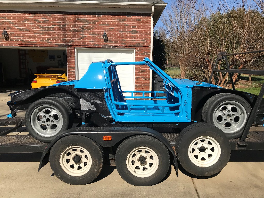

We decided that this winter, our 914 race car "Papa Smurf" needed some love. The engine that Dawe's Motorsport built has been flawless for 2 years now, but it's time for a refresh. The 915 transmission is so poorly geared and with no limited slip that it has been a huge hindrance to race with, so that's getting redone.
So while everything is out, I figured it was a good time to fix all the damaged fiberglass body panels, fix the newly found crack in the chassis, strengthen and reinforce everything, tie suspension points to the cage, re-route hoses and lines to be cleaner, redo some of the wiring, add lightness where I can, fix the roof (came flying off at Road Atlanta and cracked it), etc. etc. etc. Essentially tear it down to bare chassis. Then media blast the whole thing (fix any rust spots we might find), powder coat, paint or wrap what needs what, and reassemble...hopefully before our first track event in March!!
I will post pictures, progress, video, etc here if I can remember to. Honestly...I NEED to take detailed pictures and video so I can remember where everything goes!! Just might be delayed in posting.
So...engine/trans come out Friday and the fun begins...

and today he came home!
Now comes the real work!!
If you are on Facebook, I created an album of everything so far...and I'm going to chronicle the build there and highlight some of the products we sell that we are either putting back in or are new. I'll do my best to post updates here too.

naro914   Update....so we decided not to powder coat. I’m ...   Jan 9 2019, 09:08 PM
Krieger   Bob, the car is going to look great. You made the...   Jan 10 2019, 01:08 AM
mepstein   The chassis I've seen powdercoated have been d...   Jan 10 2019, 06:37 AM
naro914   I've been a bit remiss in giving updates...tho...   Jan 30 2019, 04:16 PM
naro914   Then we decided to put bedliner type undercoating ...   Jan 30 2019, 04:20 PM
naro914   So yesterday we put the suspension on to make it a...   Jan 30 2019, 04:24 PM
naro914   and today he came home! Now comes the rea...   Jan 30 2019, 04:28 PM
