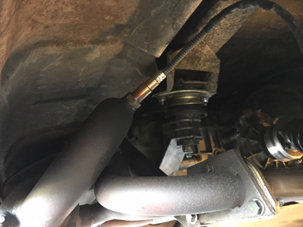

I don't have a triad, but here's a shot of mine installed right before the collector pipe enters the muffler. ![]() What brand AFR did you go with? I went with the PLX Bluetooth one so I could use my phone for monitoring readings rather than installing a gauge (wanted to keep the stock dash look). ![]() |
